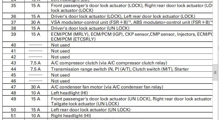

Sounds like a fuse is blown. The passenger doors and hatch run off #35 and 49 while the Driver sides use 38 and 50.

All fuses checked out (tested 35, 38, 49 & 50 - all 4 were good, pulled & swapped just to make sure there wasn't any oxidation on the contacts).
