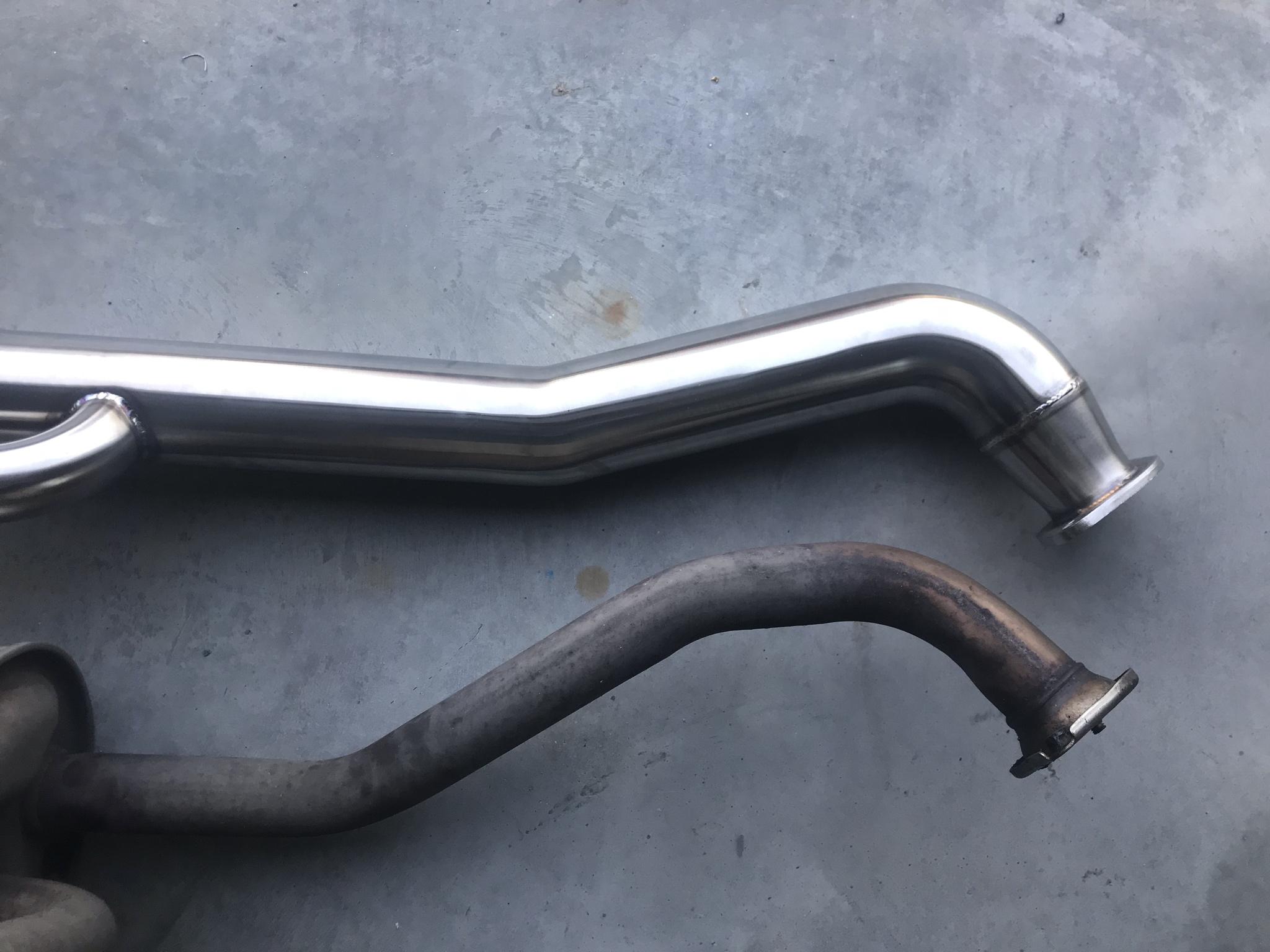

Alright, so I bought a Bisimoto Pulse Chamber exhaust that is made for a 2015+ Fit and wanted to see if it would fit my 09 Sport. In the process I have taken pictures and will continue to take pictures as I progress toward Bisi-Bliss! I do have a sound clip of a no muffler start up but will add one with the pulse chamber installed also.
Initial Fit
My initial test fit had 2 main problems:
1.) The pipe is so large that it hits the rear beam so the flange does not line up. I think I can fix this issue if I raise my car up (I don't want to do this) or if the pipe diameter was smaller. Even if raising the car allowed the flange to line up it would still have an issue fitting.

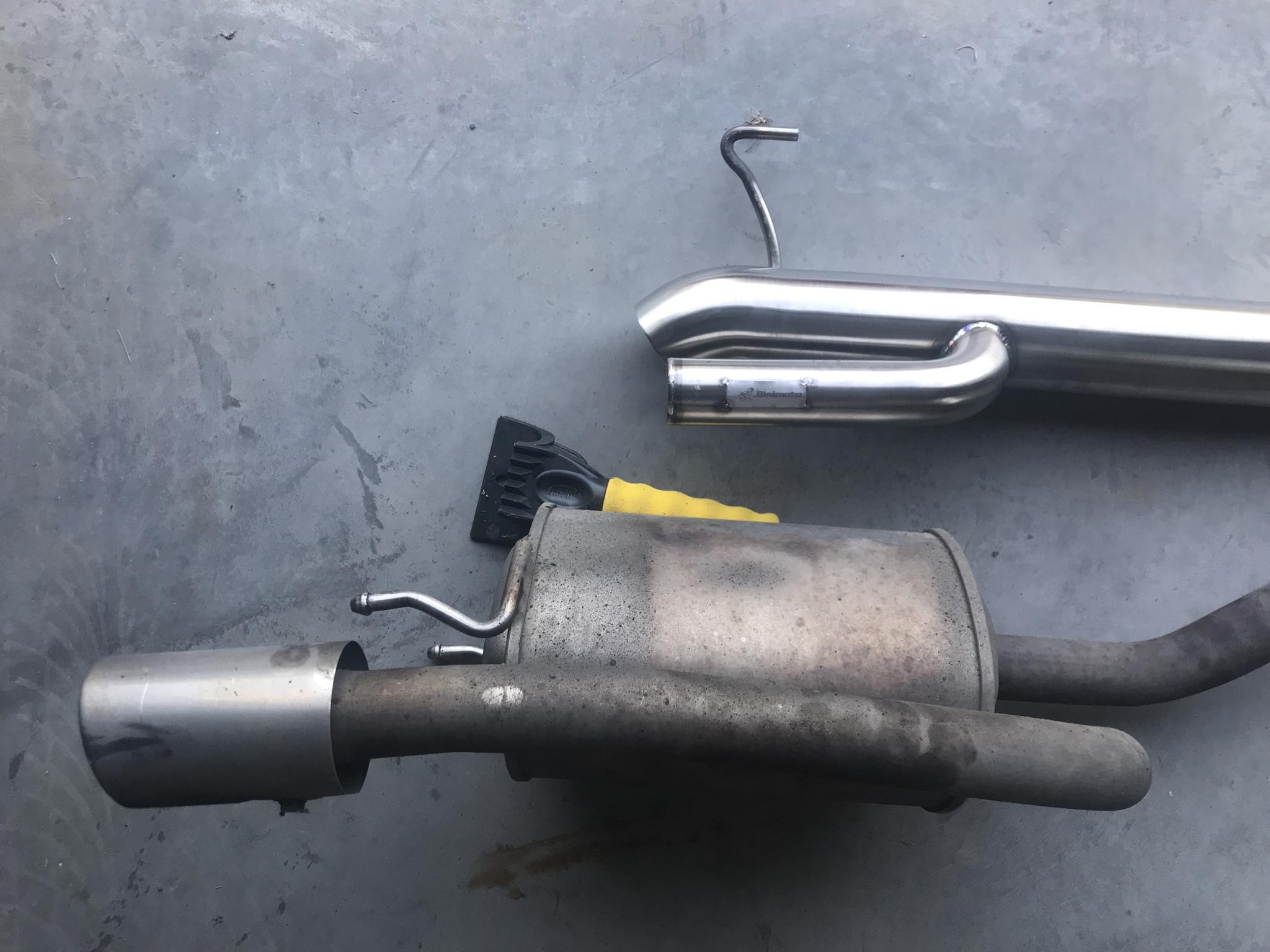

2.) The exhaust hanger is not in the correct spot. Due to the muffler sitting so far back, the hanger is not near the stock hanger locations. The hanger has already been modified to fit a 2019 Sport and needs to go back to its original orientation for a GE. This will make it closer to the original mounting area but it still needs to be extended. As you can see in the picture it is pretty close but needs to be extended.

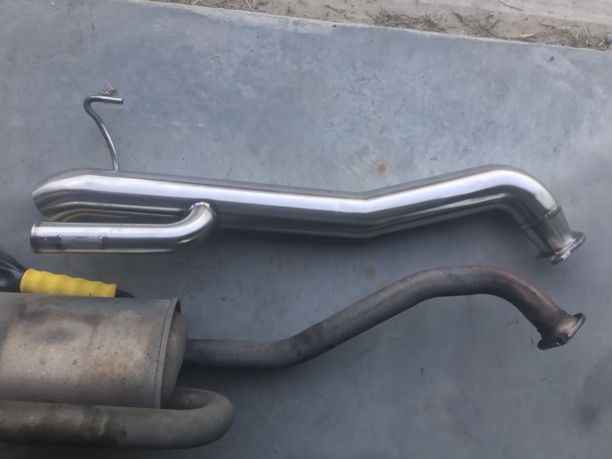

Here are more comparison pictures of a stock GE Sport muffler and the Bisimoto Muffler. As you can see the parts with the flange on them are very similar.
