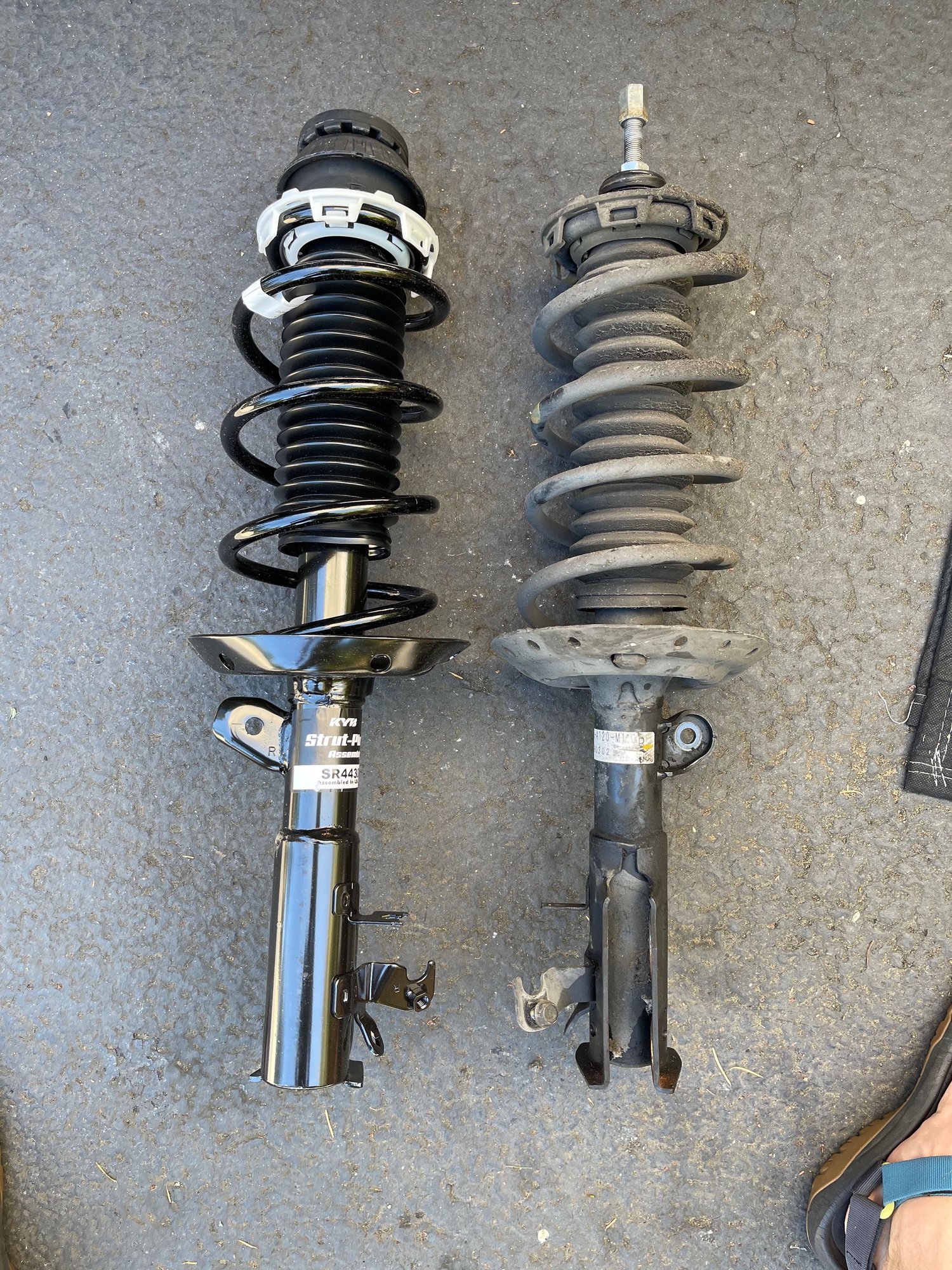

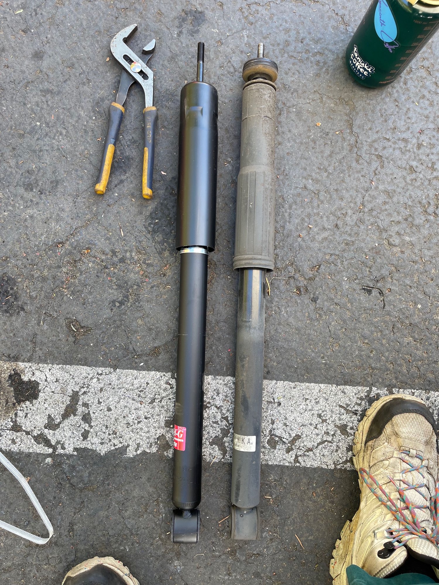

New Struts
Installed new KYB Strut-Plus up front and struts in the rear. I torqued them to factory specs, which are 33 fit-lbs for the top and 47 ft-lbs for the lower, which didn't feel tight enough to me. A few days later, and sure enough, they loosened themselves up. I then torqued them to 80 ft-lbs and they're great.

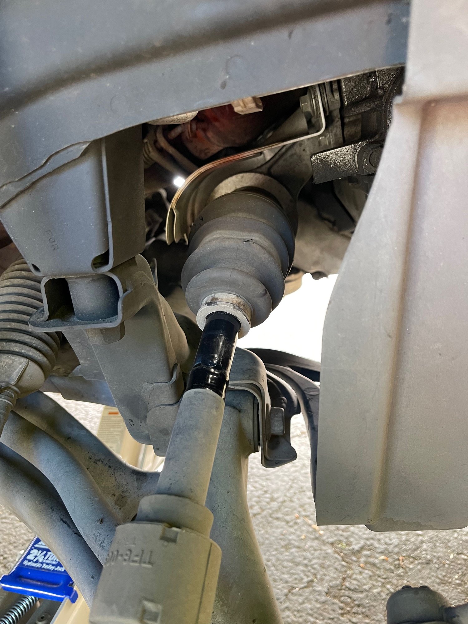

Had some trouble with the first front one I did. The CV axle kept popping out of the transaxle (I might have terminology wrong; I'm no true mechanic). I had to wait till my wife got home to have her jiggle the opposite side while I pushed in.
It would have taken only 5 hours to do all 4. Would be even shorter if Honda didn't make the driver side top mounting bolt so difficult to access. Hah!

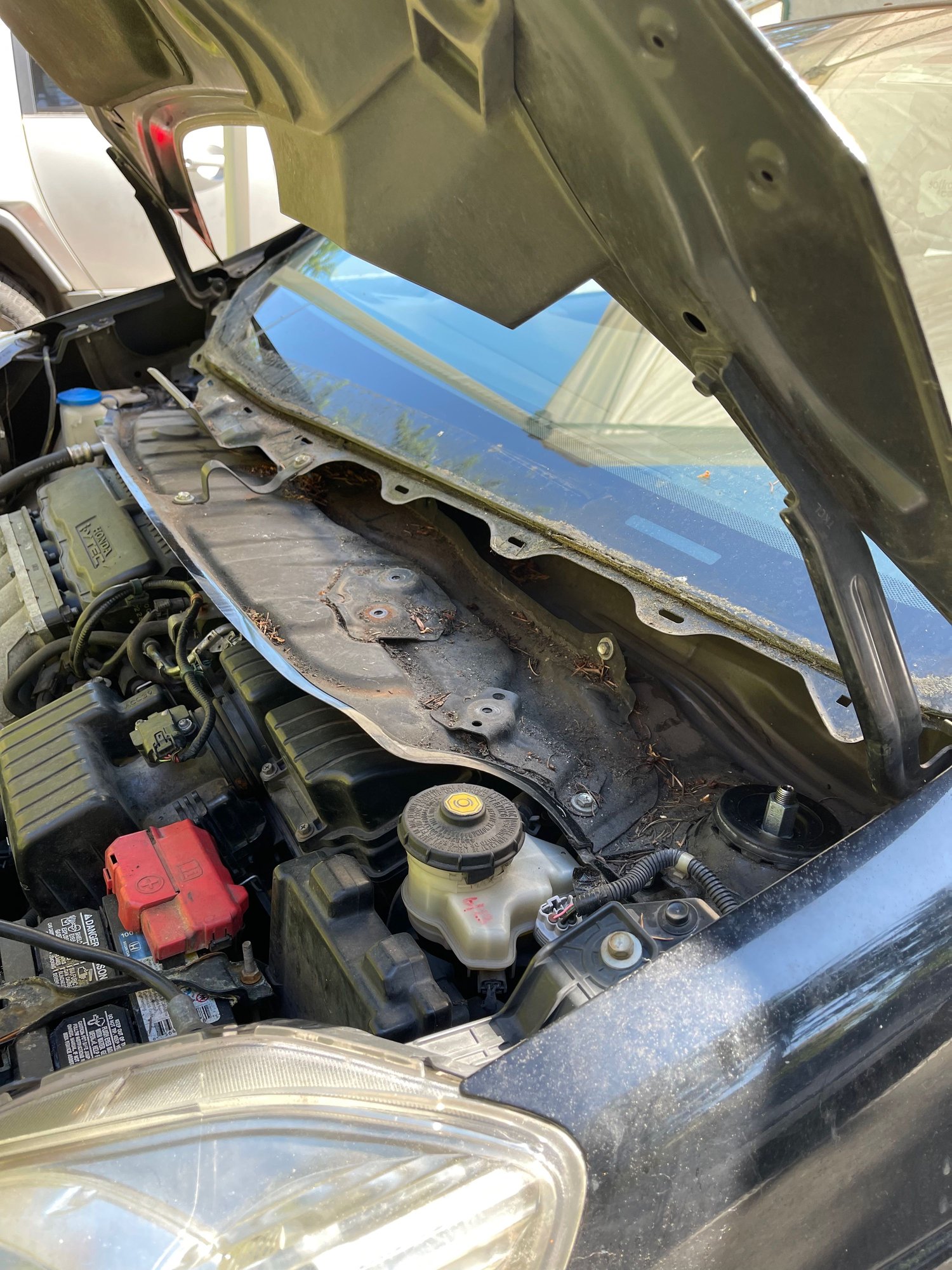

Have to remove the plastic cowling between the hood and windshield, as well as the wipe arms and wiper controller assembly (not sure what they're called).

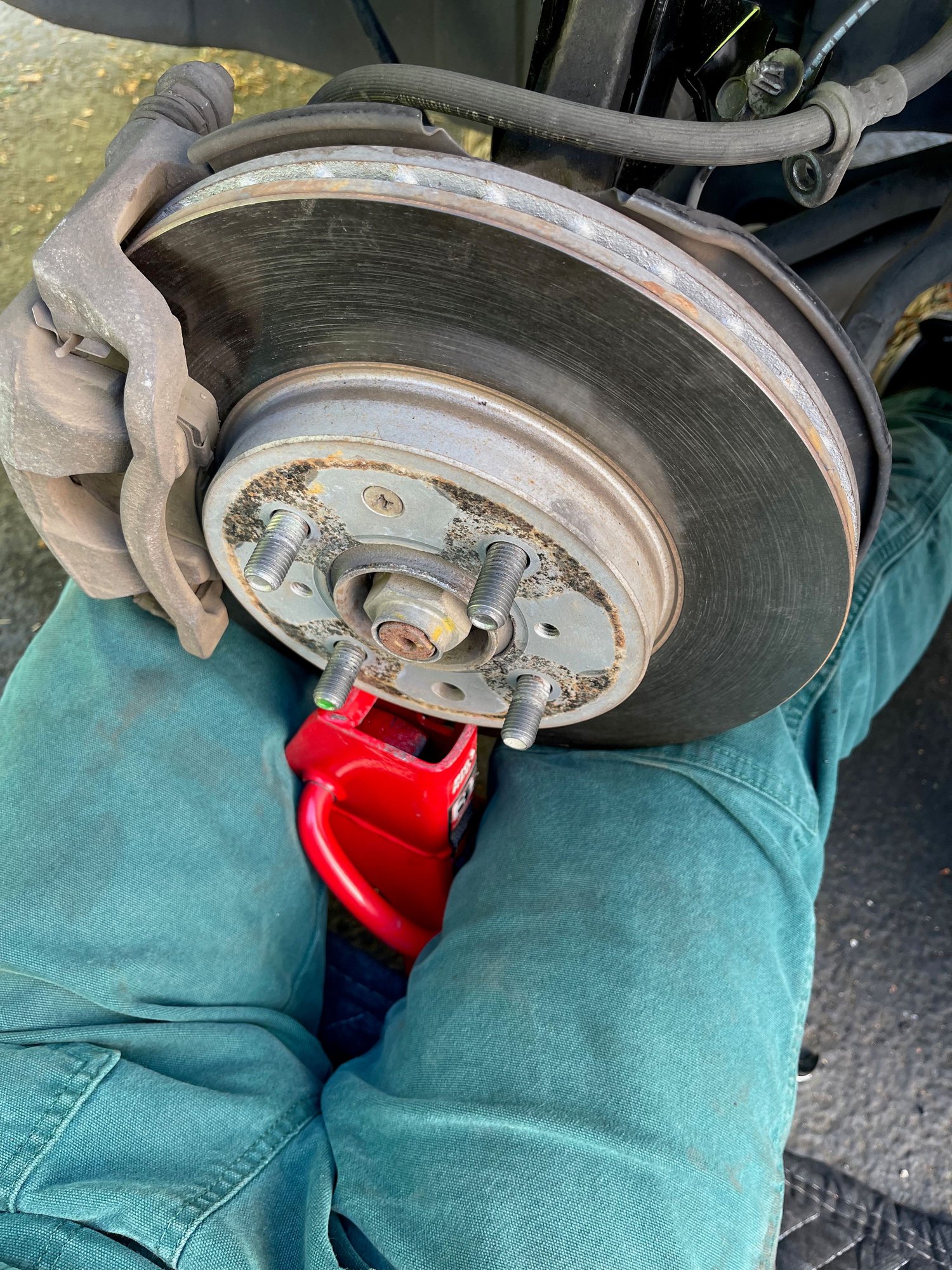

Hot tip: For lining up the knuckle and the strut, I like to use my knees to hold and guide the rotor.
The ride quality is so much better! This car has always had a slight knock in the front right side since we got it. Now it rides like a newer Fit!

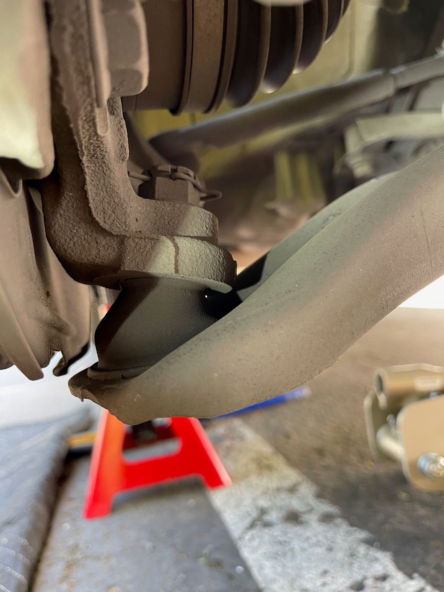

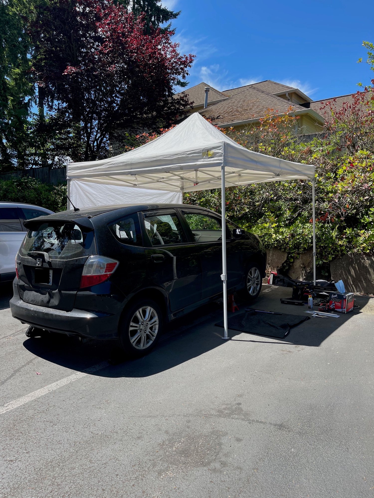

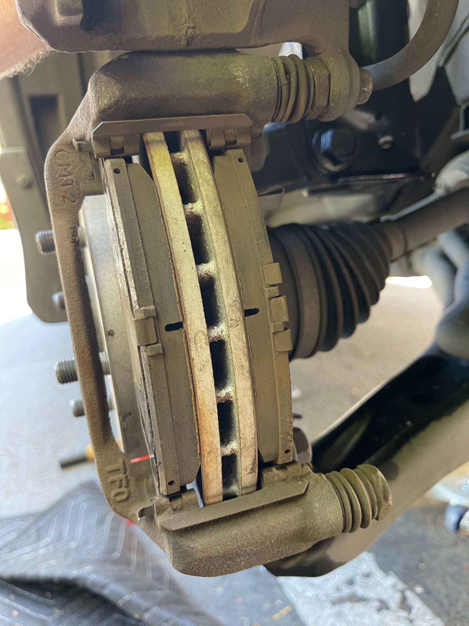

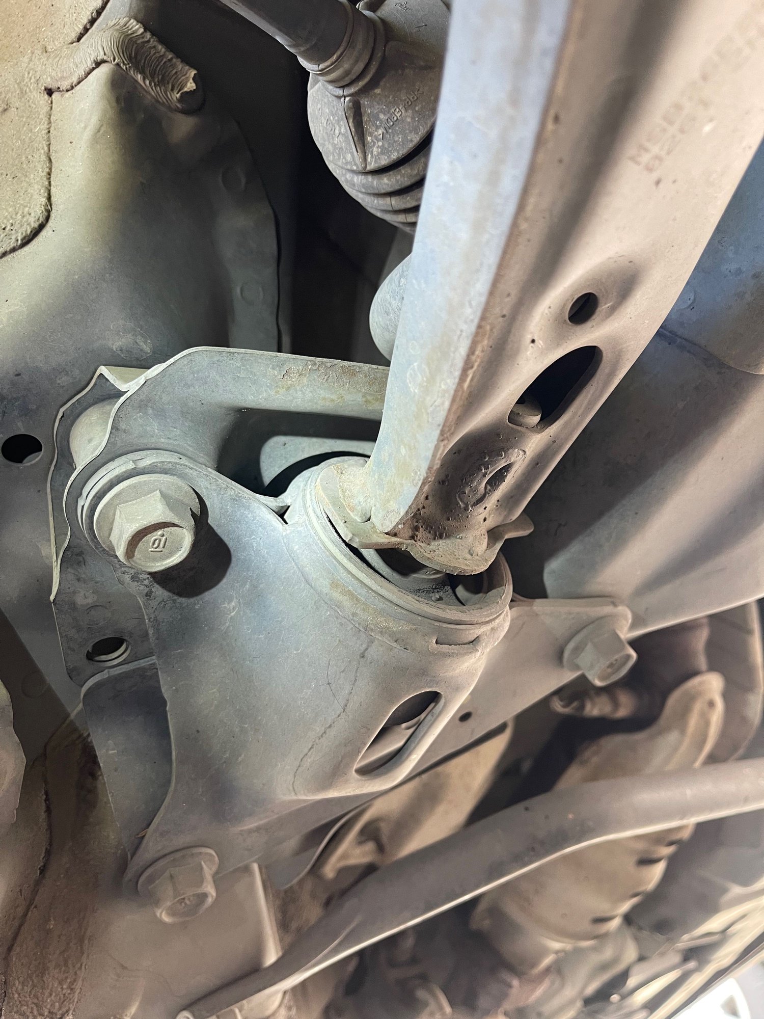

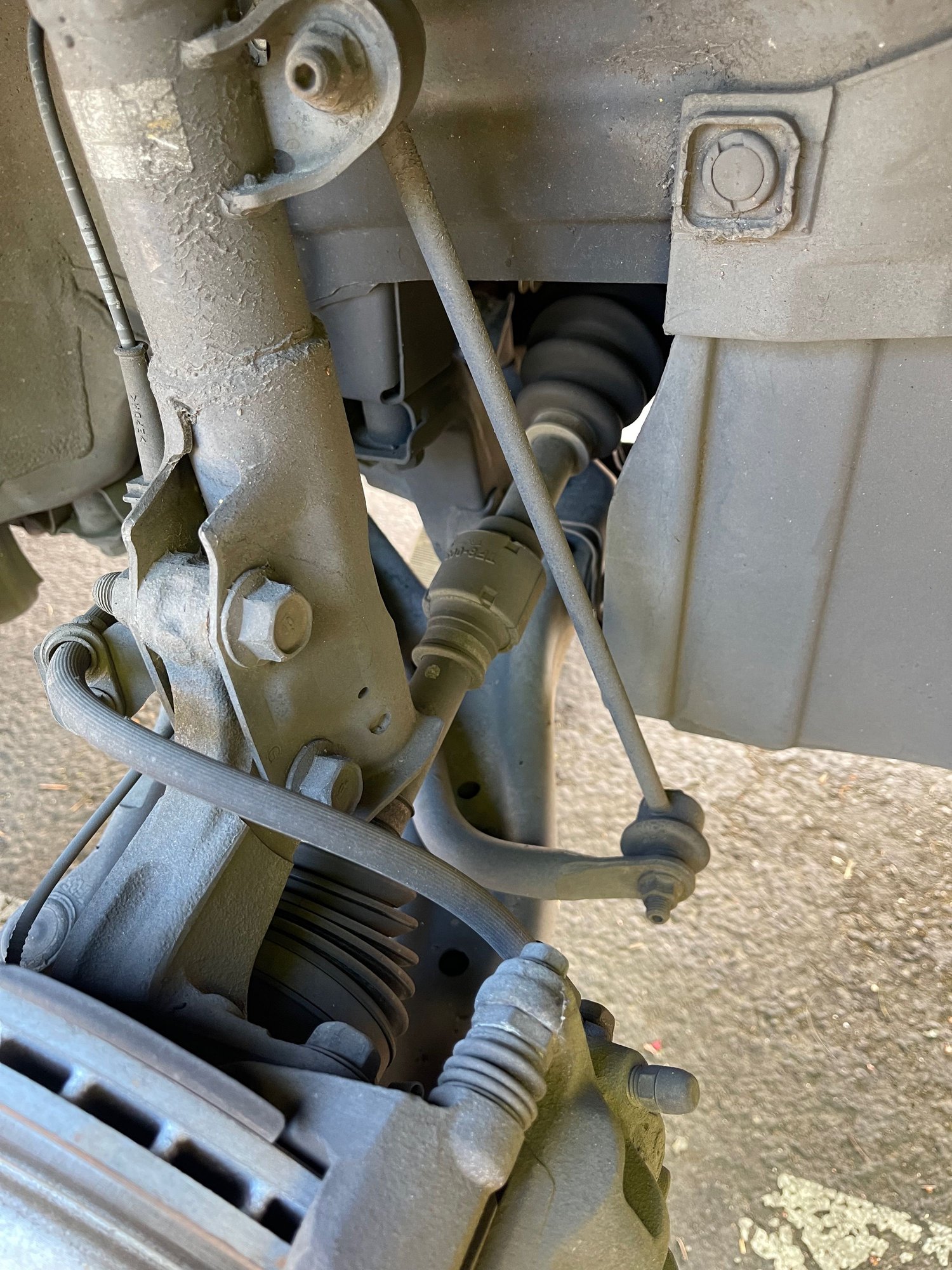

Lab results from most recent OCI attached, plus some fun photos. Had to get creative with creating more shade in my condo parking lot. Also grabbed some photos of the other rubber bits because I have all of the parts to replace them. But these look practically brand new! Also inspected the brakes because they were making a squealing noise a couple days prior, but there must have just been a rock up in there or something, because the rotors and pads look great.
