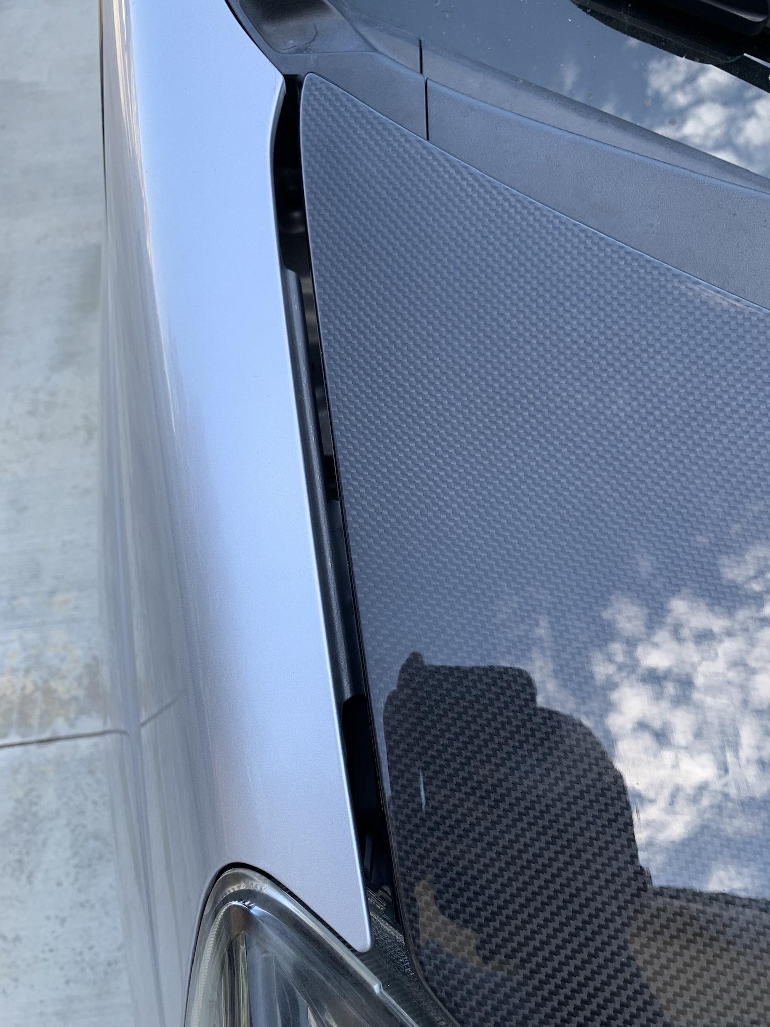

carbon hood gang 😎. I just got mine too and I couldn’t get the alignment right.
did you have to mess with the hood hinge bolts connected to the body of the fit?
I was only able to adjust the front bolt since the back was hard to reach and got this alignment on the passenger side 🤣
I have to try another day to get the right alignment..

the pic of yours on the what did you do to your ge today is what triggered me to get mine. hah. i couldnt decide on the vented or oem version, though i was leaning towards the oe version to reduce my motor cleanings. jdp had it in stock, so i told em send it.
i didnt loosen the bolts to the body. i tightened the nuts to the hood, but left them just loose enough to shift the hood around, but tight enough that they would hold long enough for me to gently open the hood again without them moving to tighten them. im assuming that same gap in your pic, on the drivers side is much less on your car. aligning the hood is basically a game of splitting differences. it will never be perfect though because the hood is not perfect.i have a larger gap alongside the passenger side cowl, except for that passenger rear corner in your pic, mine is very close to the cowl also. i dont know what the rest of the fitment looks like, but in the pic it seems like yours should go forward and towards the passenger side.

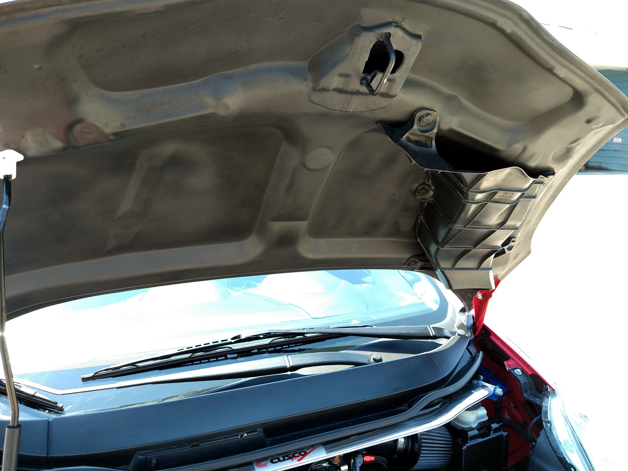

i was able to reattach the under hood scoop. i gently used the drill with a 5mm bit to make pilot holes, then stepped up to a 12mm but removed the battery from the drill and did it by hand . trying to power drill the holes will 100% leave you with a damaged hood, with the drill protruding through the top of the hood.

Hood scoop installed on carbon hood
