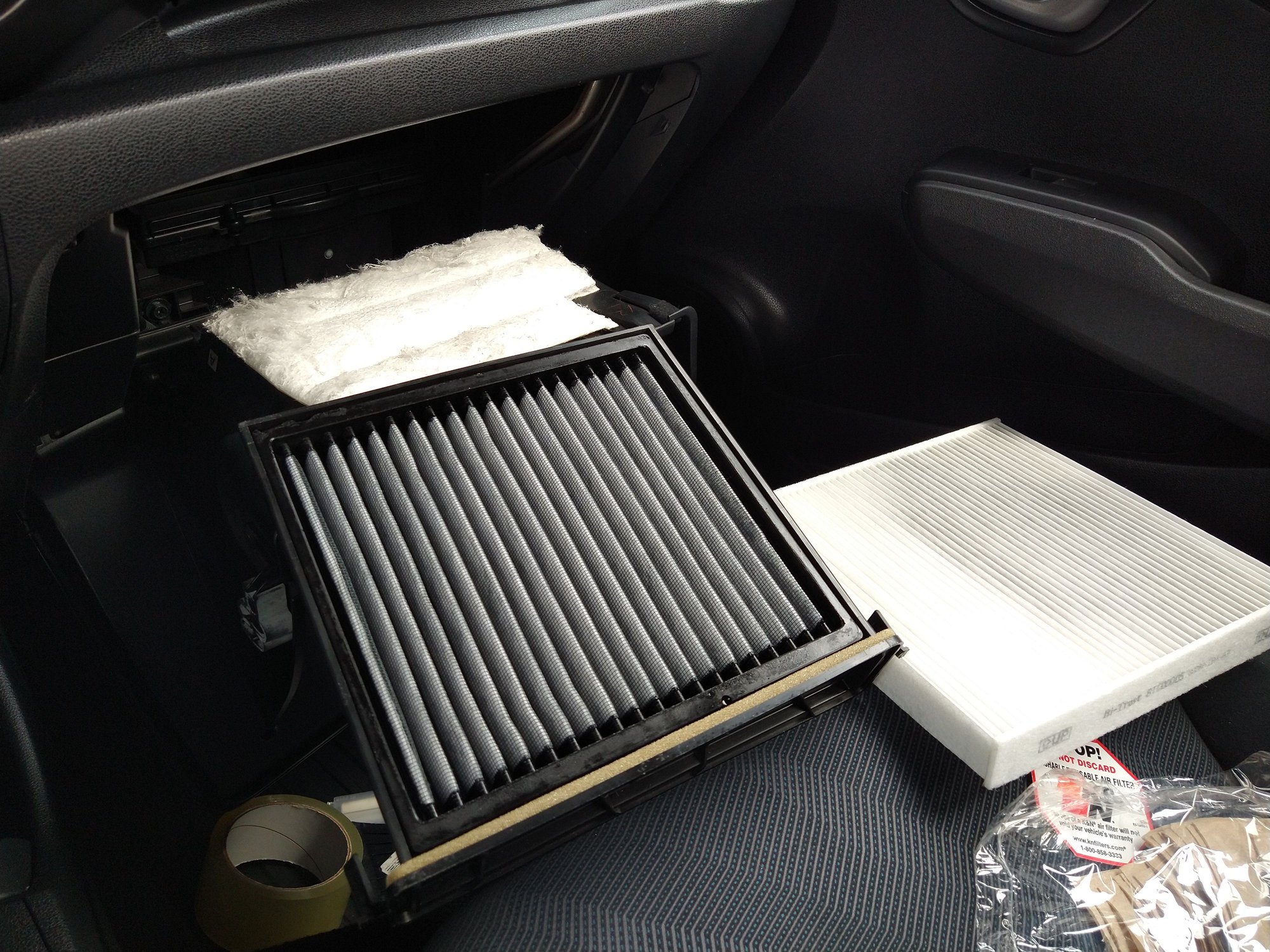

K&N Cabin Filter
Part# VF2033
Installed this yesterday. Was curious if it would increase airflow. I think I notice a slight increase, but its probably all in my head. Just like one thinks they notice an increase in horsepower adding a cold air intake to a car like ours. I know i can buy like 8 regular filters for the same price. I like to change mine every 6 months or so, and wanted something a little more robust and nicer...for idk what reason. Anyways, it fits perfect. No weird smells or anything.

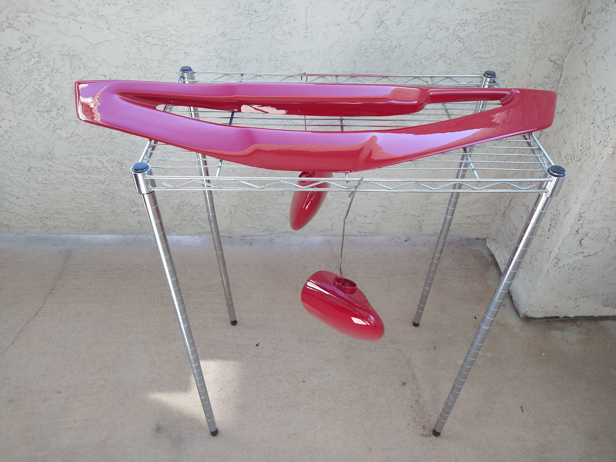

Did this today. Now just needs sand and buff after it hardens. Been thinking about painting the mirrors for at least a year.

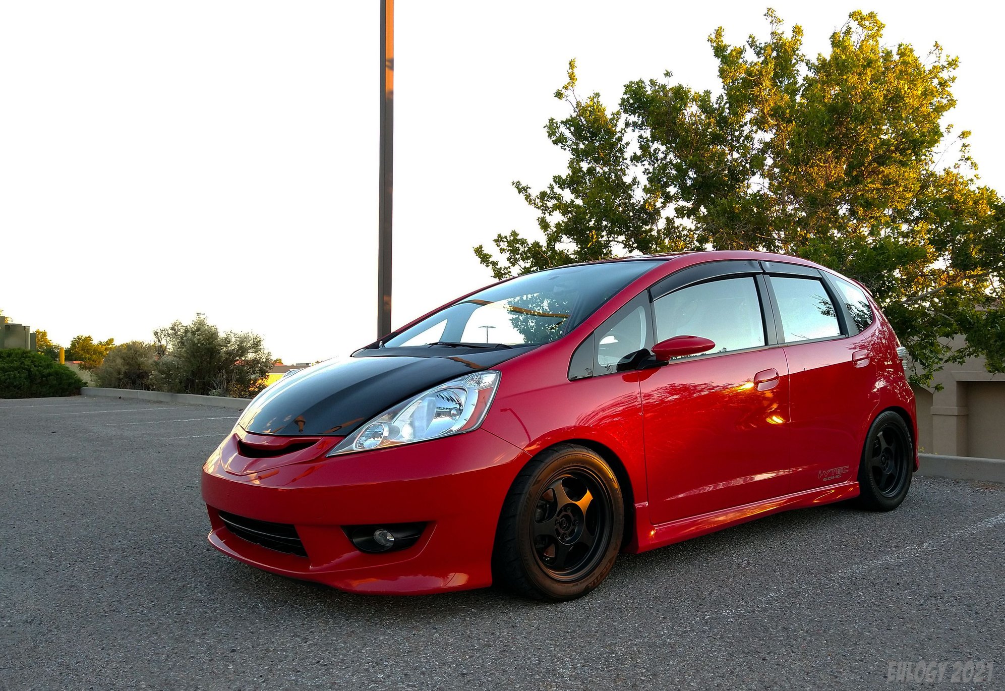

Grill, mirrors, BC racing coilovers, moog endlinks, Honda r/l lower control arms, cusco lower brace installed.
Mirrors and grill still need sanding. Grill need double sided tape for corners to sit flush. front coilovers need to be raised half inch. Currently 2.5" rear drop, 3" front. Still need to reinstall spc camber bolts and get alignment. Also playing with damping settings. Currently at 25 out of 30 all 4 corners. Ride is excellent aside from front minor tire scrub on turns and dips, but should be remedied with camber and raising front end a bit. Freeway speeds feel way more stable. Corners damn near flat. This is exactly the feel i wanted.
Finally received the seat covers. Will be cleaning the seats first...letting dry and installing them.

Adjusted BC racing coilovers / Install Clazzio seat covers
Coilovers
Had lots of scrubbing at 3" front drop. Raised up to 2.5" drop to match rears height. for anyone wondering the front struts have 1.5 inches of travel with the recommended ~5mm of preload on the spring. there is 3 inches of total stroke, but half of that gets compressed with the car on the ground. havnt measured the rear shock yet. i removed the rear collars to achieve the 2.5, the collars account for .5 inch. the threaded perch accounts for .75 inches..but cannot be removed safely. running only the short springs will probably result in one loosing the springs on a rear hop. i have the rear shocks shortened all the way and they match the length of the spring/perch/no collar combo with about 5mm of preload.
with the front raised i havnt heard the front scrub. ill know for sure on my commute to work this week. waiting on new OE front strut nuts/washers...then ill pop in the camber bolts and get alignment.

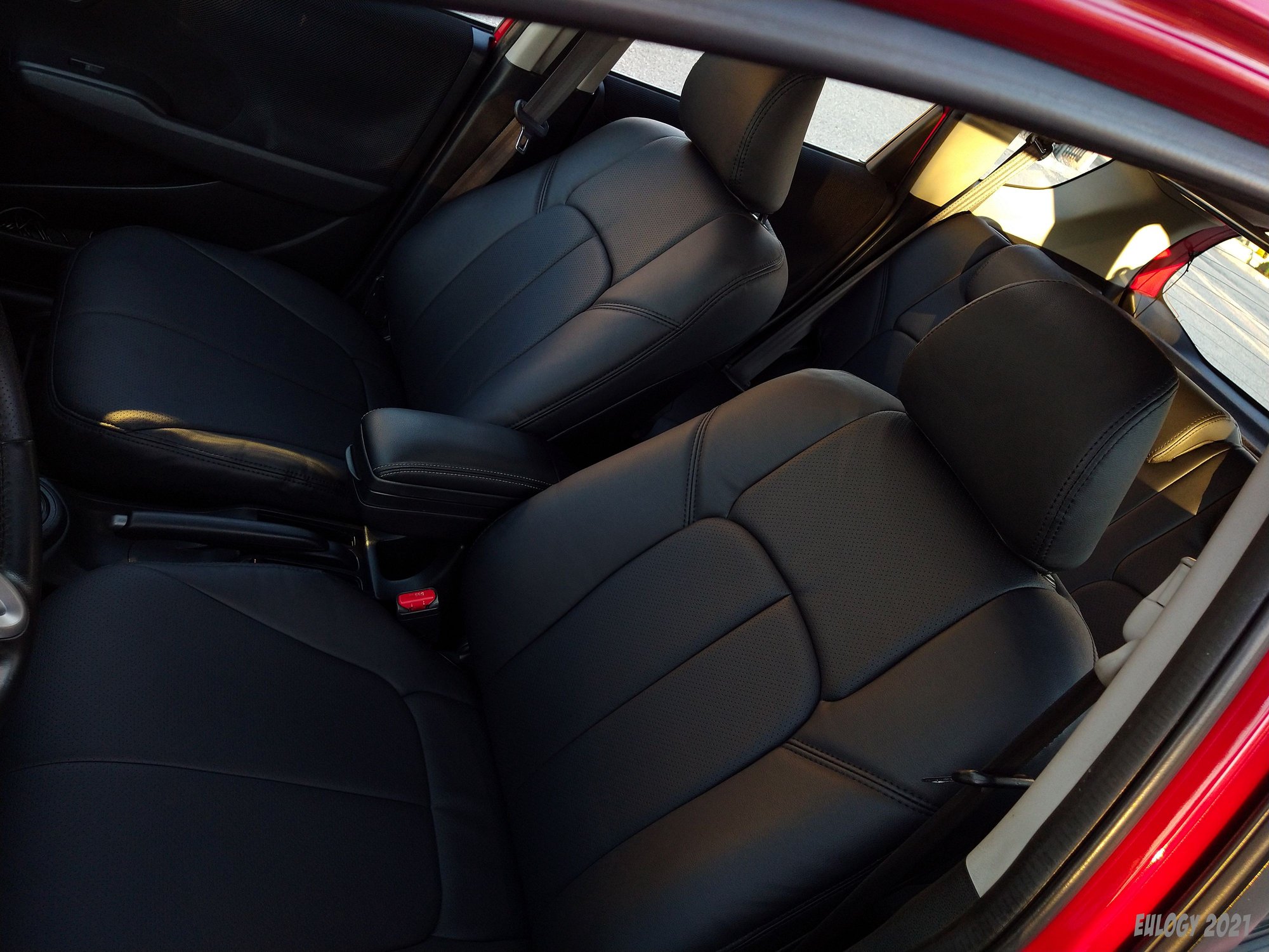

Seats
This weekend i also pulled out all the seats and cleaned them with a Hoover Spotless portable carpet cleaner. though it did a decent job of cleaning the seats, along with a brush attachment for my drill...the Hoover leaks like hell, so i cannot recommend it. After seats dried i installed the Clazzios. Glad i took the seats out, as i felt like i was able to get a much better fit than trying to do them still attached to the car. its the equivalent of installing coilovers or spark plugs with the cowl installed. It still is a lot of brute force wrestling though. now that they are installed, ill let them finish taking shape to the seat and tweak them a bit more in a couple weeks or so..., but i luv how they look and feel.
so much better than stock

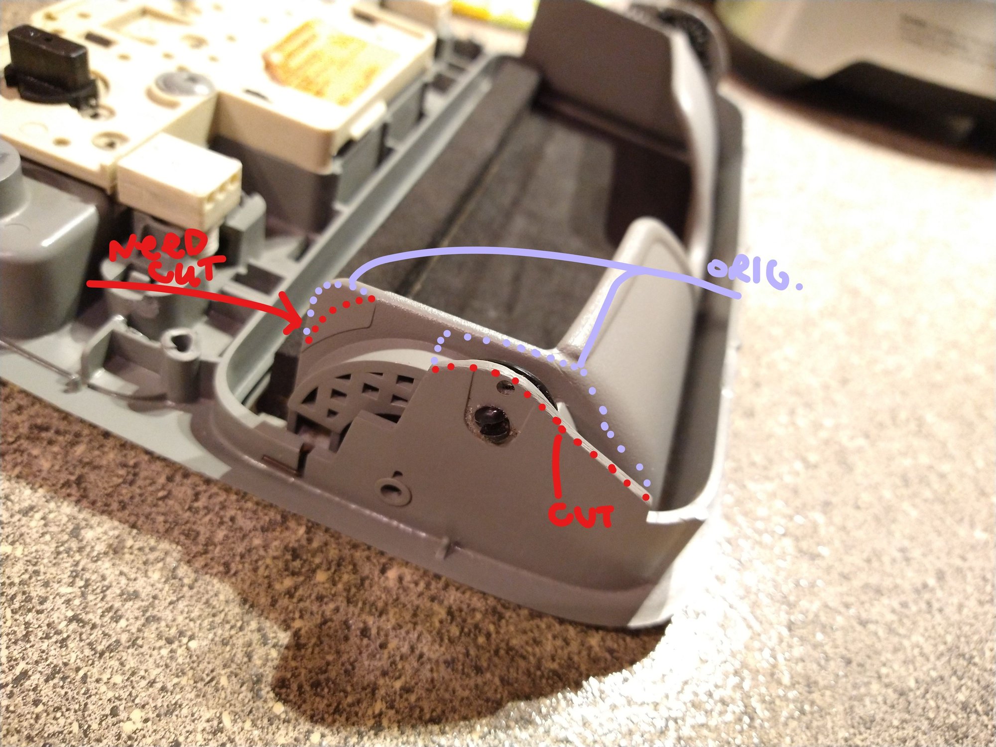

2nd Gen Honda Odyssey Map Light Install
Wow. another project that i thought was going to be quick and simple that turned complicated.
thankfully i was able to find a Fit in the junkyard when i got this piece to test it out. i originally got a map light from at 2006 odyssey that included the gps Mic, as i saw in another thread, where the person was able to fit into a GD. i guess the roof has more space because it wasnt going to work on the Ge, as it protruded way to low on the sunglass portion. the 2004 odyssey map light was a better candidate as it came much closer to fitting. i had to remove the shell to the roofside of the sunglass holder to even get close. shout outs to the Fit in the junkyard for letting me violate its roof for testing.
it was nerve wracking as hell cutting my headliner. wish i was able to get it on the first cut, because while inching it down prevented an over cut, the process left the edge towards the rear kinda ragged. i couldnt cinch down a thin slice of the foam/fabric cleanly, so i used a portable solder iron with a knife edge to keep melting back the headliner opening. pita with foam shavings and dust all over the place. if the hole is too big the map light will have play, if it is too tight the headliner will distort and/or the sunglass holder will distort and it wont function properly.
next i needed to dremel down the map light on the offending areas. really its just 2 spots on each side. then since the rear mounting holes that were in the upper shell of the sunglass portion were not going to attach to anything on the fit, i decided to glue pieces of a plastic radio bezel on that edge, using a piece of headliner foam as a guide to ensure a snug fit. the screw holes in the front dont match up either. first i tried jb welding some nuts to the original roof bracket, but that failed since the holes need to be just off the edge of the roof bracket. i cut and made "brackets" out of another piece of radio kit adapter stuff, screwed one side into the original roof holes, and used self tapping screws to mount the new map light. the holes end up being right on the edge of the Fits roof bracket, so they need to go in at a slight angle.
the original map light grounds itself out when you install the passenger side screw, but the odyssey map light uses a wire of the pigtail. for anyone trying this mod, dont forget to cut the odysseys map light plug out of the donor! i cut mine a bit too short (need about 5 inches) so i needed to extent the pigtail wires. i installed the ground under the passenger side plastic bracket i made, using the OE map light screw, and used a metal washer sandwiched in between to ensure good contact. the Fits rearward maplight brackets need to be bent down and towards the front of the car. the positive wire got soldered to the OE wire coming out the roof. theres a second black wire on the odyssey pigtail, which i assume would tie to other dome lights.
a also needed to use the foam i cut out from the headliner as a wedge spacer (doubled up). it is approximately 4 inches from the opening (towards the rear of the car) to not only push the headliner down a bit, but also remove the dead space so there is no flexing of the headliner when pushing up to use the sunglass holder (the rear is "floating" as its only wedged to the headliner. in the back).
since the odyssey inner shell wasnt usable for clearance issues, the inside of the roof is visible when opening the sunglass holder. its not terrible looking, and dark in there, but i wanted it to look more finished. i had some leftover black speaker carpet i glued to the roof. i also painted the backside of the Homelink mount because it was slightly visible yellow plastic.
topped it off the install with reusing the LED panels i had in the Fits original map light. fortunately i still had the wedge bulb adapters to do so.
i got a few light smudges on the headliner i need to clean up, but this project is done.
comparison - Odyssey top, Fit bottom
the purple dots indicate the original shape. red dots indicate where to trim to. right side of pic is already trimmed, left side needs trimming. both passenger and driver sides need to be trimmed in the same places.
pieces of radio bezel glued to map light. this is what will hold the rear of the map light in place. only Loctite 2 part plastic bonding system glue will work. trust me. foam used as gap guide.
plastice brackets. mounting points of odyssey map light are almost perfectly aligned with the edge of the Fits roof bracket, so the screws need to go in at a slight angle. Fits rearward braces need to be bent down and towards front of car.
Homelink Buttons Functioning
speaker carpet glued to roof.
