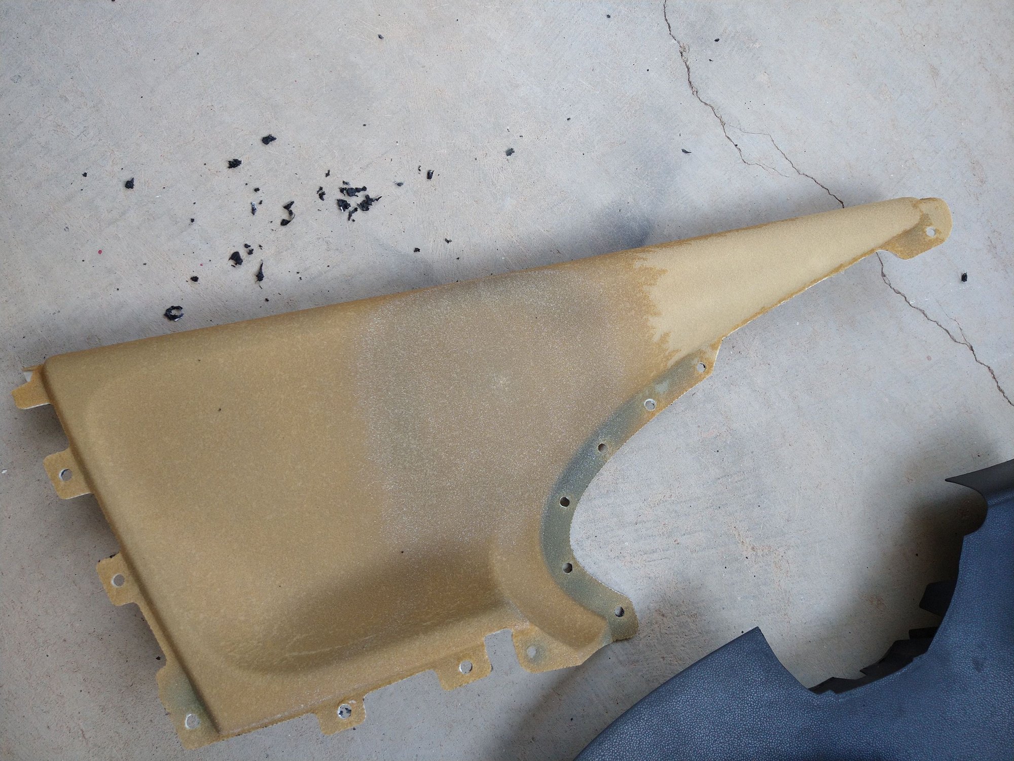

Climate Control Mod
High(er) powered front vent airflow!
So I have been tired of the crappy airflow of the GE8. I use the Head/Foot mode on the Climate control a lot...and when in that mode the airflow to the head drops more than what it should in my opinion. so after a year of thinking about it, i finally decided to act. I Duck Taped the chamber in the center dash that feeds the vents under the front seats. My Fit never has anyone in the back seats, so no loss for me. When done with this mod, your brains wont be blown...but there is a significant increase in front airflow when using the "Foot Mode" in combination with anything else (ie Head Mode, or Defroster).
Very happy with the ease of this mod and the results!
sorry for the crappy pics..
this lower chamber under the power outlet is our culprit. grab it near the yellow cable and pull upwards while pushing downwards on the other end closest to the engine bay...which will separate it from the upper chamber.
here you can see it splits into 2 ducts that go under each front seat .
this is the hole we are going to block off. no wonder our front vents suck. all the air is going down here when using any of the "Foot Combo Modes".
Here is the "Duck Tape Block Off". I think one piece should be fine. a person probably could put more, going the opposite direction, but i didnt want to go too crazy cuz we need to put the chamber back on... and its a tight fit.
Now slide the lower chamber back on, and make sure to push up until it bottoms out on the top chamber. u should be able to feel the notch from the upper chamber mate with the groove in the lower chamber letting you know it is secure. Thats it! put your console back together, turn your air on and enjoy!!!

Door Panel Restoration
My door panel's fabric has began fading to a purple color on the top edge thats exposed to the sun. i ordered some black "jersey fabric" from ebay which can be referenced in this thread...
https://www.fitfreak.net/forums/2nd-...ml#post1021459
I thought it would match the Clazzio seat covers I have on order. I didnt hate the Oem fabric pattern, but I wasnt fond of it either. I almost ordered some all black synthetic leather material to match the seats (pic below), but wanted something more neutral in the event i take the Clazzio covers off.
I also have a crack on the back corner of my drivers side arm rest that has been growing, so i will address this too. The plastic is Polypropylene (PP) in case anyone is wondering. pita to glue anything to, but will try some Loctite Plastic glue tomorrow that is suppose to work on PP.
Today I pulled off the door panel to assess the crack, and decided to try grinding off the melted plastic "buttons'' holding the top and bottom door panels together to see how much it is going to suck. wasnt bad at all. was expecting much more work and mess. I fully committed and ripped off the original fabric.
plan is, tomorrow i will buy some glue for the crack, spray adhesive for the new fabric, and some screws and washers to reattach the upper and lower panels back together. the new jersey fabric is suppose to be here Saturday, so in the mean time i will prep the other 3 doors.

Jersey Door Insert Install
well that took longer than i wanted. but its done. not a hard job, but time consuming.
fixed the drivers side crack with some Loctite Plastic Bonding system yesterday, and let dry over night. seems to work pretty good. glued some extra plastic from a milk container to the bottom side for reinforcement.
got the Jersey material in midday today. at first was disappointed. i wasnt expecting it to be so thin. it is literally see through. when i mocked it up on the door panels i could see the brown underneath. just barely, and in direct sunlight. but i could see thru it. i knew this would bother me. i thought it was going to be thicker and textured. its thin and.... spongy? i spray painted one of the door panels flat black to see if it looked better with the jersey material on it. much better....so i decided just to give it a try. pretty sure if i decide to take it off its going to rip all to hell and make a mess since its so thin.
sprayed with 3m 90, attached material, reassembled door panel with screws and washers. hot glued the foam pieces back in and put a drop of glue on each screw to help with vibration. reinstalled panels back in the car. came out better than i thought, but still wish material was thicker and more dense. looks a ton better than the factory fading color/pattern. they are a bit shiny too, which i also wasnt expecting, and not sure i liked at first, but i guess makes sense for them to be shiny, since the interior plastics are shiny after i clean them.
overall im pretty happy. they kinda grew on me as i was installing them. they are a small portion of the interior, but they made it feel a lot different and modern. curious if the holes are going to hold dirt or weird things. lets see how long they hold up.
Plastic Glue for Polypropylene (PP)
thinner than expected jersey door insert
spray painted door panels with flat black so wont see brown thru jersey material holes. more or less works good enough in this application.
first of 2 coats of spidey web. sprayed backside of jersey inserts too.
fabric applied. got a bit of glue over spray towards right edge. can be cleaned off quickly with rag and rubbing alcohol...before glue dries!
screws with washers to reattach. careful not to screw thru frontside!
