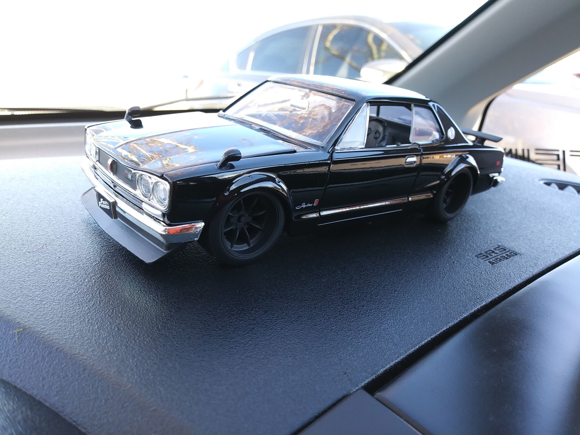

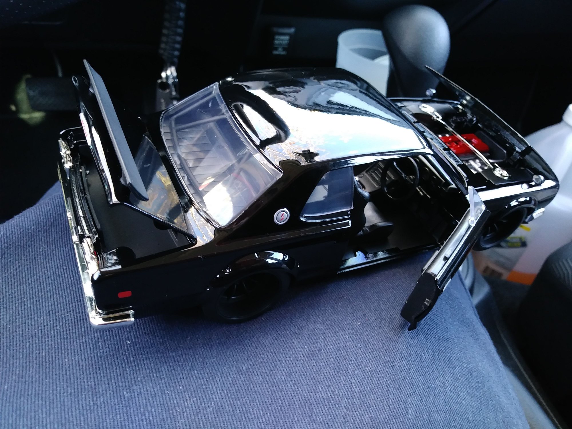

Went to Walmart for wiper fluid...got some...and left with something extra I 100% did not need. one of my favorite cars ever. complete with deep watanabes. wow, guess Ill never grow up.
ps..omg everything opens.

That is a great find!

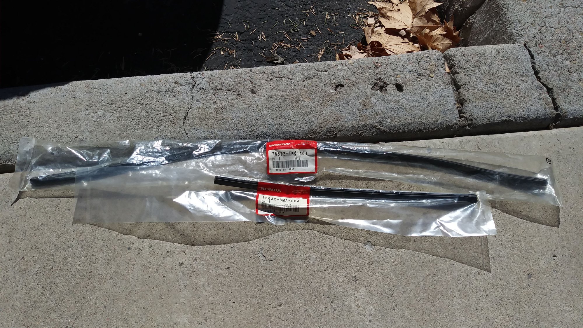

I guess ive been going a bit too hard on my wipers since refilling the washer fluid with de-icer. they were a bit dry, and 1 finally ripped. guess ill stop being lazy and scrape the thick ice off from now on.
anyways replaced the fronts only with Oem refills to retain original wiper arms. $8.50 each at local dealer. heres pic w part numbers for anyone interested ..but mostly posting for my own future reference.
P/N
LT FT 76622-TK6-A01
RT FT 76632-SMA-004
REAR 76632-S2K-004
