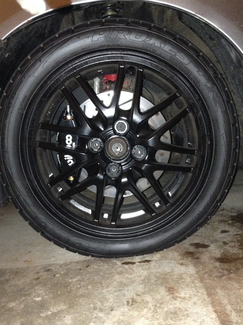

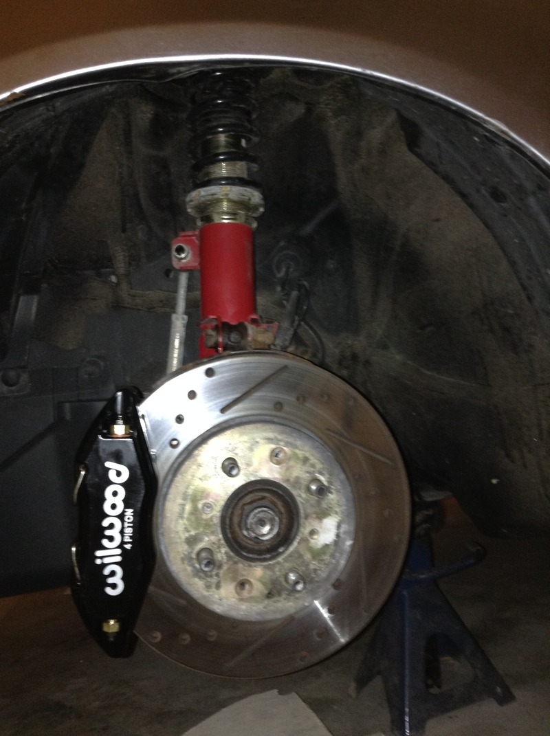

I'm a complete noob with brakes and I put these on with no problems, directly bolts on, no other parts required save for some brake fluid to bleed the system.
Attached Thumbnails Wilwood release new caliper for Honda, No Bracket needed, Direct Bolt On-c72ce2d4-d21f-404a-a123-b3dcf0a8d2bf_zpsjl6udmrk.jpg   Wilwood release new caliper for Honda, No Bracket needed, Direct Bolt On-62e93400-6ce5-4e6a-9582-9d6a282cfe8b_zpsfkysnfvo.jpg

The rotors are almost the same in weight, just slightly less because of the drilling and slots.
And these should fit 16 because they fit MOST 15s. I'm running the Integra LS mesh wheel with no issue and it's 15".
The only wheel I've heard these won't work with is the higher offset 15" enkei rpf1. The lower offset 35mm does work so I've read.

They do fit the stock 16's (2009 Fit Sport) but the clearance is crazy tight. Like a 2mm gap.

The clearance issue is between the spokes and the caliper, not between the outer ring of the rim and the caliper. I bet your gram lights will fit. You'll definitely want to measure though just in case.
