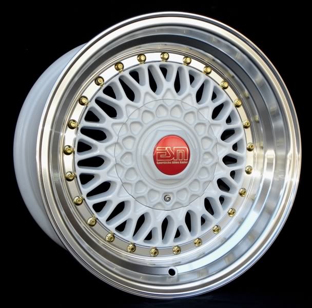

Hi I'm new, long time reader, first time poster. I want to get some of these esm 002 rims. 16x8 with 20 offset. I currently have swift spring on the car. Will this set up work or will I end up spending a lot of money on modifications to make this set up work. I plan on getting 205-45-16. Will this set up rub? I appreciate all your help from the fit gods. Also I have search the forums many times for this question. Thanks

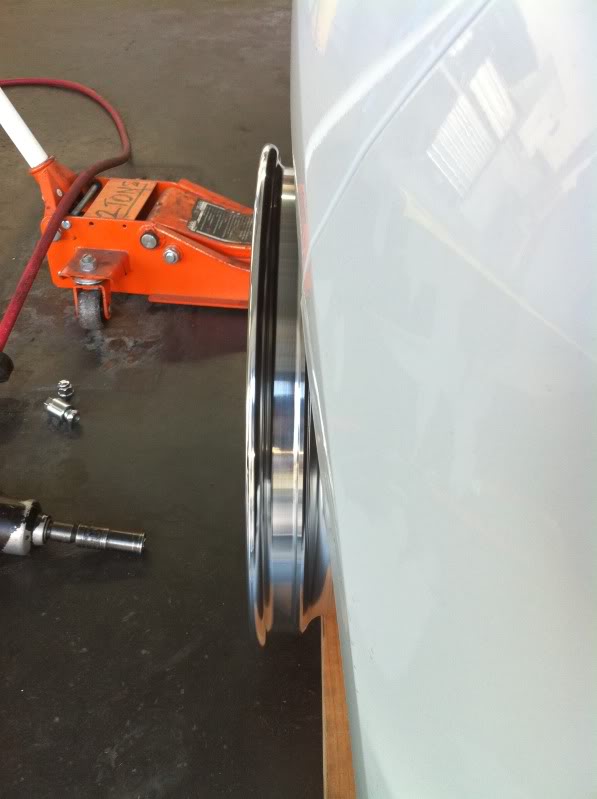

I keep seeing these threads pop up with people wanting to run 16X8 +20 offset so here is a pic of my fit with my work wheels with those specs so you guys know what you're in for. You will need to roll and pull your rear fenders in order to fit.

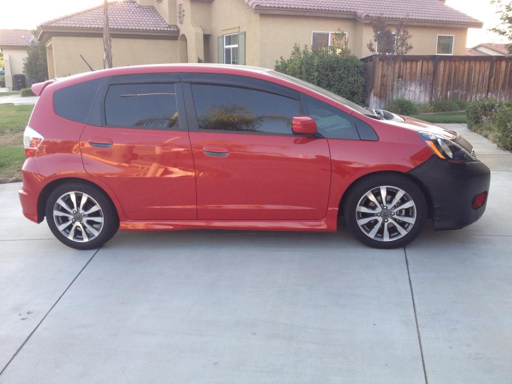

Here's a pic of my current set up on swifts

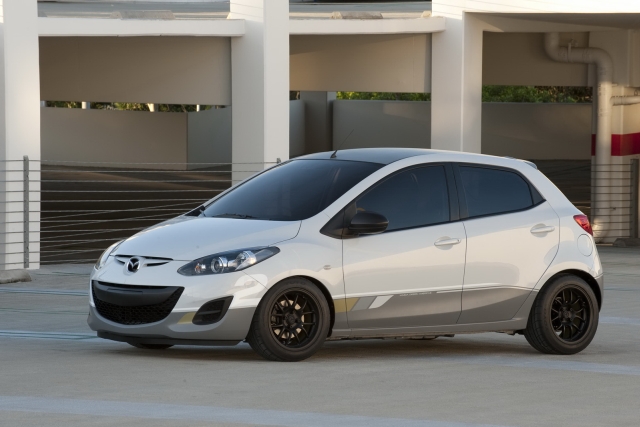

It's funny how other small cars can fit 9" wheels with no problem because of the design of the fenders.
The Mazda 2 guys are running 15x9 without pulling or rolling fenders but it's because of all that room under the fenders.I bet our cars would look great with some 15x9 6ul's
