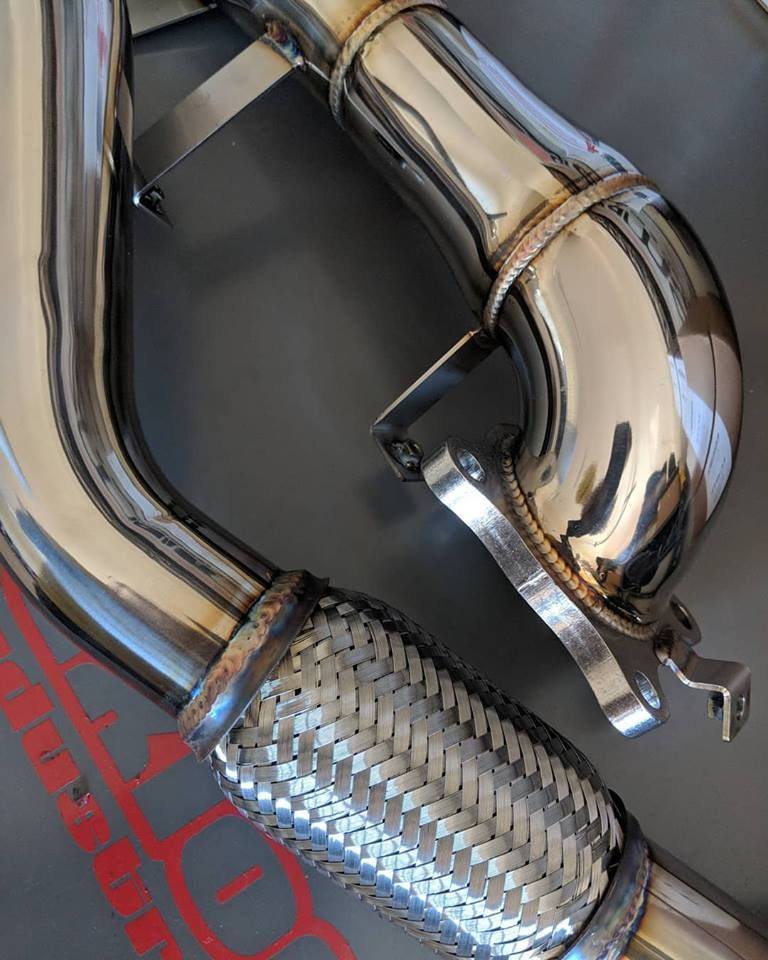

Well since we will be starting it up with the stock turbo we needed a downpipe, this is our downpipe for the 10th gen Civic should fit nice with minimal mods.
We wanted to get the swap running with most of the stock parts to better understand it for you guys and then we will swap on the Type R turbo after
