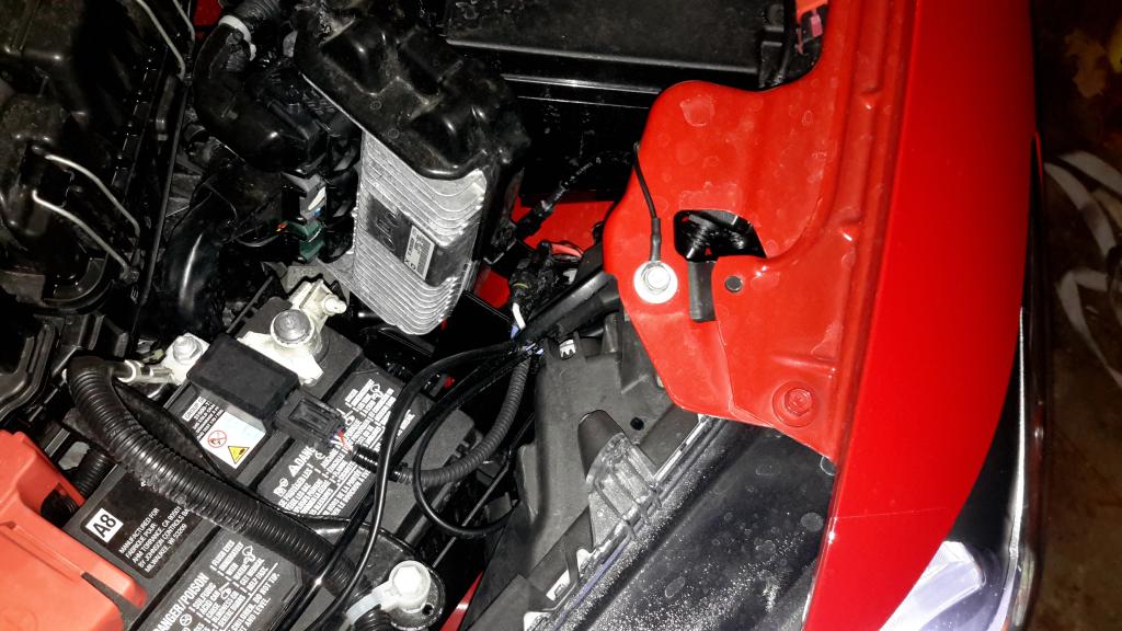

Wait, if you pull said fuse, you could get rid of the DRL function?!?! WHY DIDN'T I FIND THIS OUT SOONER?!?! Does this cause a warning message?
Also, I have HIDs in mine, but no stalling issues. I have a Kensun bixenon system, and it hums loudly if set to DRLs. I've had a couple issues with warning lights coming on with the lights on Auto and turning the car to accessory, but nothing like stalling. I've had DDMs in my other car, and I have to say I'm not terribly impressed by them. I do need to aim the lights down though, because my high beams are now worthless except on hills.
As for the grounds for the harness, I just used the bolts on either side of the engine bay like this. It seemed like it was made for it!

I just installed some kensun bixenon headlights and kensun fogs and also removed the #25 7.5amp fuse. I get a Starter System warning light and the headlights won't turn off when I switch them to off. They only turn off when I turn off the car. Anybody have any ideas?
Passenger side ground is bolted to the same spot as esnave's but the driver side is grounded to the negative itself.
