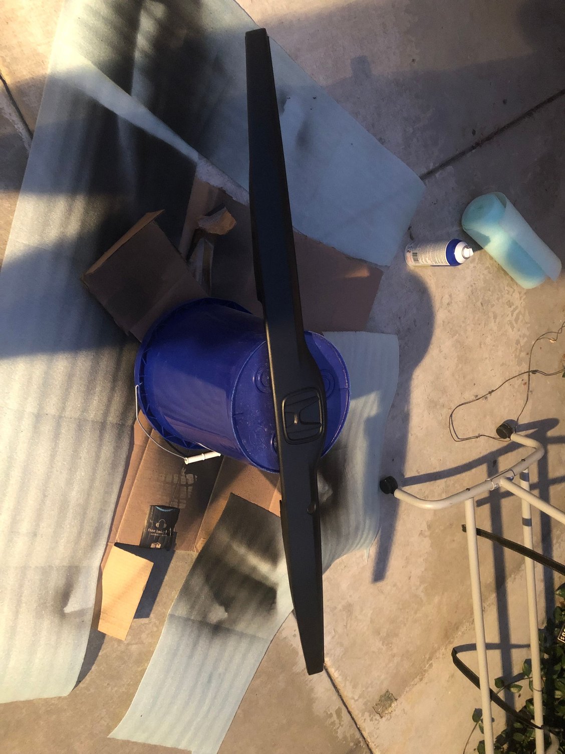

Actually looking at autodip / plastidip as an option. I think i want a glossy finish, so we will see. Bonus is that I could probably do it in place... although i have never used either before

Thanks for showing how to take the garnish off! I am plastidipping it right now!

Posts: 11
Plastidipped!

I love the plastidip look.

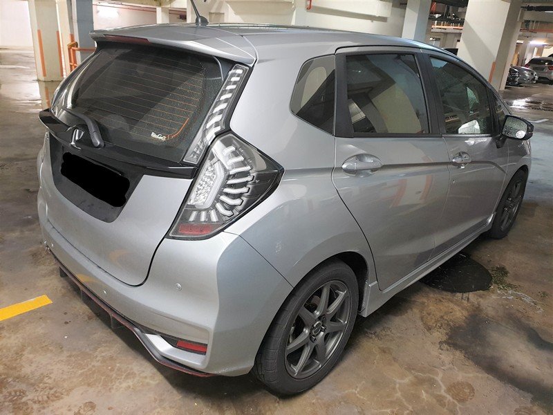

Thank you. I need to install a Mugen spoiler here soon.

JingJangJoe's Avatar
Joined: Oct 2018
Posts: 184
From: Singapore
Cool
Mugen-nized
