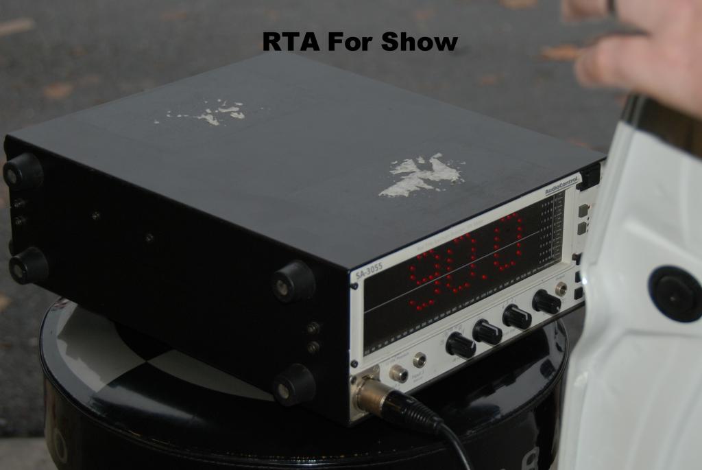

Hooked up to an RTA which seemed more like show than go.
