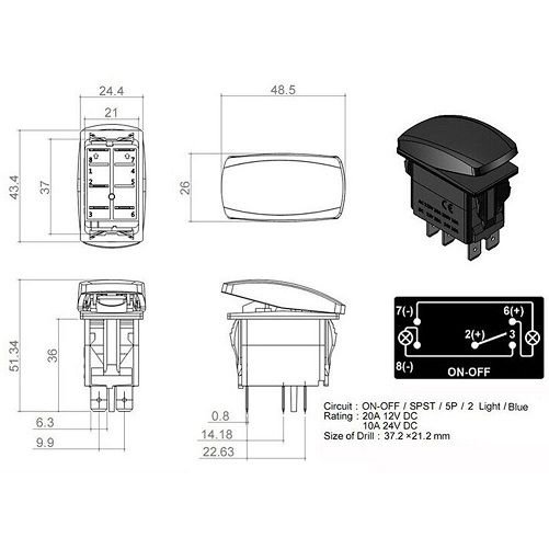

I know this is an old post but there are rocker switches that will fit the OEM blank openings (no drilling required). Not a big fan of the drilling and mounting the switches on top of the blanks. They pop out too much and can be accidentally kneed.
The switch pictured below won't pop out as much. There is a big selection of etches to chose from and I think even they can be ordered custom etched.
