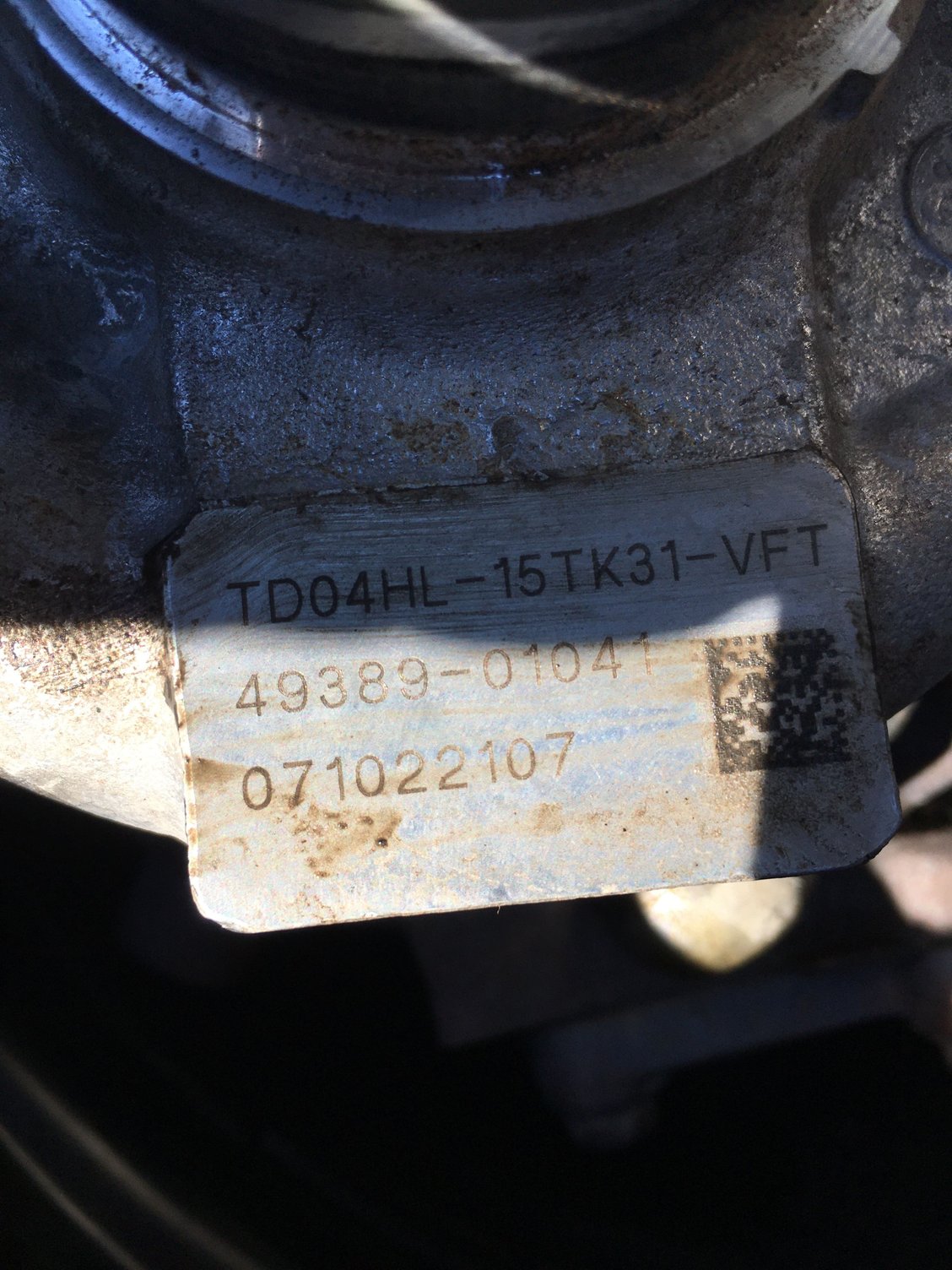

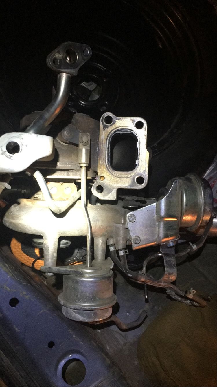

Turbo I intend to use is off the 2019+ RDX
still unsure if the turbo will be a direct bolt up as the RDX has a similar single exhaust port like the L15 engine, I’d assume they are different but by Honda dreams it would be a miracle if they are the same since the engine this turbo was removed from is a 2Liter engine
this model turbo is VFT, Variable Flow Turbo that is pressure actuated instead of computer actuated so that should be an added benefit if I can get it to function correctly with the 1.5 liter engine in our cars

For a 2L Engine the exhaust flange seems to be smaller then our 1.5 L series, so making a adapter plate shouldn’t be too difficult, biggest worry is the spacing in between engine and fire wall ( I don’t want to move the engine forward but will negotiate the fire wall with a hammer if necessary)
