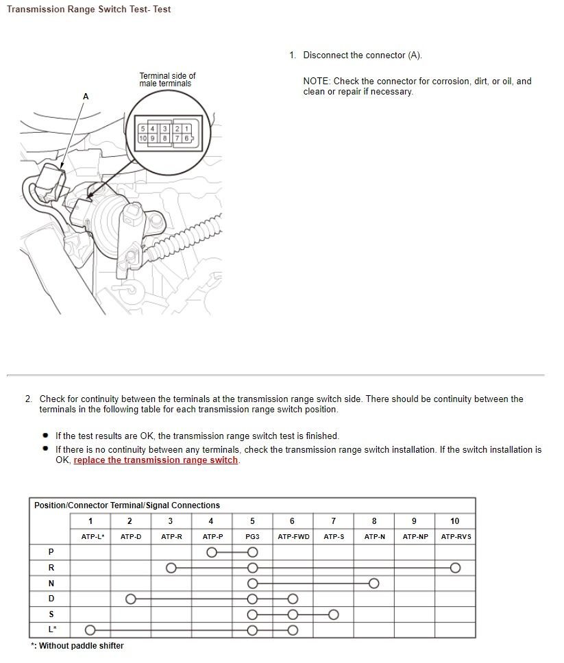

Check the transmission range switch. It tells the PCM what position the gear selector is in.
Old Jun 2, 2021 | 10:32 PM
bplegend's Avatar
Joined: Nov 2018
Posts: 9
From: New York, NY
sounds right. But that is a heck lot of things to take off.
