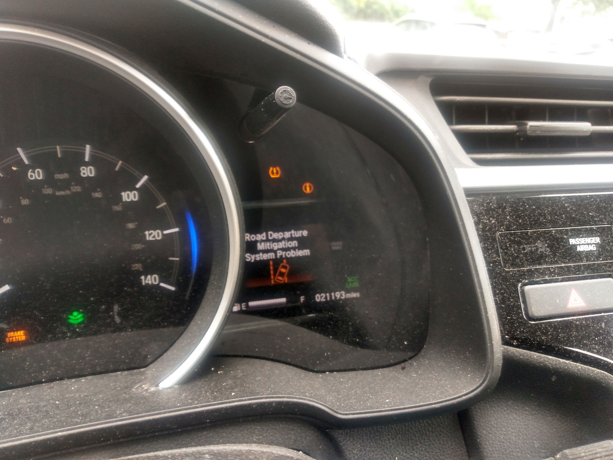

My son's 2020 Fit lit up all the warning lights plus the lane warning lights yesterday. It's still under warranty, so I guess I'll call the dealer. It will be interesting to hear how this isn't covered by the warranty and will cost $1,500 to repair.

About 20,200 miles, but I know they will find a way to blame it on us. Fortunately, the car drives the same as always.

I have had these lights come on twice. Once I ran my battery down using an air pump. Yesterday, I removed my airbox to change the CVT fluid. I had to disconnect a sensor (MAP?) and remove an EGR hose. When I started the engine, all the lights and warnings came on. In both cases, disconnecting the negative battery terminal for 10 minutes fixed the lights.

All the lights went out yesterday. If they're still out tomorrow, I'll cancel the appointment I made for Monday. I hardly drive my 2015, going less than 500 miles a month. I drove 5,056 miles in 2020.

This is the first time we've had that happen - with three Fits. I replaced the MAP sensor in the other 2015, but no lights came on. If you ever have to replace the MAP sensor, get the $300 one from Honda. The $50 part from Autozone will not work. Hondas recognize non-Honda parts.
