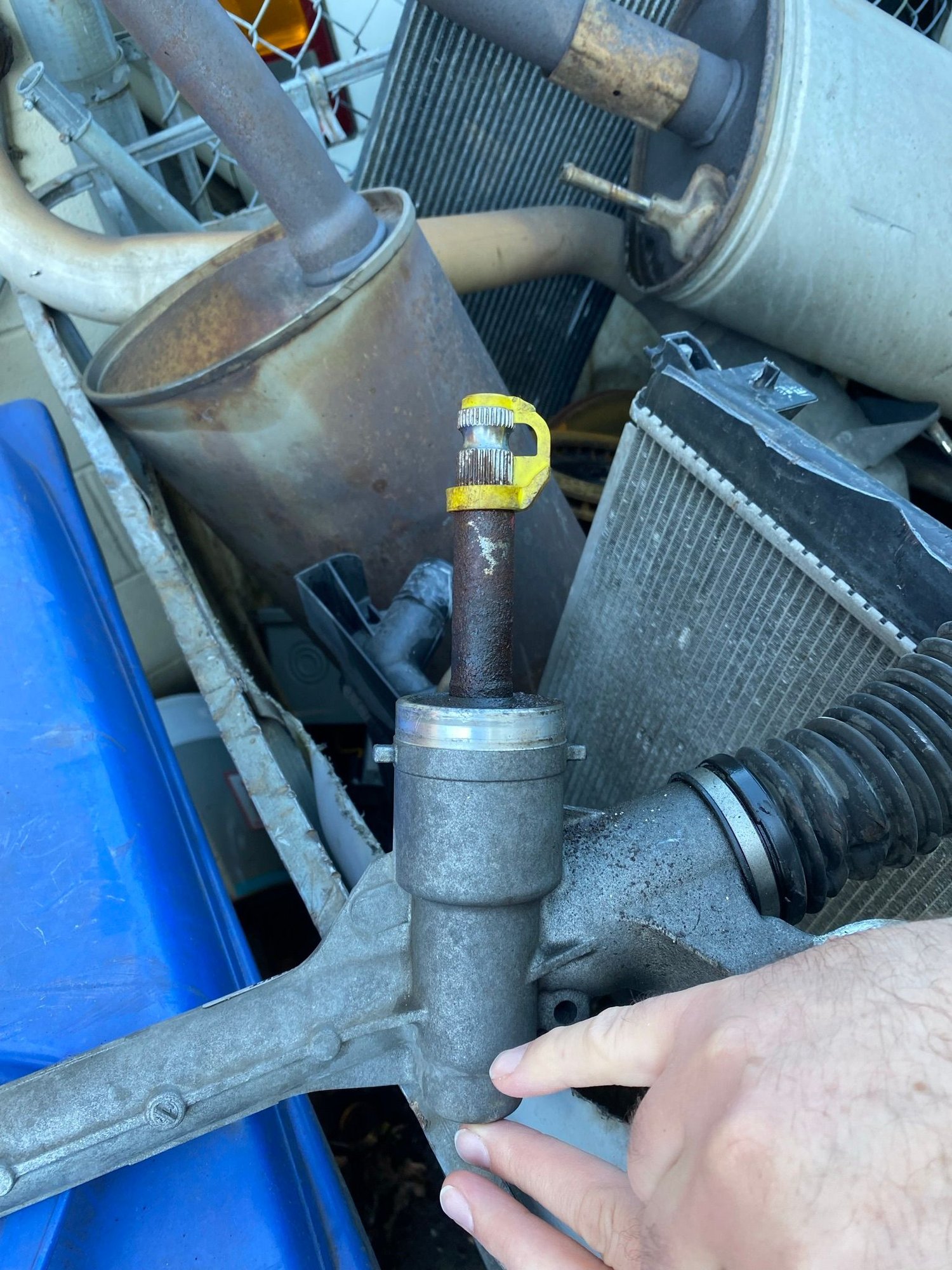

Steering rack failure
2016 EX-L Navi
Probably not related to your problem, but i had a steering rack defect that manifested as a knocking sound when steering. Got progressively louder as time passed. I thought it was initially something suspension/control arm related.
Nope. The splined input shaft was for whatever reason rusting from the inside out. Had I left it any longer the thing would have completely failed on me. The knocking sound was apparently coming from the internals of the steering assembly. Sketchy, to say the least.
The shop I took it to called around to see what the heck was happening (other dealerships, Honda Canada, and other Honda specific shops), but nobody had any idea. The shop and I believe this was defective since new. Honda Canada wouldn’t cover me so I had to pay close to $3000 (Canadian pesos) for the repair.
