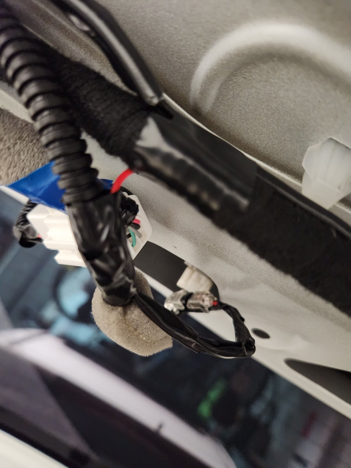

at the top left of the hatch is wiring connecting the hatch to the car. You can find everything there. I found an aftermarket relay attached to my 3rd brake light, I'm assuming so previous owner could watch videos while driving?
This is how it ended up looking when connected to the left pillar light. I got rid of the relay and I just connected the white wire with the teal wires.

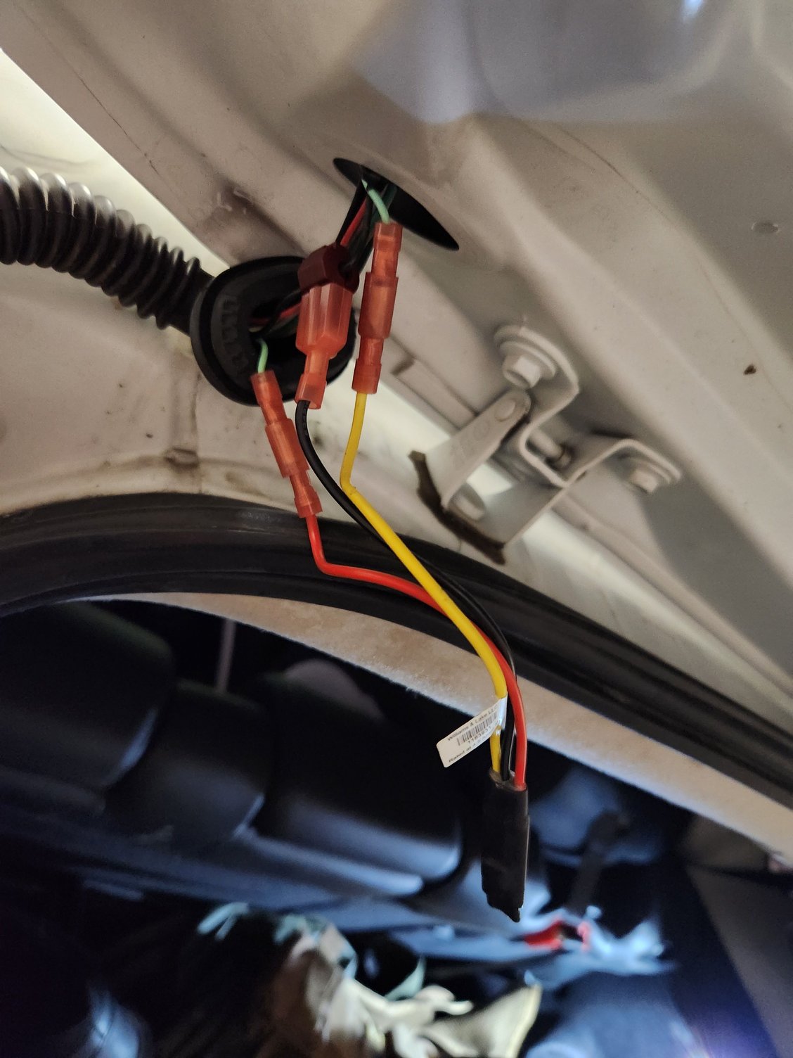

The right pillar light was a while different story. I ran the wire along the already installed wiring and split open the wiring so I could ground it on a screw bracket.
and then used the leftover wiring protection on the wires until I got to the license plate frame lights and tapped the license plate frame light harness' gray wire to the red wire.
And then ran the wire along until I could tap the left pillar light's wiring. Opened it up and tapped the white to the white.
I used zip tires and kept the wiring behind the existing wiring so it had some protection.

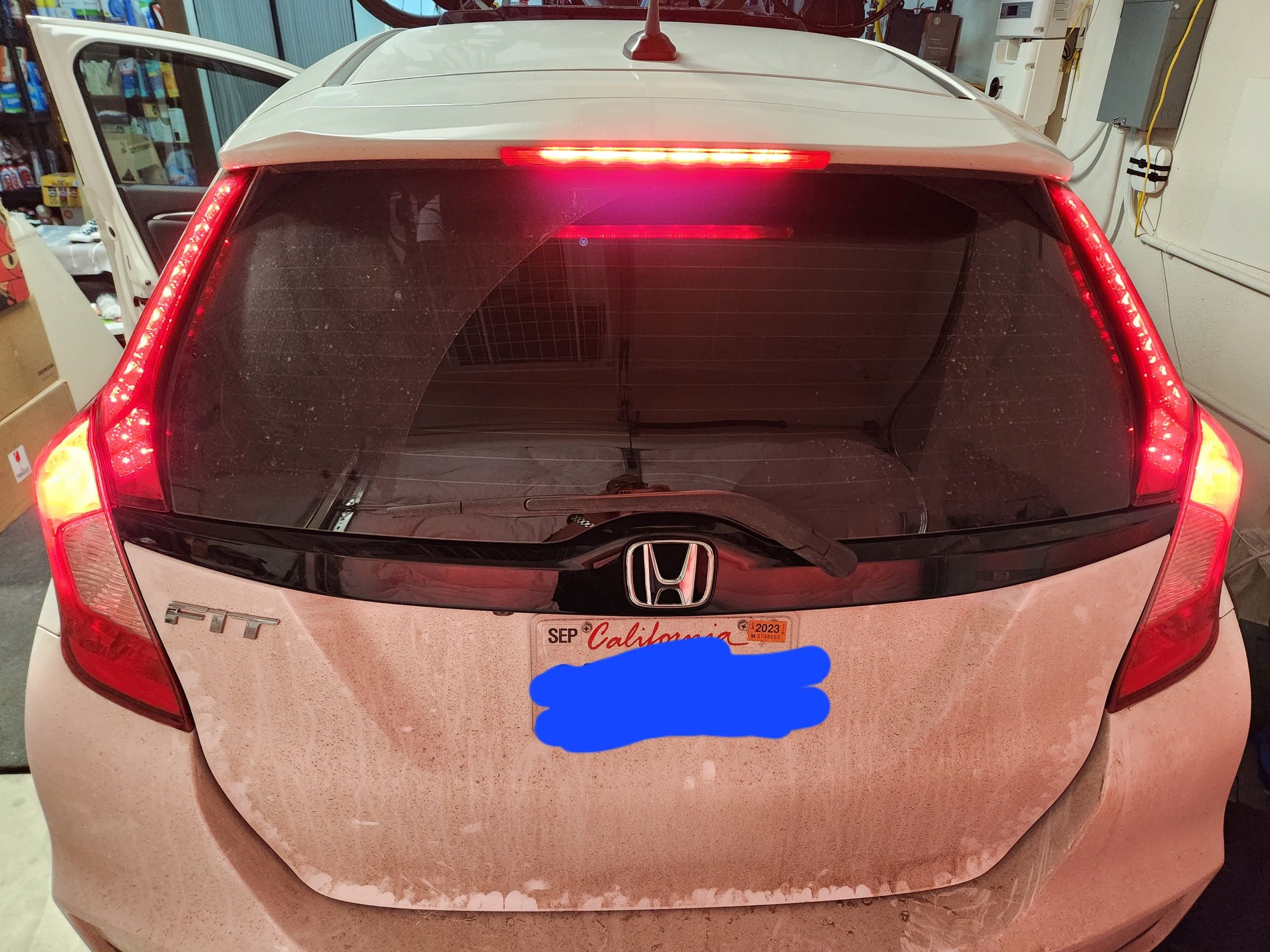

Excuse my dirty car, we had rain and I haven't washed my car. Also I replaced the rear garnish with the black instead of the chrome.
Brakes engaged
