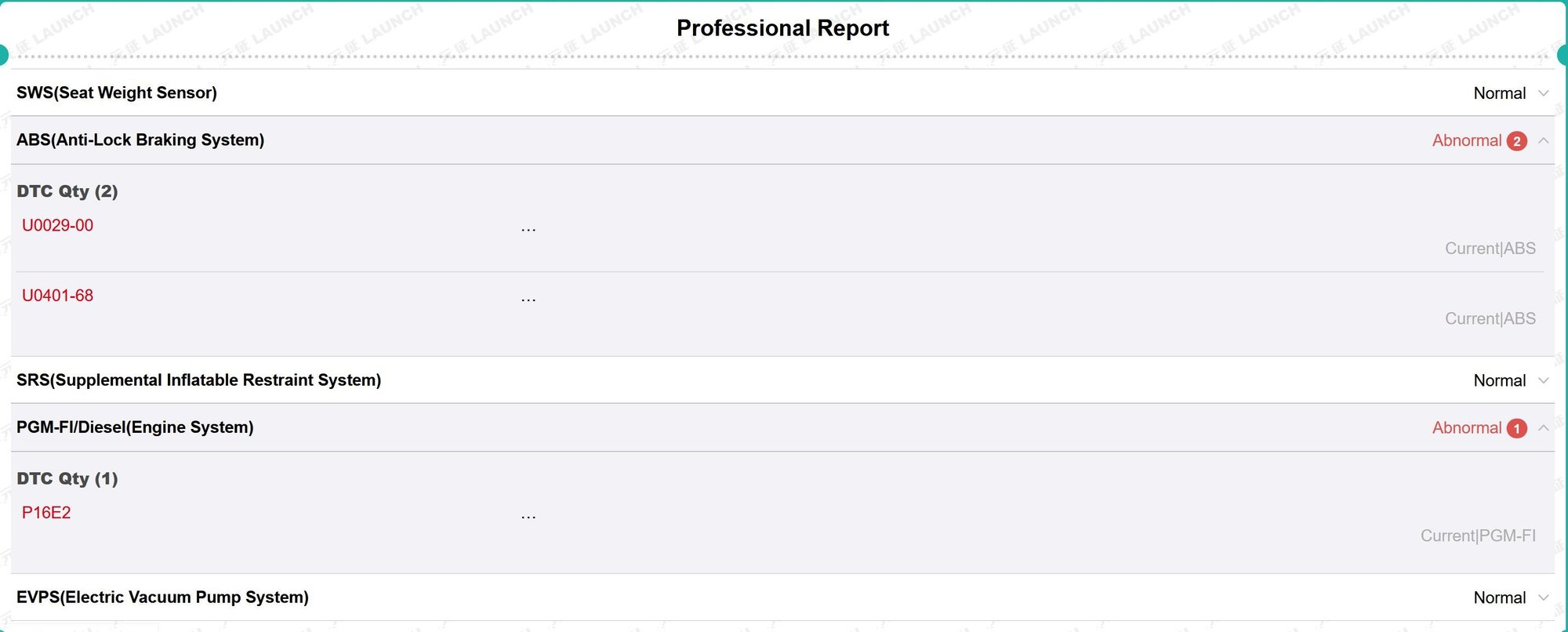

I ended up getting a fancier OBD2 scanner since I didn't get check engine light but I wanted to check the other systems.
Error code I got were:
P16E2
U0029-00
U0401-68

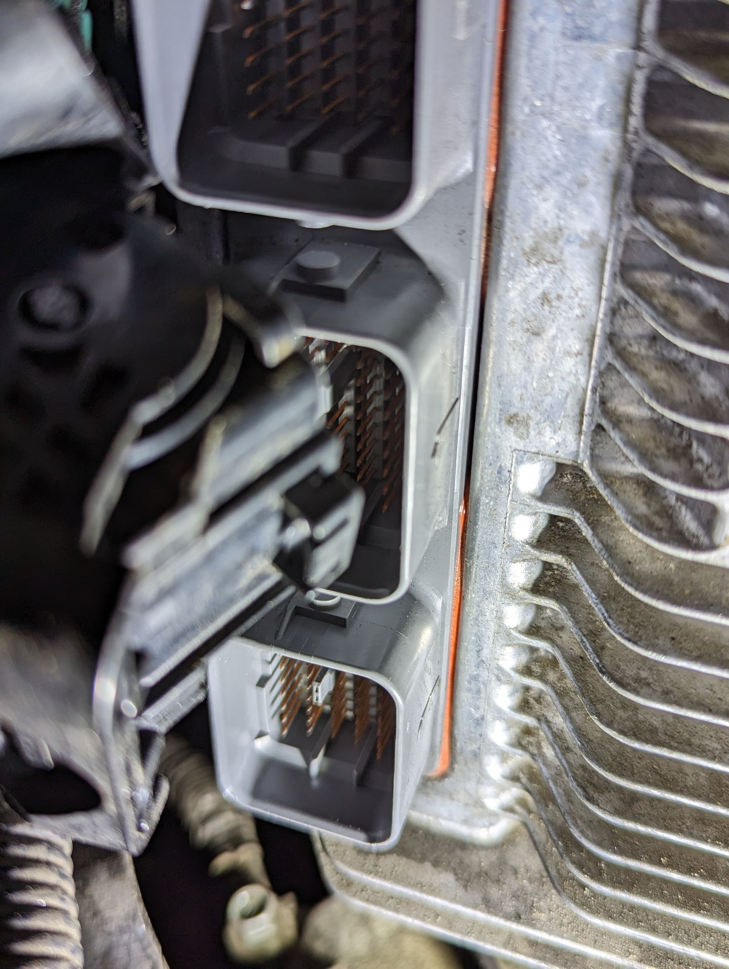

Finally, I removed all the electrical connections to the alternator and the PCM. I inspected them and they all look fine (no bent pins, no noticeable corrosion). I used electrical cleaner and cleaned every connector. Then I used compress air to blow out any loose material and dry the plugs. I buttoned everything back up.
So far, 30 miles and the issue has not came back. I suspect that if it does come back I likely I have wiring or less likely PCM issue.
