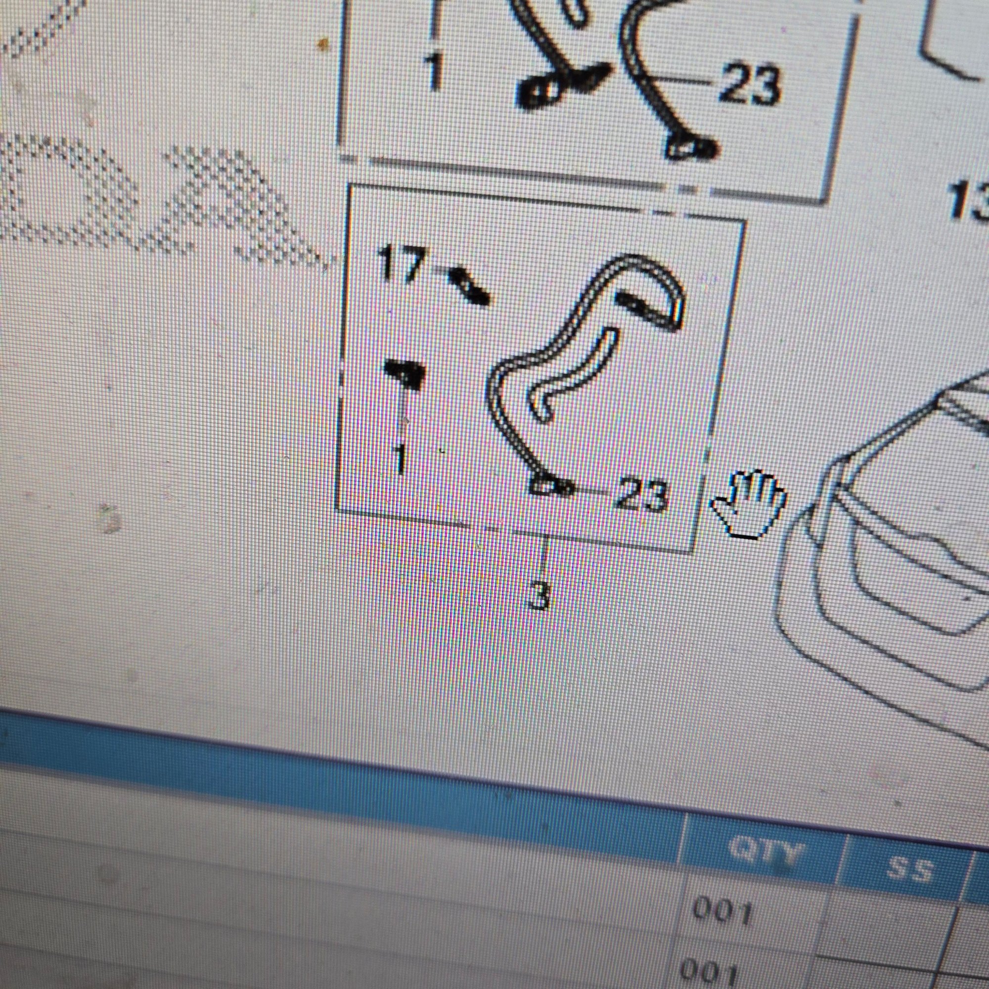

Old Feb 21, 2025 | 02:49 PM

#4 being the holder, #2 being the confusing part:
Old Feb 21, 2025 | 03:59 PM
howarejew's Avatar
Joined: Oct 2017
Posts: 289
#2 is not applicable for 17+ Fits, only '15 and '16
This is from my '18 Fit. The USB cable just goes straight into the holder.

Knowing what year to look at makes it easy. 39112-TY2-A01 "Adapter Assy,Usb". MSRP is over $100, so maybe leave it alone? o_O
From the looks of it, it adapts whatever automotive-grade-positively-latching-but-not-technically-a-USB-connector Honda is using to a standard USB-A socket. That makes a lot of sense to me, as it gives the wiring harness cable an easily (cheaply) replaceable end, for exactly the scenario we're dealing with here. It should be two connectors (one of which can be purchased for pennies) in a housing (which likely includes the other connector's shell) that snaps into the holder/lid component. $10 would be exorbitant. Every time I look at Honda parts prices, it makes me think they're a "problem" company.
Actually:
That looks a LOT like it could fit the end of the cable you posted. What was inside your holder/flippy-lid part?
