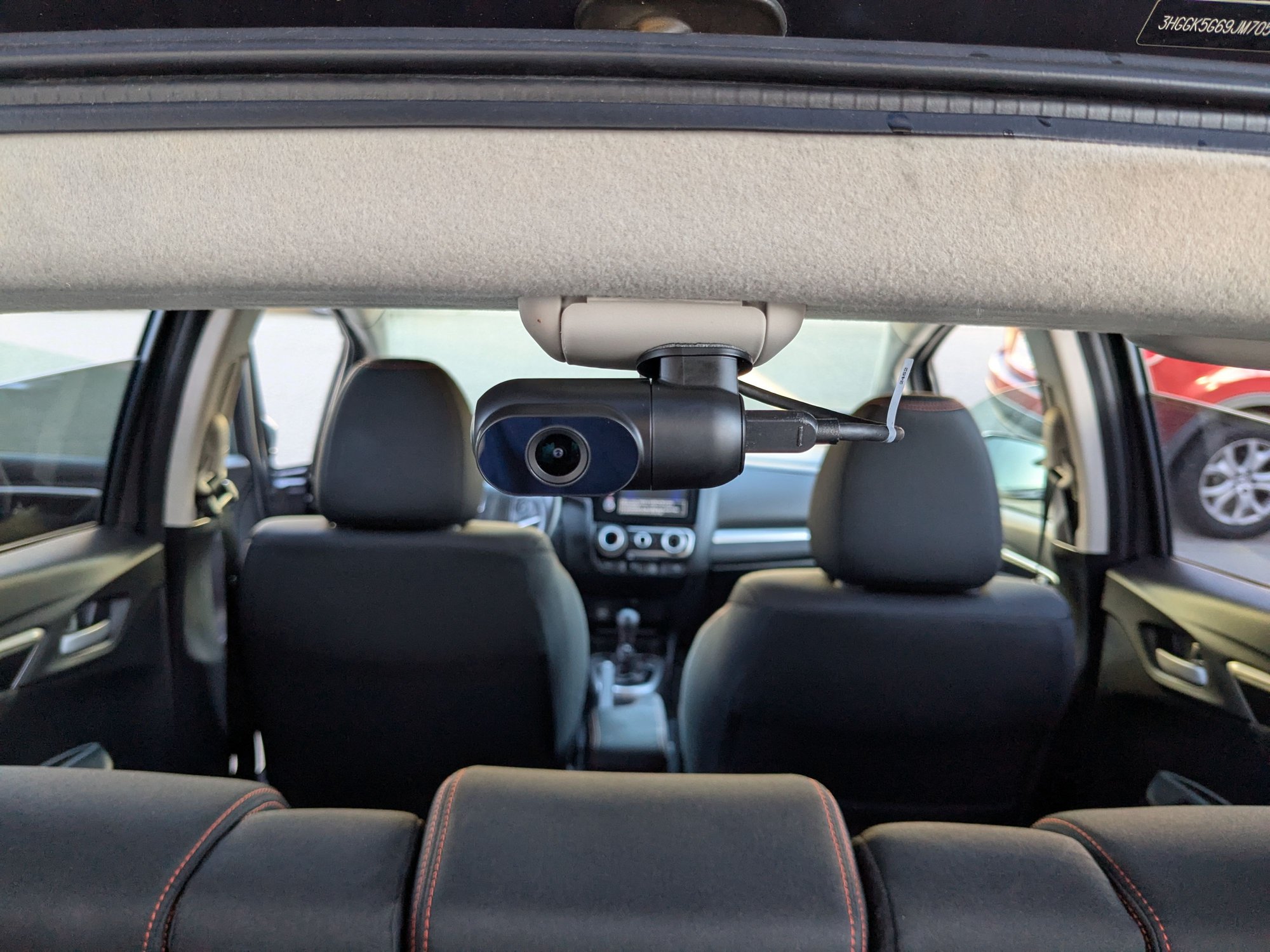

I put mine inside the cabin, just above the rear view mirror, so that it faces rearwards and includes the drivers seat in case of a break in. Also it came in handy when someone backed into my drivers mirror.

No. I had a rear camera that I installed inside the cabin. If you get side swiped, a front or rear camera will totally miss that. Anyways, I don't have the Fit anymore. I installed my cameras the same way in my Accord. I have some extra dashcams that I will install a front facing one for the rear.

I can't imagine having the rear camera inside the cabin in position of the rear view mirror capturing a lot of details behind the car.

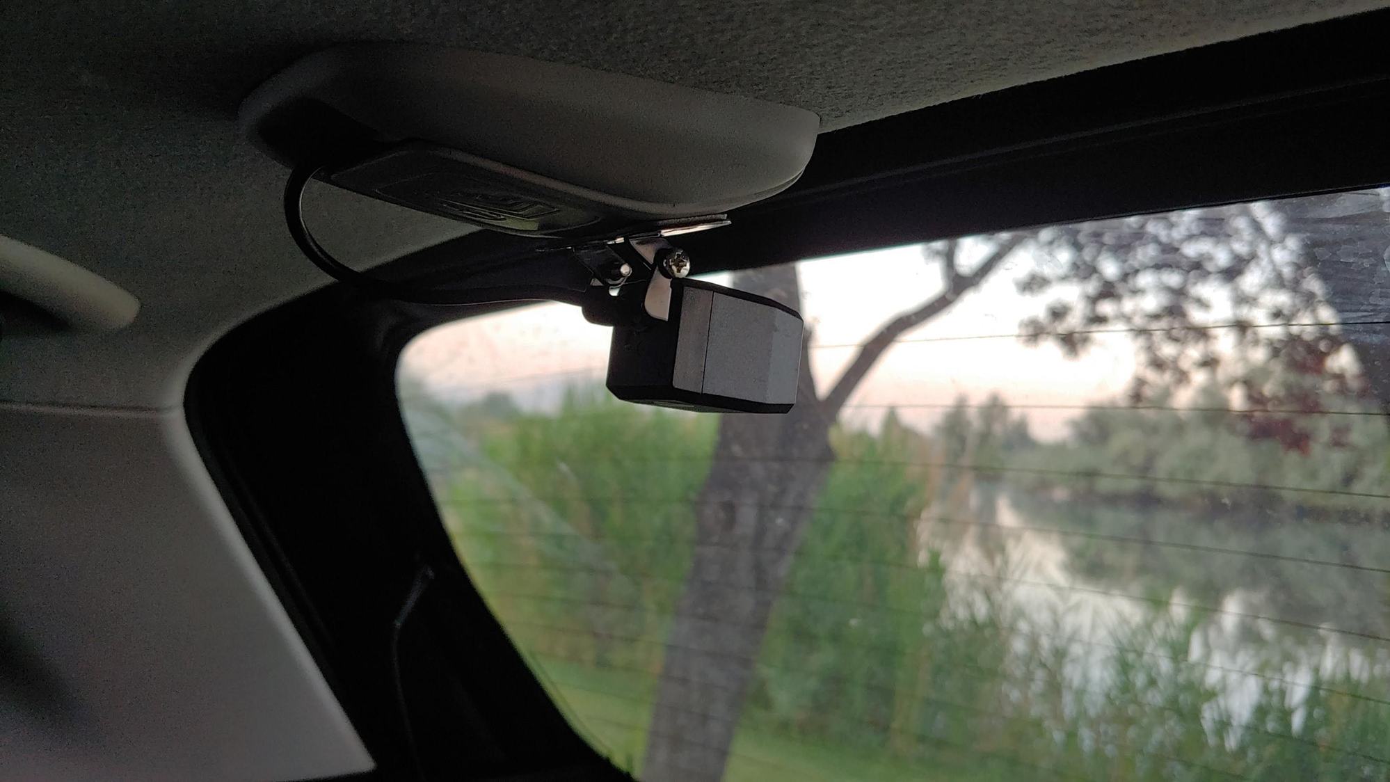

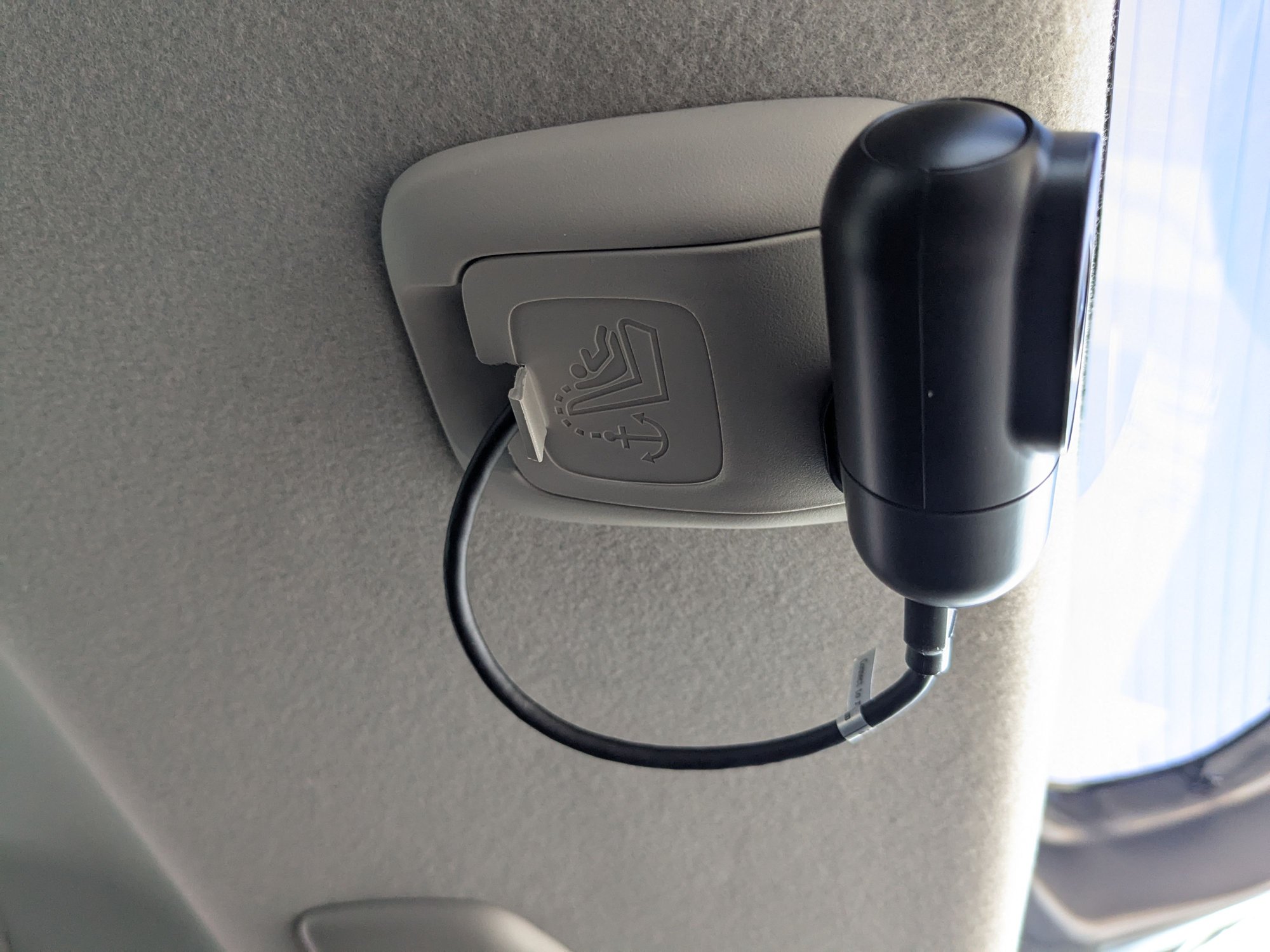

I don't have any pics of how I ran the cable to the back in my Fit.. but I ran it down the passenger side of the car up over the doors, then through the cargo area side panel, then up through the headliner and out through the car seat anchor point in the roof. I just used the adhesive that came with the rear camera to stick it to the plastic cover over that car seat anchor point. It's been installed since Jun 2021 and hasn't had any issues with falling off. It gets bumped every so often if I'm loading a lot of stuff in the back, but still holding on strong.
I did pop off one of the a-pillar covers to run the cable. It has an air bag behind it, so it has the kind of clips that break in half if you don't take the cover off correctly.. and mine did break and hasn't been replaced yet, so the panel sits a little off (you can see it in the pic below), but hasn't been a big deal yet. I did find replacement clips on AMZ, and some day I'm sure I'll get around to fixing it. This car is generally only used on weekdays for commuting to work (~45 mins each way) and rarely has any passengers, so I haven't been super worried about it.

Appreciate the detailed reply and photos!
Hadn't considered mounting it on that anchor point, but your set up looks good!
