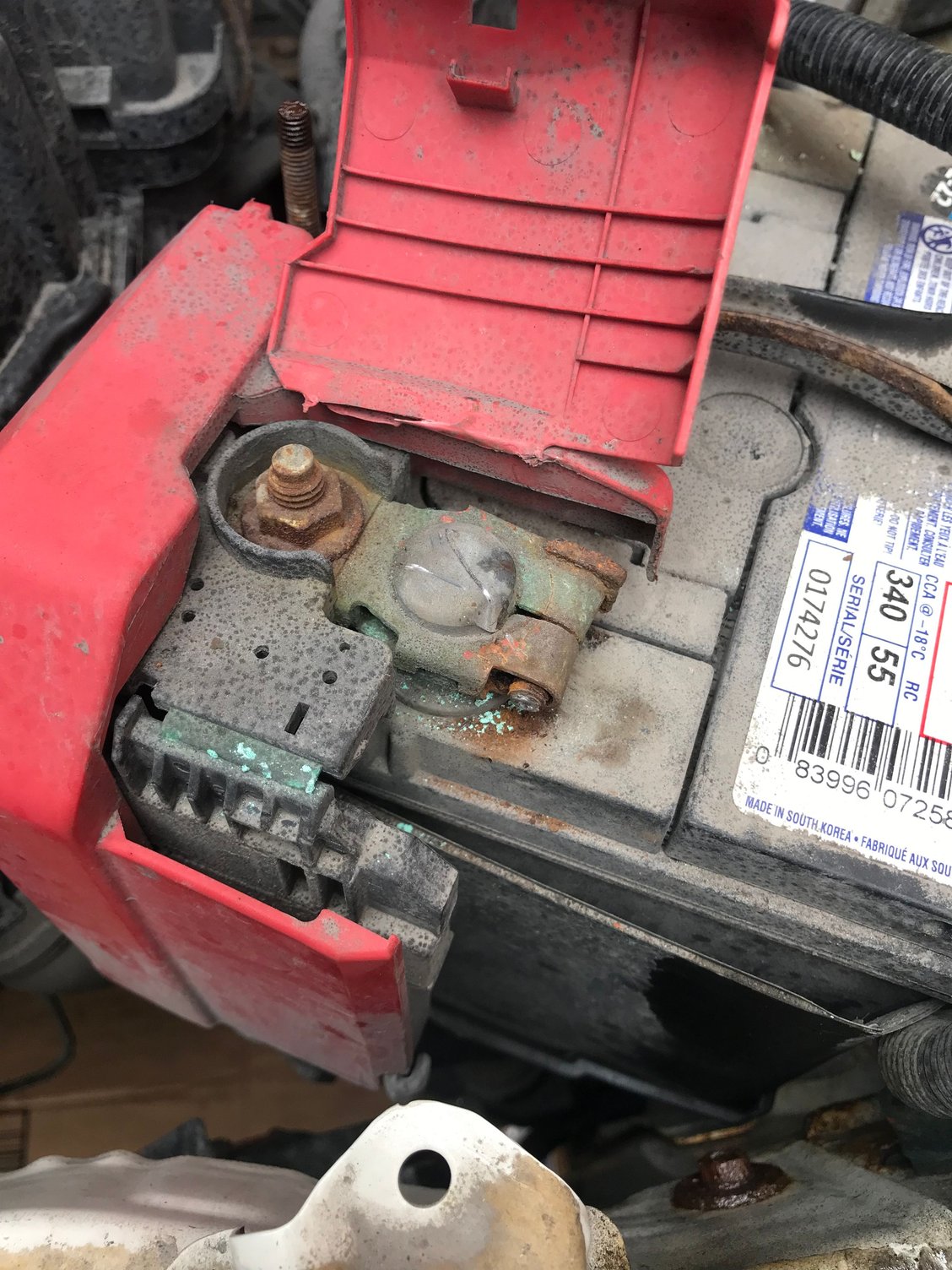

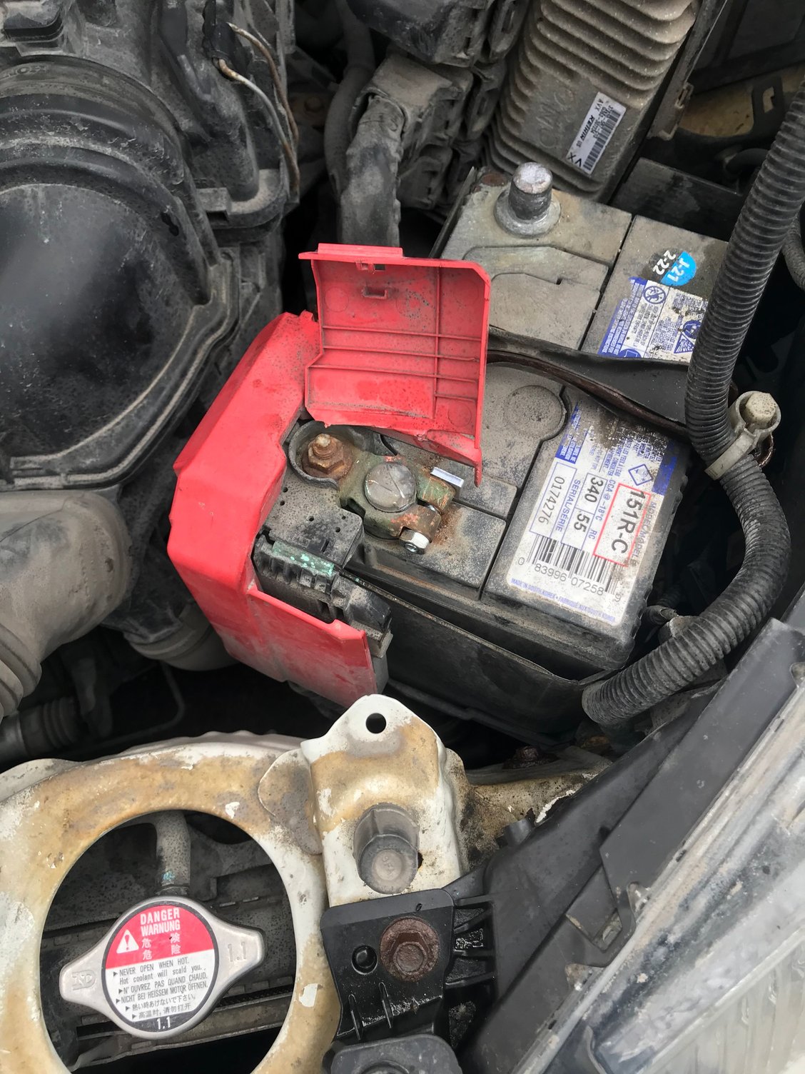

turns out if you drive without an undercover, a lot of bolts rust out. Trying to remove the positive, it just snapped with little effort.
is this just a screw with a square end? I could just get the screw at a parts store? Can the whole clamp be replaced and added to the wire harness?

The square end on the bolt is just there to keep the bolt from turning when you tighten - or loosen - the other end. It's not really required. An ordinary bolt/nut of the right thickness and length will do as a replacement. I suspect the original bolt snapped because you have been over tightening it, combined with the corrosion I see which indicates you haven't been lubricating that clamp/terminal to protect it from the corrosion which would weaken it..

this is a car I purchased a few weeks ago so I’m pretty much stuck with what I got. I was going to try and remove the battery to see if I could remove the rad cover without taking off the headlights but it seems that it might have had to do it anyway. I gave up on trying to repair the snapped bolt because of Honda’s design choice that you have to take half the car apart to access the radiator fan.
went to the part store and they didn’t have the bolt I needed, but they did have a replacement battery connector with the right bolt in it for 5$ so I just bought the kit and used the bolt. The last owner cranked the terminal down so hard, it left a deep impression in the terminal. I might eventually get back in there and try to clean it up better but at least I now have a good contact. Thanks for all the help!

thanks woof. Yes, I’m doing the best I can with what I’ve got. Honestly, the car runs well. Good idle, AC works, paint is bubbling and pealing on hood and bumper though so I have to address that this summer.
you are correct that the battery was waaay over tightened. The positive post has a deep imprint of the terminal connector. Don’t see why someone would do that. I have since replaced the bolt as shown in a picture above. Had to buy a kit (5$) and throw away the clamp; the replacement screws at the parts store were all too big.
