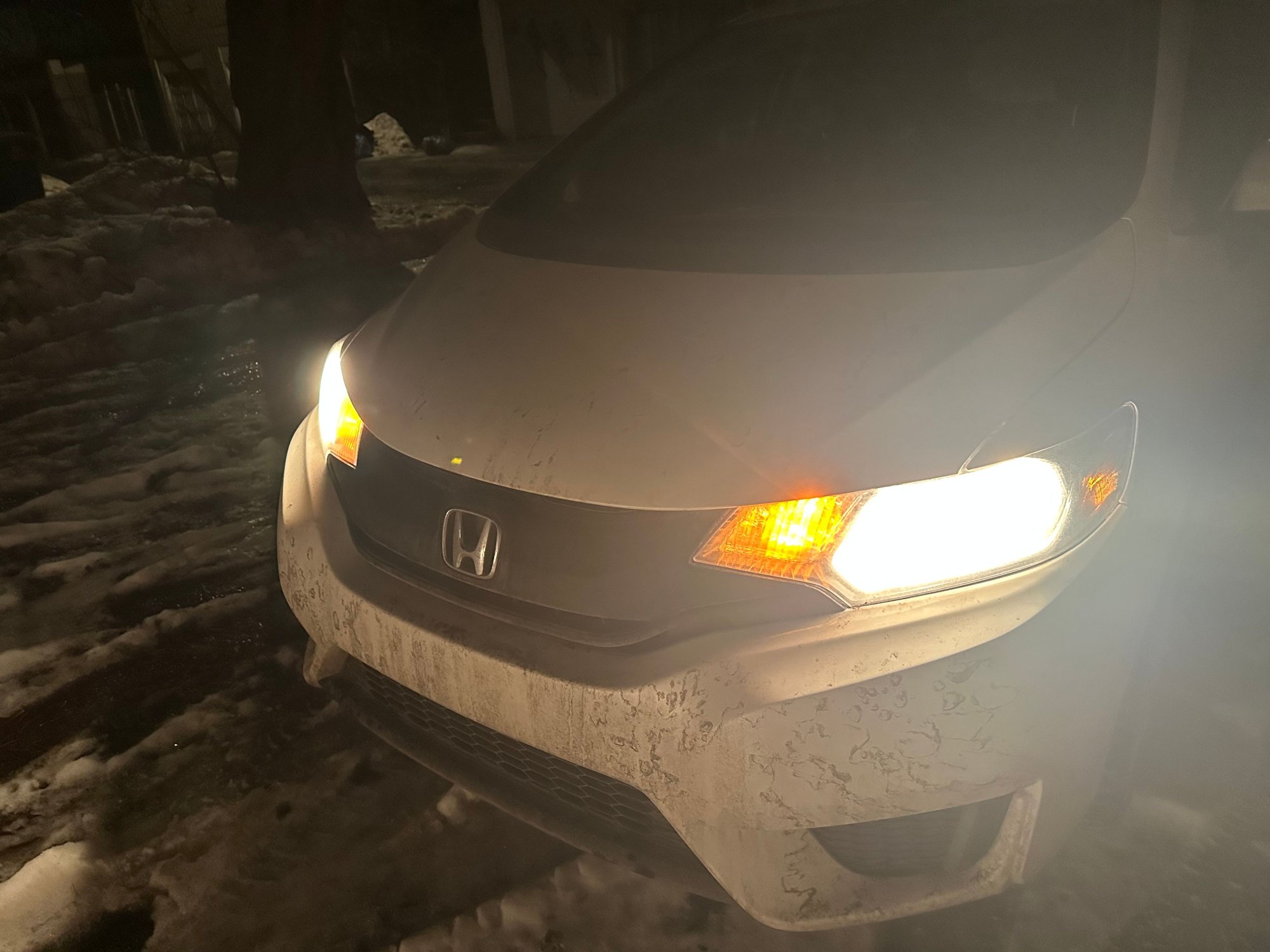

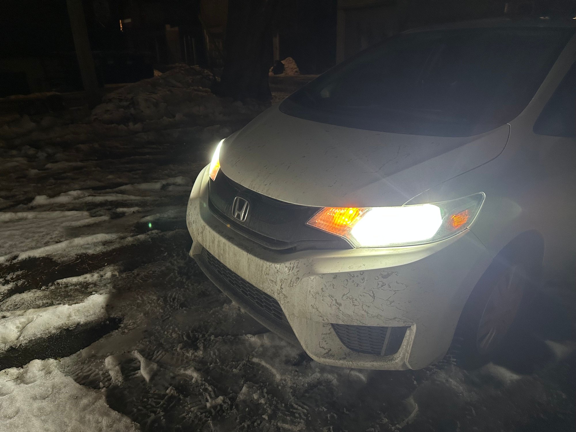

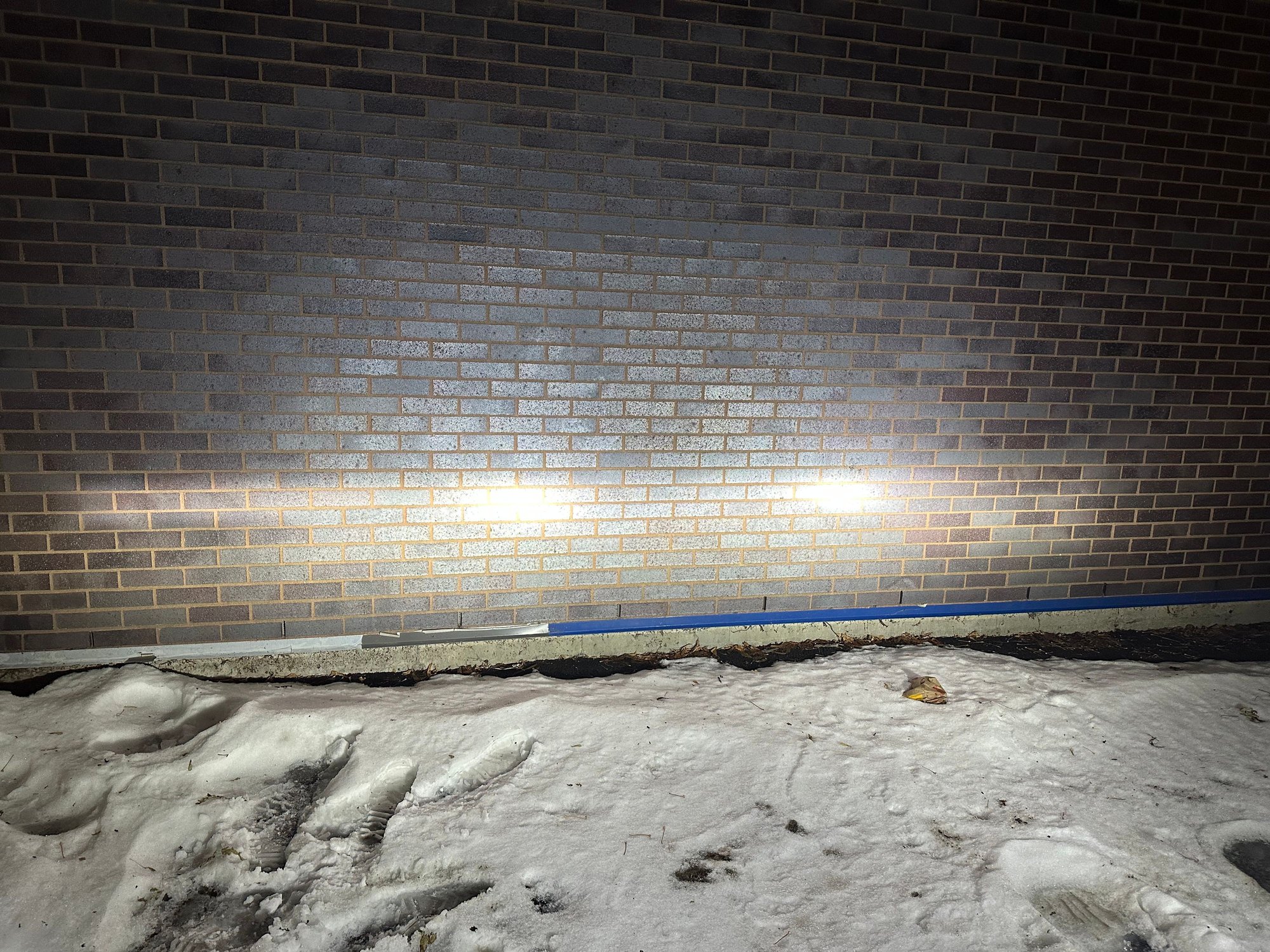

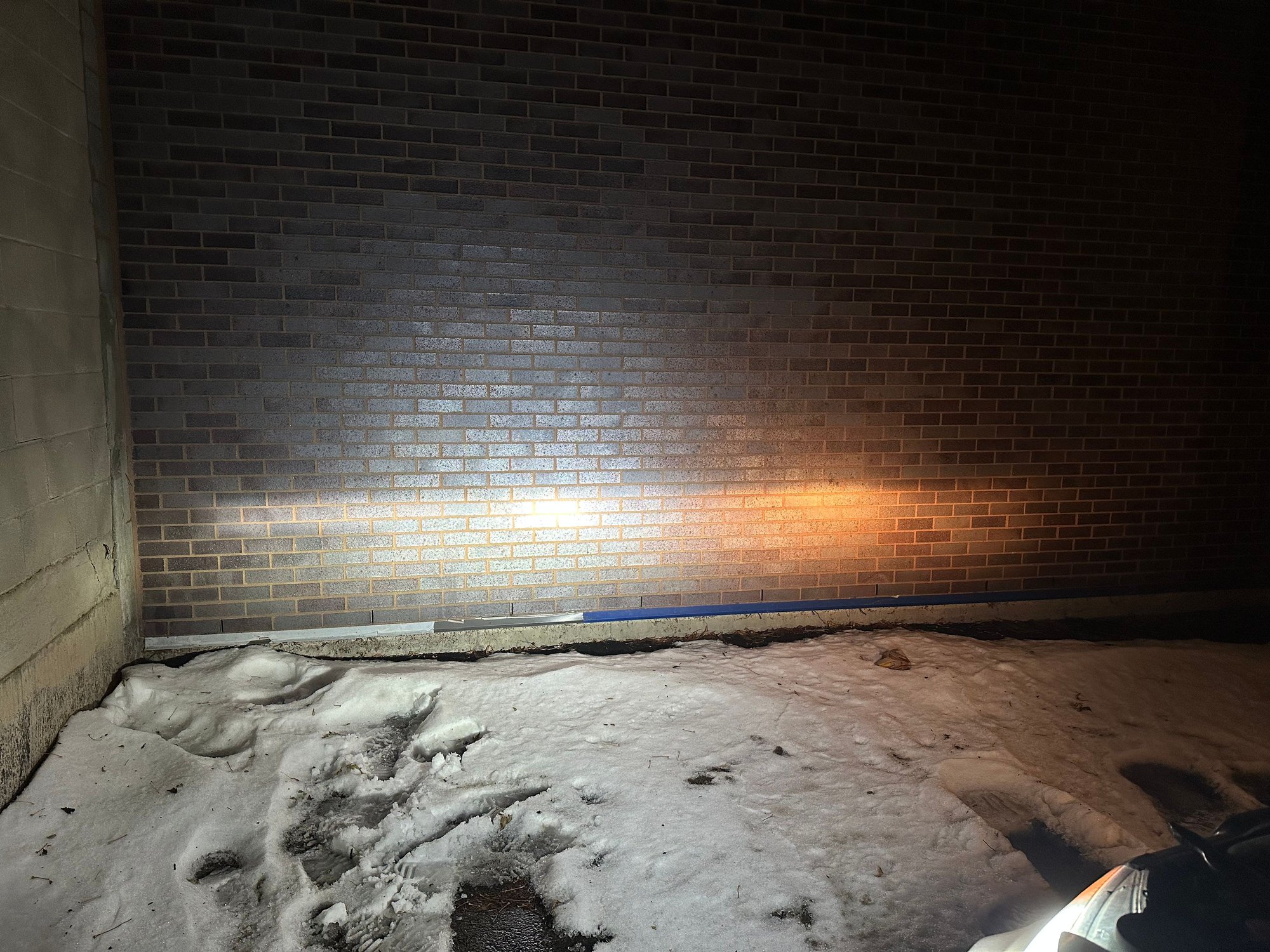

Following Chitown’s post, I bought some Sealight Scoparc LEDs and installed them in a random alleyway at night.
required tools: flashlight, pliers to remove rubber boot for the first time, clean disposable gloves.
The scatter is very similar and the auto adjusting of my phone camera doesn’t do the new headlamps justice. I didn’t feel like I needed to adjust the headlights down and I agree with Chitown that the scatter pattern is quite similar to stock, only the light is at least 3 times brighter (subjectively). Once the snow clears, and I find a nice flat surface, I’ll do a proper headlight beam adjustment but pretty much drop in and go.
took me about thirty minutes because I took my time installing one bulb at a time and taking pictures plus checked my oil level while I was in there.
