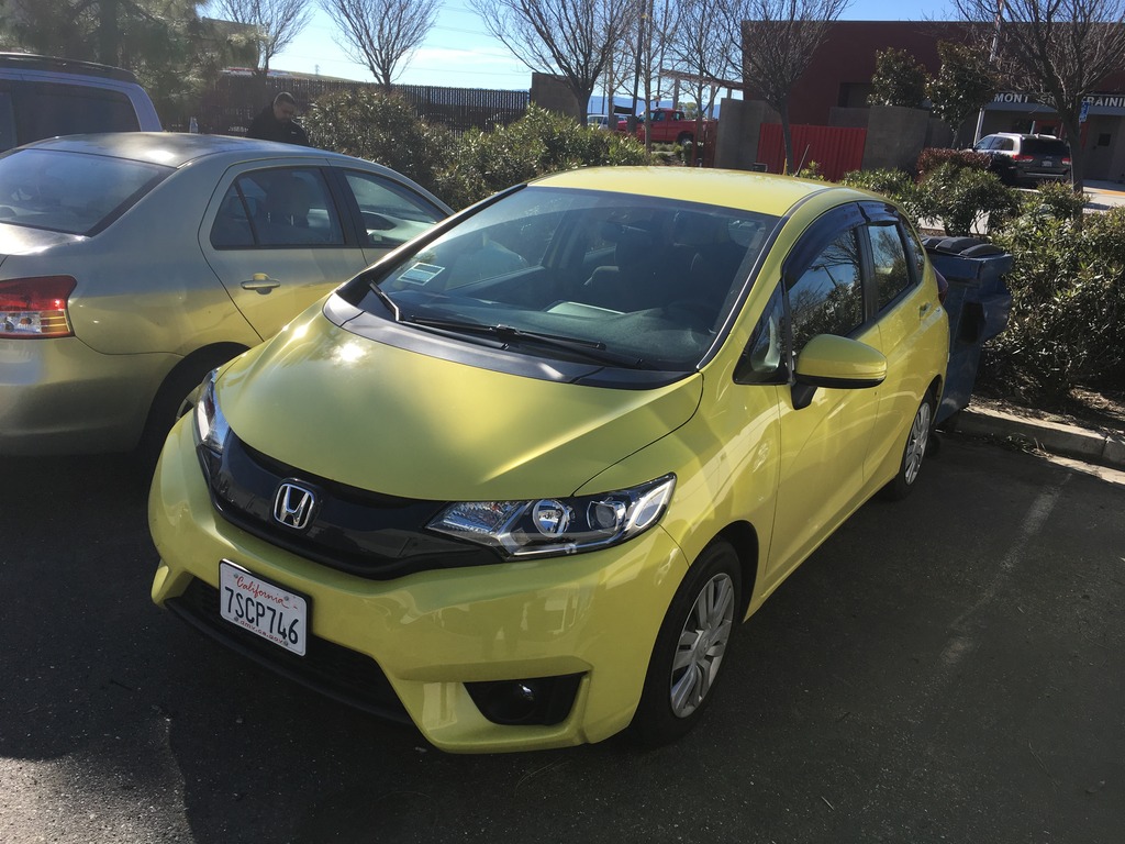

Originally Posted by Noodler
jdm headlights
Looks good. Also wondering about how you did the wiring.

Originally Posted by galaxy convoy
Any info on how to install? Im guessing wiring is not plug n play
I made a plug and play harness adapter.
Only thing that isnt working is having high beam on at the same time with the low. Since our stock h4 wiring switches power from low to high for the high beam its a little tricky to keep both on. maybe with the use of diodes i can keep the lows on. But its so much brighter i dont see the need for highs so wont be venturing into the diodes anytime soon.
The costly part is the connector plug and pigtails for the LED unit from honda. costs over 120$
