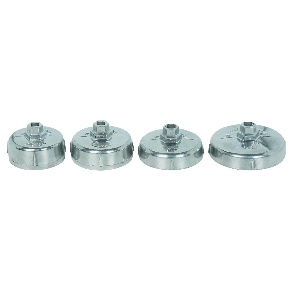

And make sure you have the right size filter wrench before you start! I found 65mm to fit perfectly, but I had a 67-to-65mm universal wrench that didn't work out, and I found that out after I drained the oil. I had to borrow a car and go to the store which made a 15 minute job into a 2 hour job. Why? Because I'm dumb. Be smarter than me.

I prefer this style of cast aluminum wrenches to the stamped steel variety. They seem to have a better fit on the end of the filter and don't slip as easily

GeorgeL it was actually your recommendation for the end-cap style wrench that pushed me in that direction. I had one of those band-style wrenches for my old mustang and it was a PITA to use. Though I will say, I opted for the stamped steel. It was $6 and fits nice and snug.

The quality may vary on the filter wrenches and there may be drawn steel ones that work well. I actually found my cast aluminum wrench sitting in the middle of the street. It probably got stuck on the filter and forgotten by its previous owner.
To avoid getting the wrench stuck on the filter I tighten the filter per spec then reverse the ratchet and apply a little opposite torque to just break the wrench loose without turning the filter.
