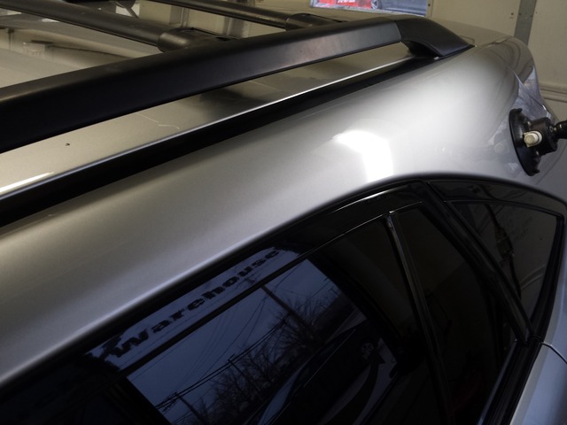

NEVER DO THIS! this is the worse thing you can do to repair a dent. You will destroy the metal's memory causing even more damage. in the video, you can see the panel is wavy at the end. This ends up causing a "oil can" effect will even be difficult to repair using traditional body repair. It stretches the metal and will sound like a Snapple bottle lid.
also the Ding King repair kit you find in stores will move the metal, but without proper training, you will not get very good results. It is a waste of money and a poorly designed tool. The idea is correct but the actual tool causes more damage then what you started with.
I am a professional Hail and Dent tech. I work on nothing but dents about 50+ hrs a week. I am contracted out to Bentley, Rolls Royce, Audi, BMW, Maserati, Lamborghini, and Ferrari dealerships.
For your own sake, NEVER attempt to fix a dent yourself, you'll just end up making it worse, and more costly and more difficult to repair in the long run.
If you have dents similar to what the OP had, understand this, PDR techs are NEVER supposed to drill a roof rail. There are times when you need to drill on a car, but you never drill a roof rail. There is no access behind the dents to push them out properly. The only other ways to repair the damage is to use a glue pull system or induction method. (induction is very new an not used much yet, due to cost and training)
OP, the pricing is about right for your area, but he shouldn't have drilled anywhere on your car for these particular type of dents. Make sure there is touch up paint and a properly sized plug to prevent future corrosion.
@UglyEd on instagram if you want to see some of my previous repairs.

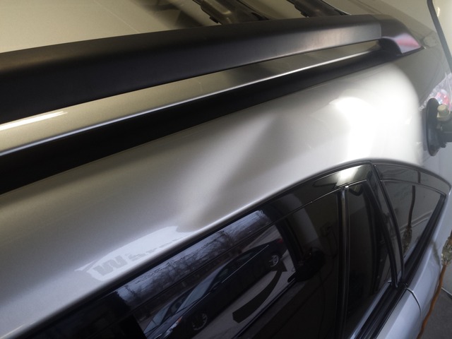

here is a GE fit that I repaired for a buddy from a Thule roof rack tower, they overloaded the weight capacity.

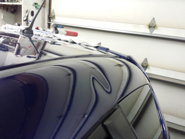

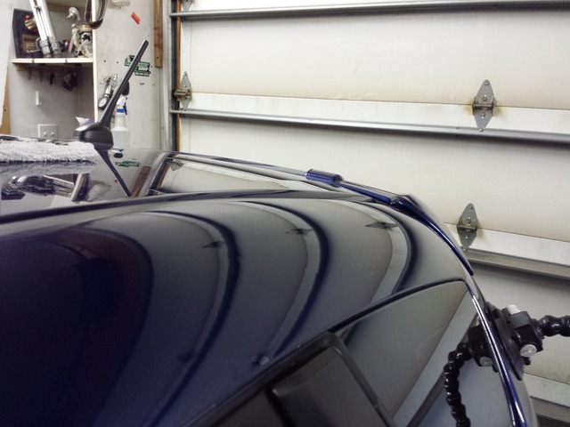

here was a GMC Envoy I did as well. Even worse than the OP's dings. Roof rail damage, no drilling, glue pulling only.
