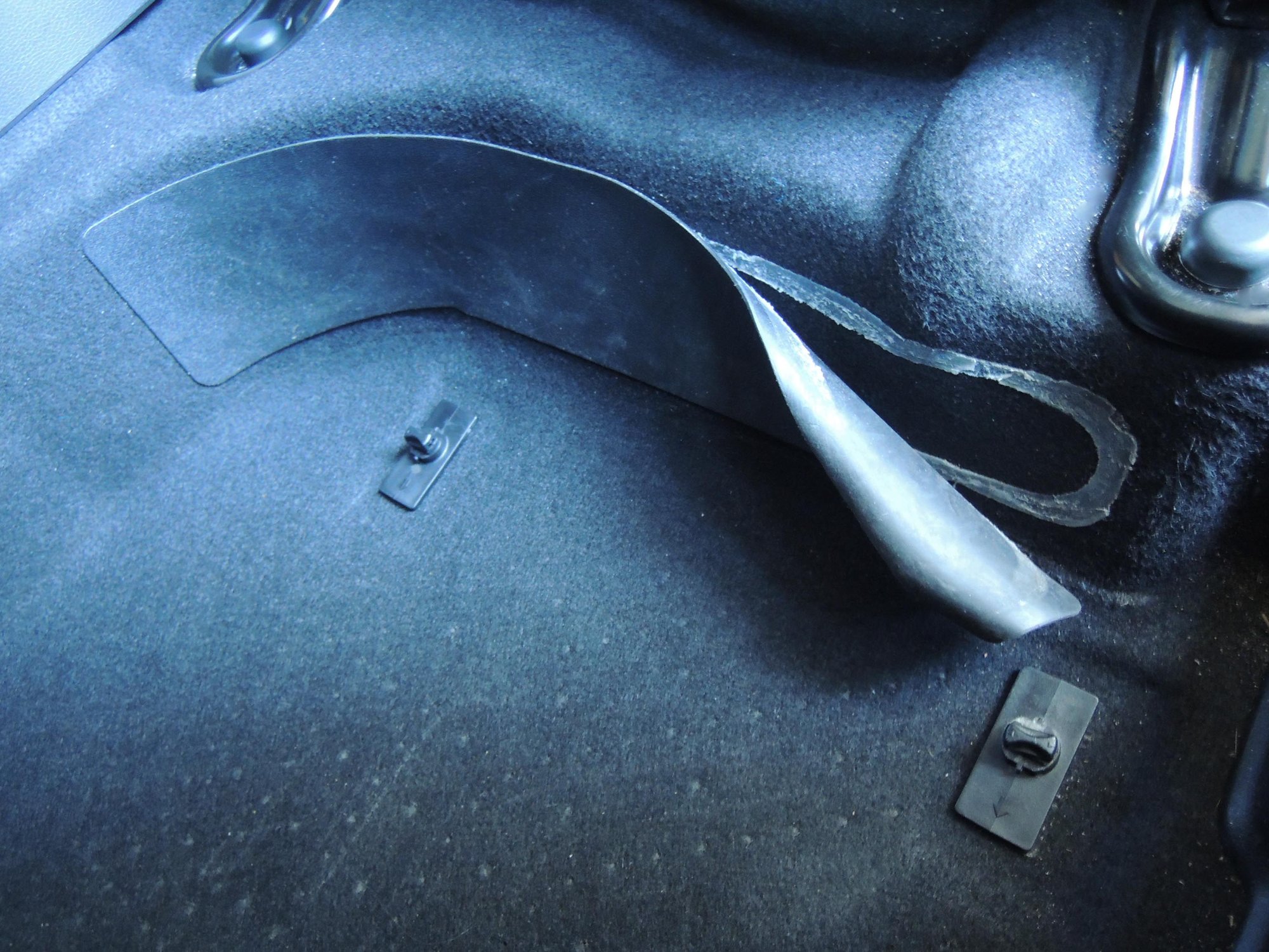

You can see in my previous posts how I tried to effect a detached molding repair with 30 lb double-sided adhesive tape. It looked bad and peeled off cleanly after 1 hour, so at least I could easily start again fresh. Here is the original problem:
Prior to my second attack, I installed WeatherTechs to more or less tack the flapping moulding back from underfoot:

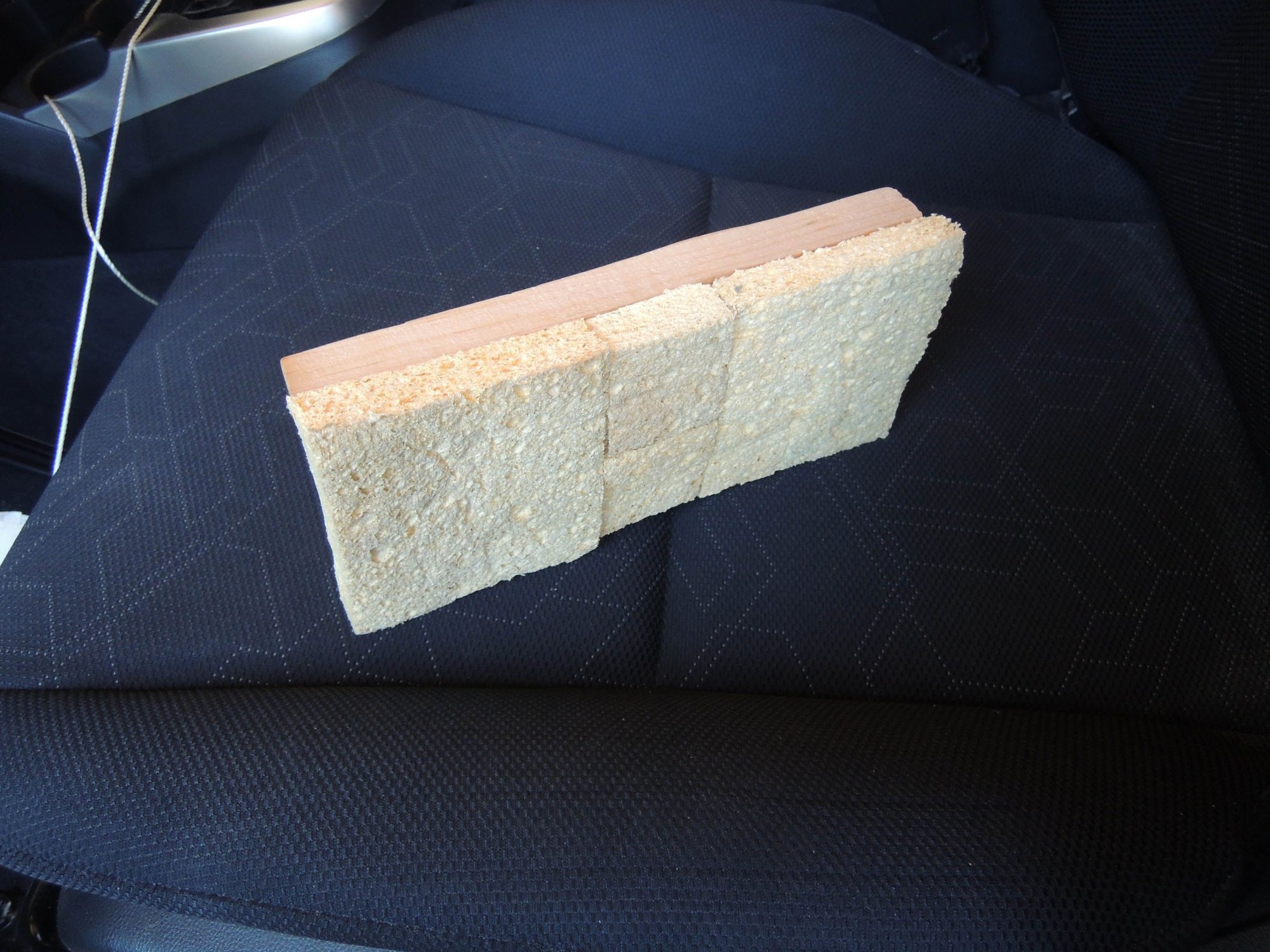

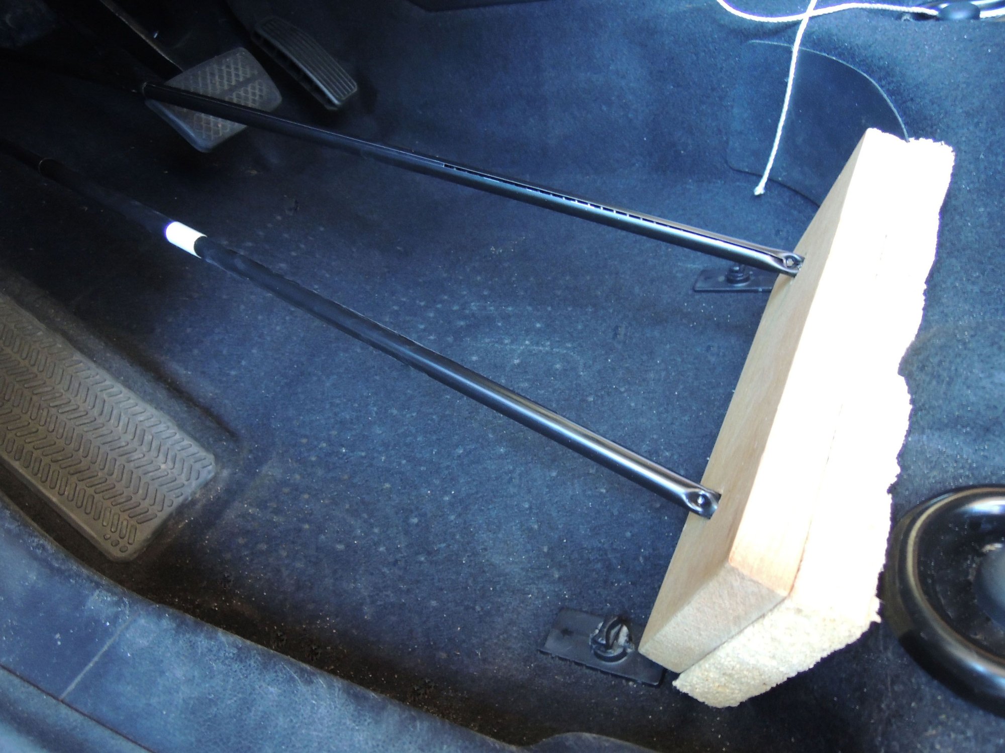

Before applying the contact cement, I made a padded, dimpled push-block system with Elmers wood glue, junk wood and sponge and my countersink, and two small adjustable curtain rods.
I let the contact glue dry, as instructed, for 20 minutes and then carefully sandwiched everthing together by bracing the pre-adjusted curtain rod ends between the push-block and the fire wall, allowing it to sit for 24 hours.

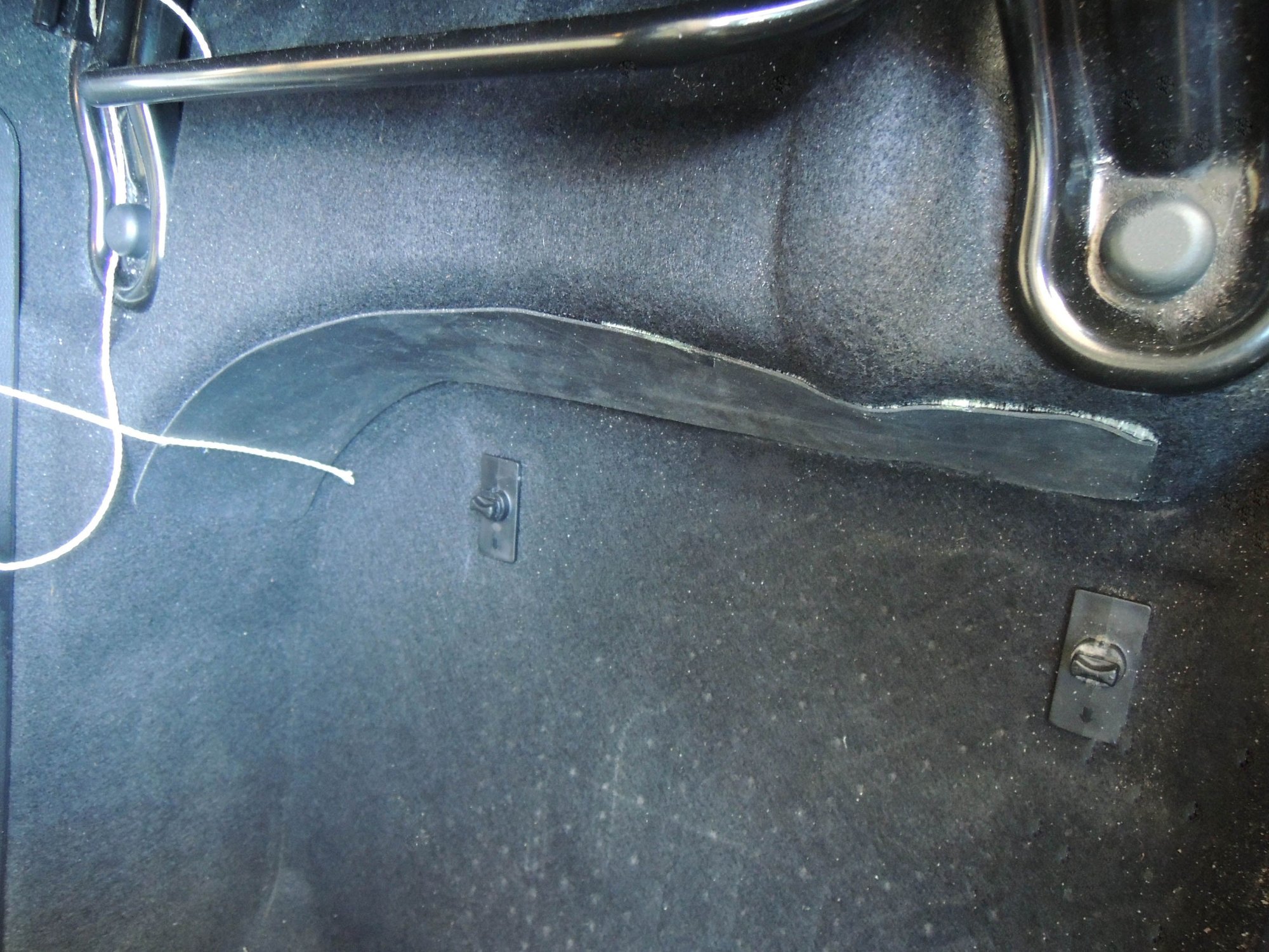

Basically things worked out and the molding has remained attached. As you can see from the following views, the push-block did not provide quite the contoured, evenly distributed pressure I was shooting for and the very edges of the molding rolled back a bit. I got a non-volatile Crayola washable marker set and used the gray pen to tone down the exposed contact cement "fibers" stretched and exposed along the top margin. If further peeling occurs, I will use the same approach involving just the separated edges, and metal bars to more aggressively pin down those pesky, truant edges of the molding. I consider the WeatherTechs as part of the solution since the high lip does much to protect the molding from a driver's heels and other mishaps.
