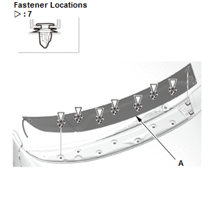

Hood Trim Removal and Installation
NOTE
Applicable vehicles:
  • 2015-16 Honda FIT
Removal/Installation
  1. Hood Trim - Remove
  1. Disconnect the windshield washer tube (A).
  2. Remove the bolts (B).
  3. Remove the hood trim (A) from the passenger's side
  4. Remove the hood trim (A) from the driver's side.
  • All Removed Parts - Install
    • Install the parts in the reverse order of removal.

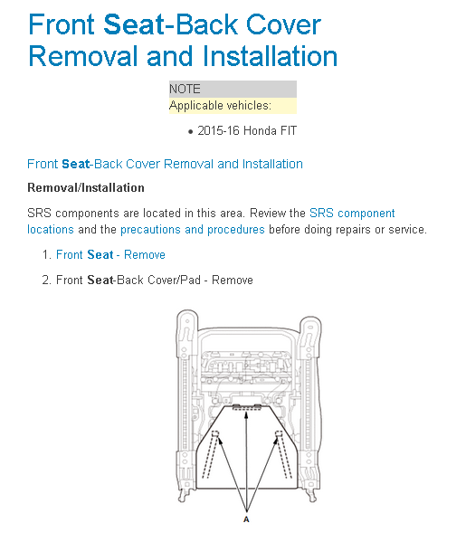

Front Seat-Back Cover Removal and Installation

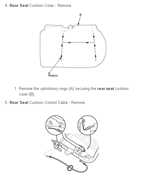

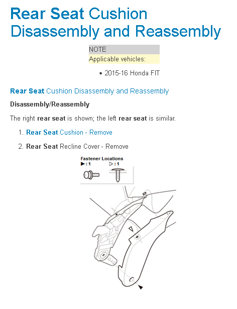

Rear Seat Cushion Disassembly and Reassembly

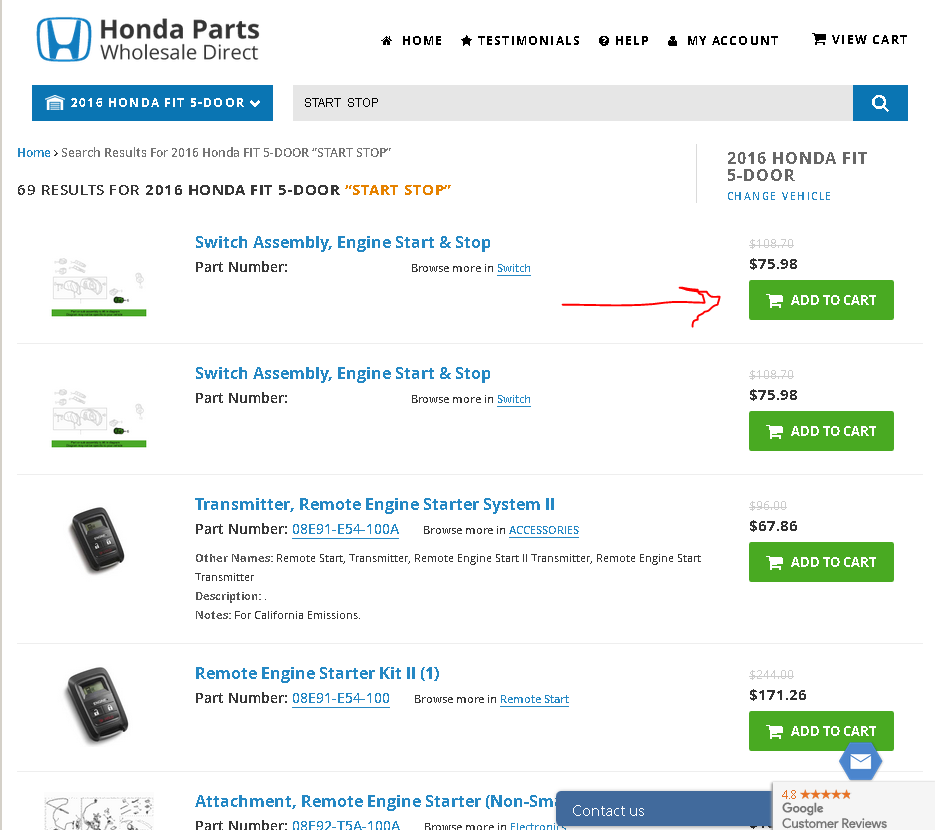

Hi evilchargerfan. Do you know the part number of 2016 fit ex start/stop button? Can I have it? Thank you.

I can do better. I'll TEACH YOU how to find it:
Go here ---> https://www.hondapartswholesaledirect.com/
Follow the next steps:

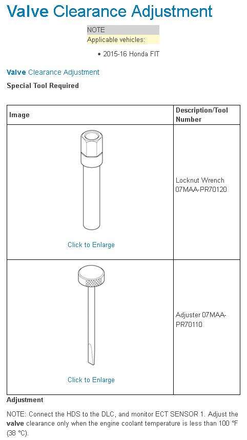

Valve Clearance Adjustment

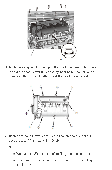

Cylinder Head Cover Removal and Installation
