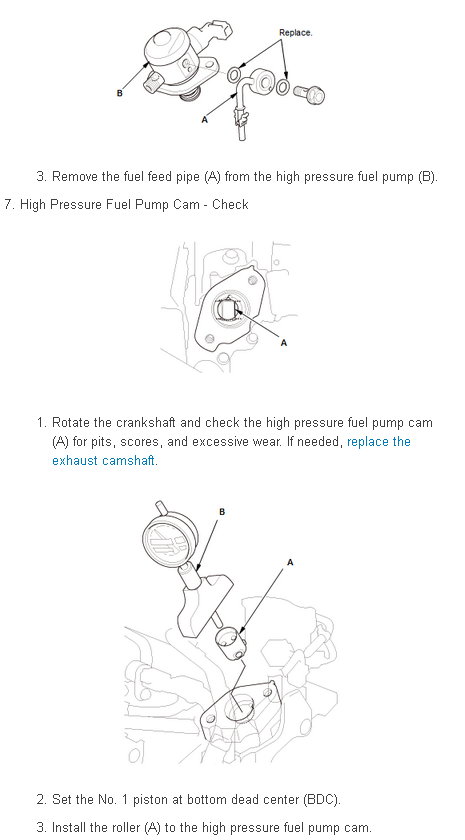

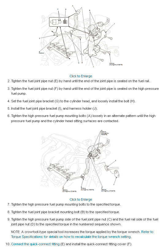

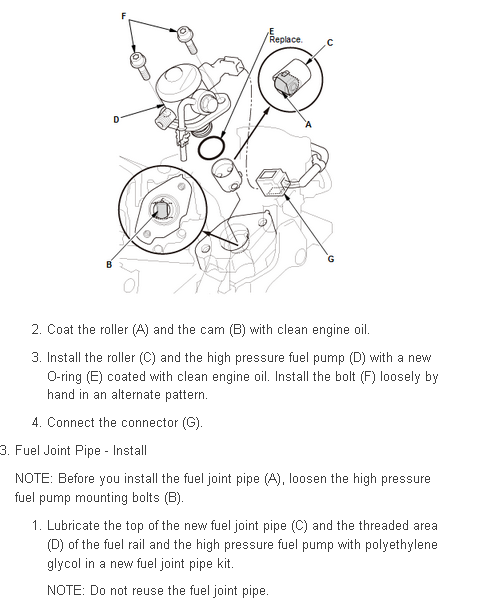

High Pressure Fuel Pump Removal and Installation

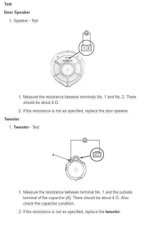

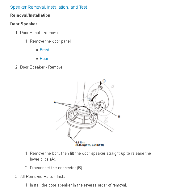

Speaker Removal, Installation, and Test

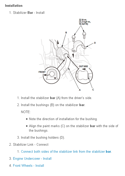

Front Stabilizer Bar Removal and Installation

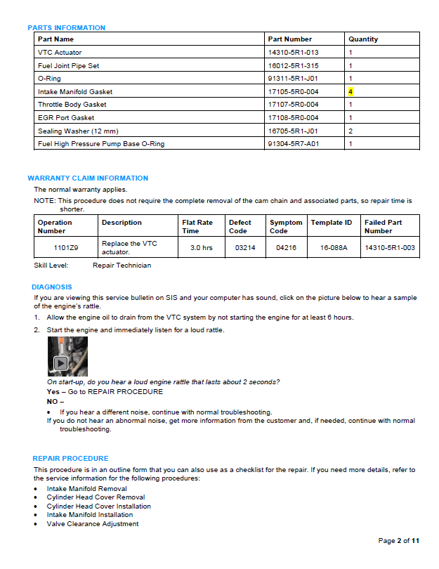

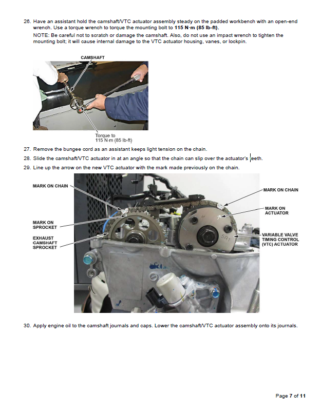

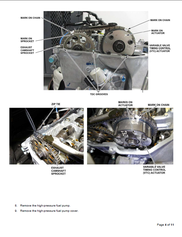

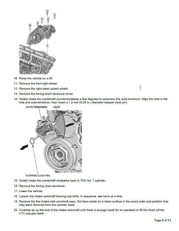

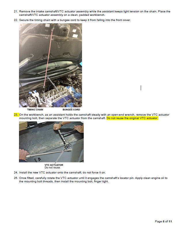

TSB A16-088
SERVICE BULLETIN - AT COLD START UP, THE ENGINE RATTLES LOUDLY FOR ABOUT 2 SECONDS. THIS MAY BE INTERMITTENT AND OCCURS ON COLD STARTS WHERE THE ENGINE TYPICALLY HAS NOT BEEN STARTED FOR 6�8 HOURS. THE VARIABLE VALVE TIMING CONTROL (VTC) AC
https://testing-public.carmd.com/Tsb...118695/A16-088

TSB A16-088
Dang! I've been wondering about this since I purchased! The dealer said It was normal.

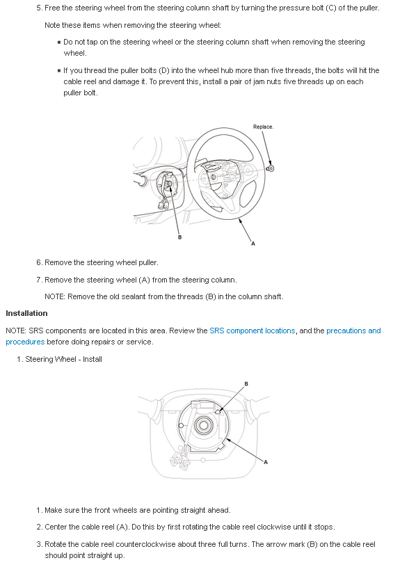

Steering Wheel has been covered, but I'd like to add the manual for more detailed .... details
Steering Wheel Removal and Installation:
Steering Angle Sensor Removal and Installation:
