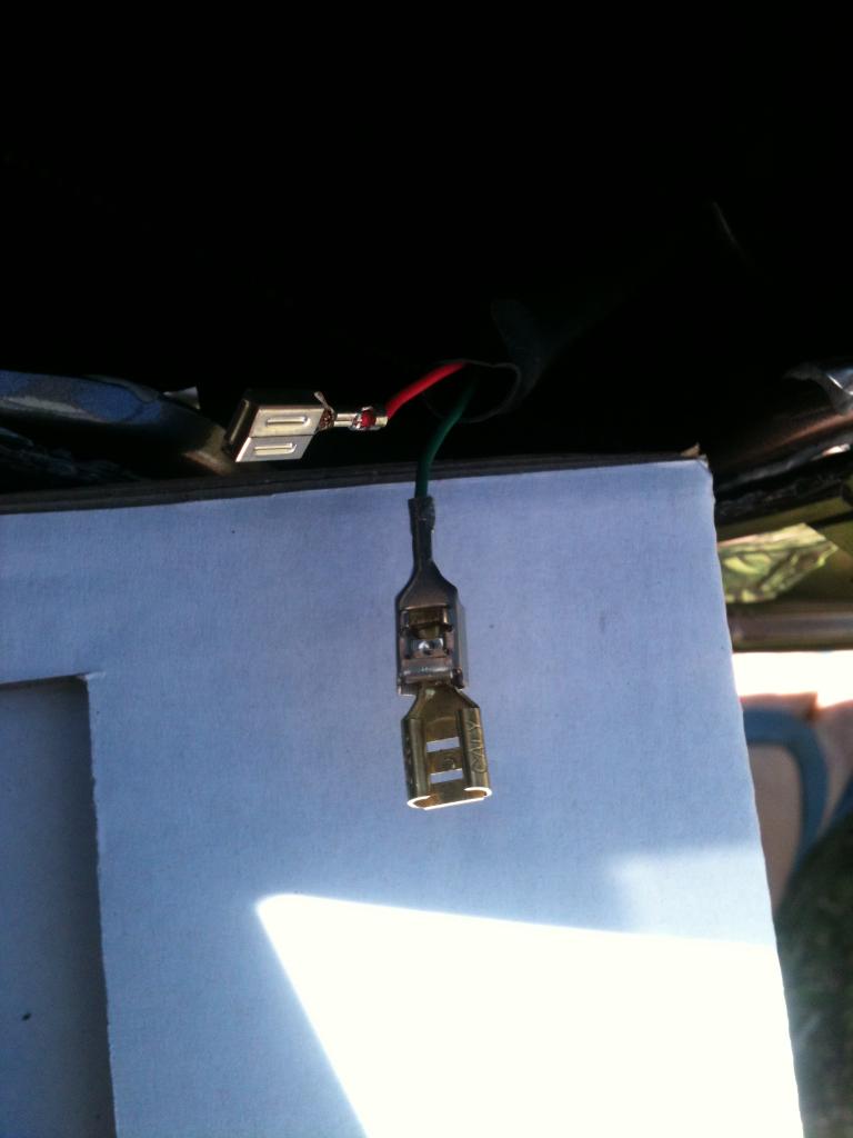

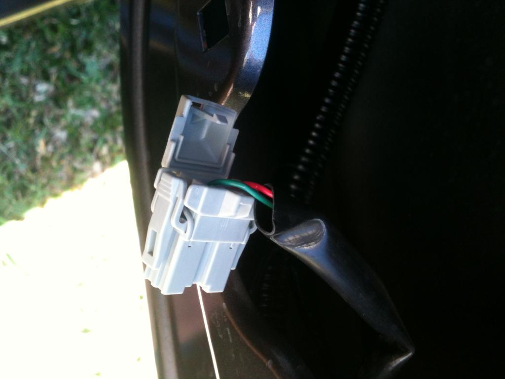

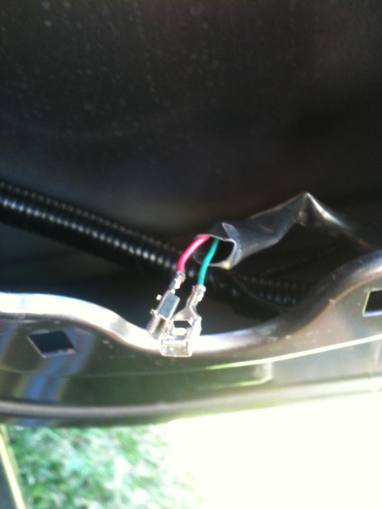

Took some pics of the front door install. You can undo the honda plugs and remove the terminals to hook up the speakers.

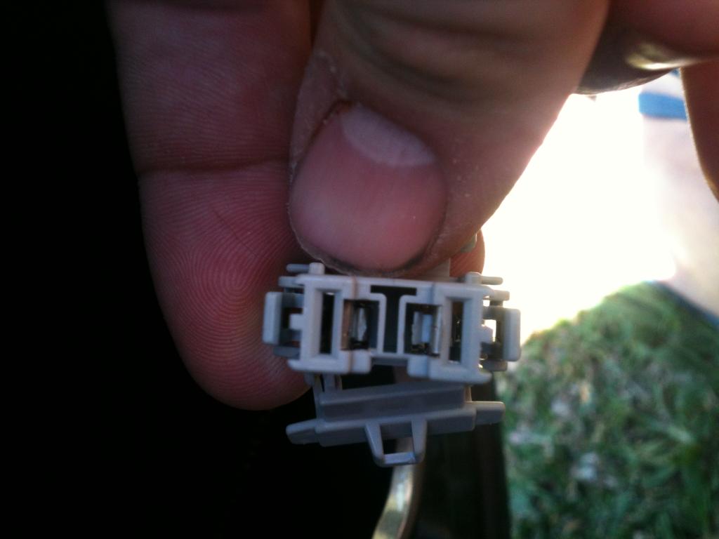

Gently lift the tabs on either side of the T shape in the middle. The one on the right has been lifted. As you are doing this put gentle tension on the plug and the terminals will slide out as they are released.

I just rigged this up as an interim solution until I eventually rewire the speakers from the amp. They were then wrapped in electrical tape. The existing negative terminal just slipped onto my speaker's terminal.
