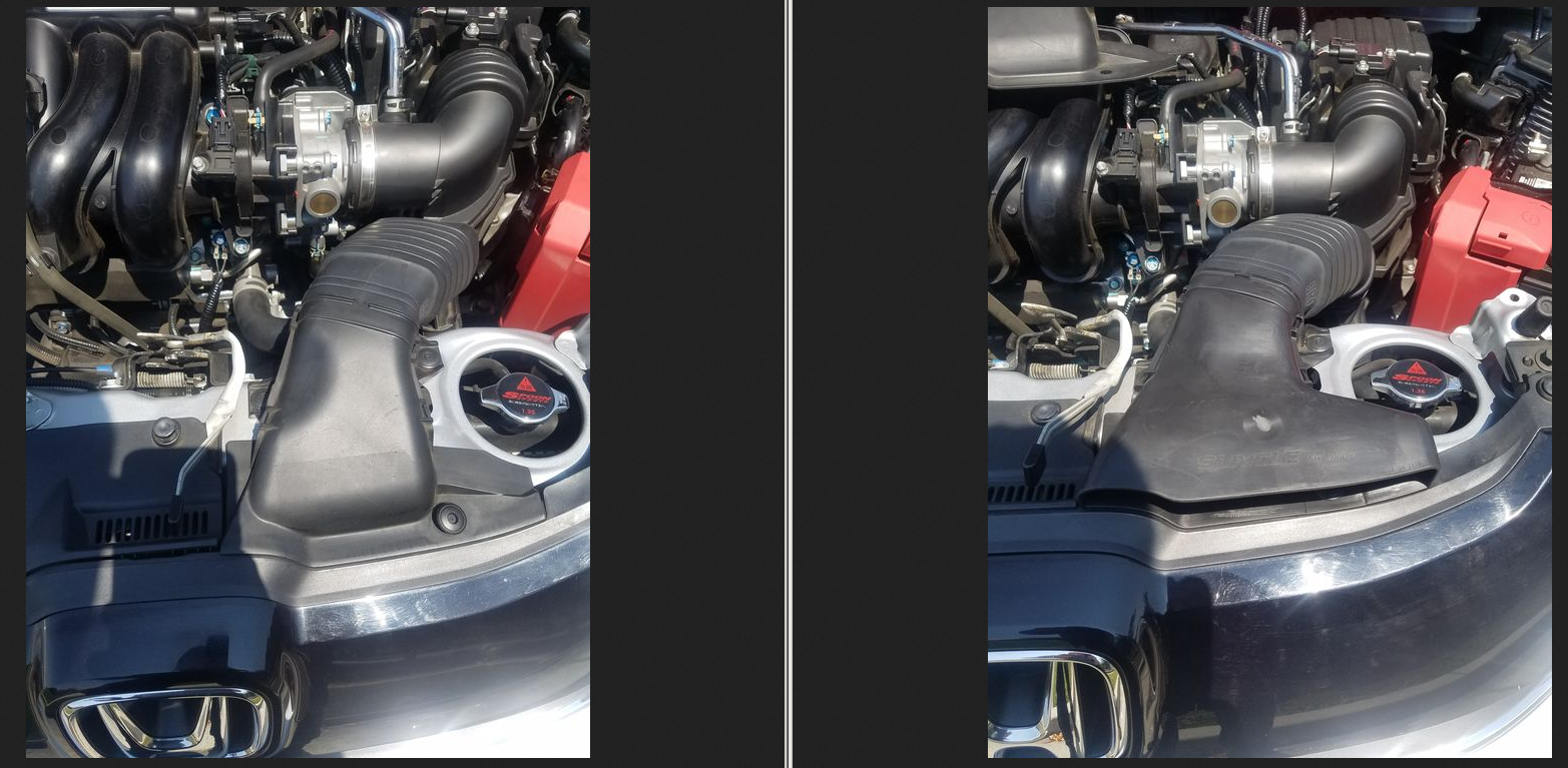

Recent mod, Sumole Ram Air Duct Scoop Thingee:
Butt Dyno says, there is a little more power gained, even if its just a small amount. MPG appears to be worse.... but.... I'll follow up with that with Fuelly data after a few more tanks of gas
