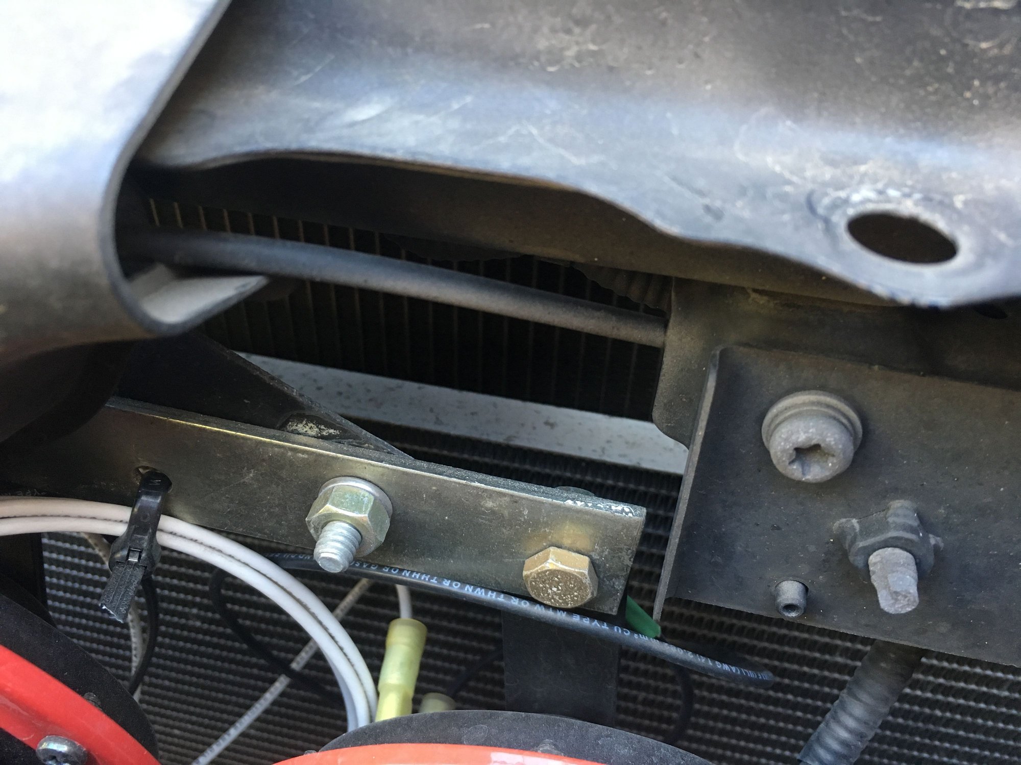

So with yet another Vegas trip on my calendar, I wanted a better horn so I can honk at all the crazy people out there. This is what I went with:
For the install, I followed the College Hills Honda "sport horn" install video:
https://www.youtube.com/watch?v=HDkbJUAItXg
For anyone looking to buy these Hella Trumpet Horns, just a word of caution. Although Amazon says it "fits" our Gk5's, the front horn did require some fancy swapping of the bracket, and reverse orientation in order to make the horn not make contact with the radiator. One thing I am nervous about is the opening of the horn may be prone to taking in water .... as there is no way to orient the opening downward (unless the bottom plastic cover is trimmed). This is something I'll be keeping an eye on

more pics of the hella trumpets, this time, compared to the oems. as you guys will find out, the hella's are THICK
the oem harness being so short, reallyi makes the install unpleasant. it would appear, its not as plug&play as expected, and may required some fancy custom brackets in order to make it fit and rotate to the proper direction (with the opening of the trumpet, facing downward). at this rate, these may seriously come off and I will just go with the Hella SuperTones instead
