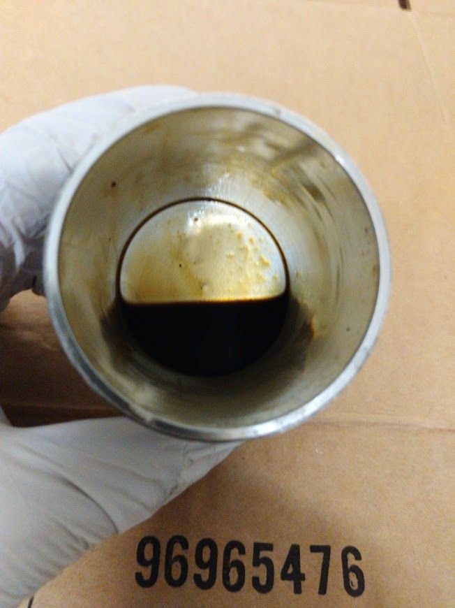

OIL CATCH CAN UPDATE:
08/04/2018
32453 miles odometer = Installed Rick Approved "Catch Can"
08/21/2018
33281 miles on odometer = about 7.5 ML of oil caught, after 828 miles/17 days worth of driving.
https://www.fitfreak.net/forums/3rd-...ml#post1410578
