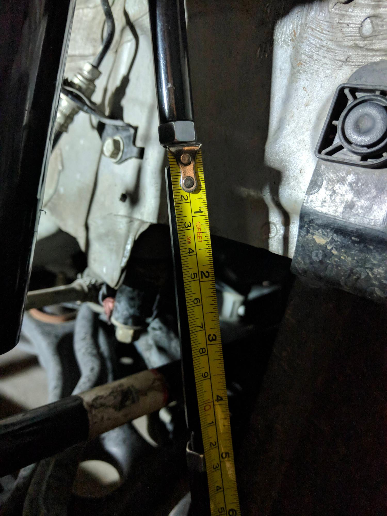

SO ..... coilovers went on last night, well the fronts at least. I'll have to tackle the rears another day, as it was getting late in the evening
Length of the main spring was 180mm, BC coilovers recommend 5mm of preload, so I tightened the top nut until the length came to 175mm
For the drop, I went conservative 30mm distance between bottom locking ring, and middle locking ring
And for the end link, I'm not 100% sure on the proper length .... for the time being I went with 120mm from the distance of top locking nut to bottom one. (if this is wrong, someone please help me out)
thats it for now on coilovers, after the rears go on, I'll dial in ride height some more, and play with camber a bit. impressions will follow .... soon ish

An endlink should basically have the sway bar at "neutral" when the wheels are on the ground, meaning no tension or pre-load on the bar. So the way to set them up is to get them close to proper length by jacking up both control arms (not at the base of the ball joint, you don't want to damage it) so that the chassis just starts to lift off the jack stands. Set the starting length there, connect them to the strut and the sway bar but not final torque tight, lower the car to the ground (or onto ramps to make it easier to get under the car) and loosen or tighten the length so that the sway bar has no preload, then final torque the nuts on the end link. Make sure you jack up both sides equally so that the sway bar is in a neutral position when you do the initial connection.

sigh, so looks like i'll have to put more energy into those endlinks eh. I'm so drained .... this weekend consisted of alot of the following:
-jack up car
-take off wheels
-change ride height
-tighten it all down
-go for a test drive
-come back, rinse and repeat
now I have to do it once more, for end links .... oh joy! *face palm*

Oh - and one more thing about adjusting end links. Remove the sway bar connection on both of them before you adjust. That way the sway bar is not being held in a preload position on one side. At least you don't need to jack up the car and remove wheels for the adjustment, so its relatively easy to do with the car on ramps.

are those even adjustable endlinks? if not wouldn’t even matter cause even if there is tension u can’t do anything about it then.
