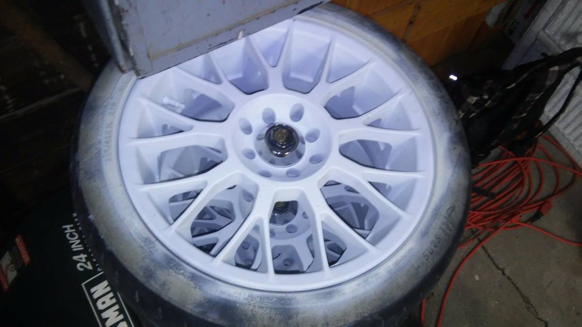

I've been communicating with a guy on Craigslist that is selling a set of 16x8 Enkei tbs-11's. They've got an offset of +38 from what I've read. I don't understand much about wheel offset, and the more I read, the more I'm confused. In order to make these not rub (stock everything, just looking for winter or summer rims) what size tires would I have to buy without rolling my fenders?
Here are pics of the rims just after being sand blasted and primered. Needs tpms and tires.
Edit. Got them on my car with different tires on them. They look great! The problem is they rub a bit but only in the front. they stick out just a tiny bit. cutting the wheel all the way is fine though!

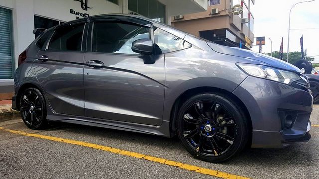

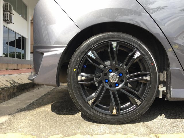

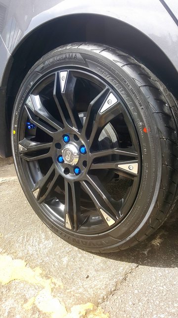

17 x 7 ET 42
I am currently running on 17x7 ET 42 on stock suspensions. (Tires are 205/45/17) On normal drives, there aren't any rubbing or whatsoever. However, hitting a dip at 80-90 mph proves otherwise. I believe the tires are hitting the fender arches. I am wondering if adding a bit of negative camber would resolve this issue.
