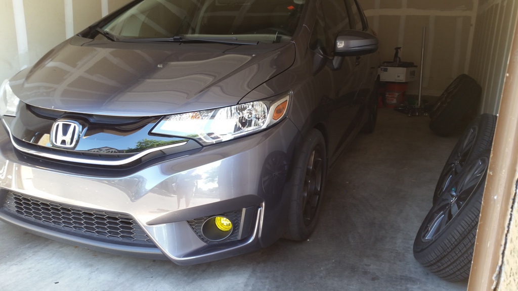

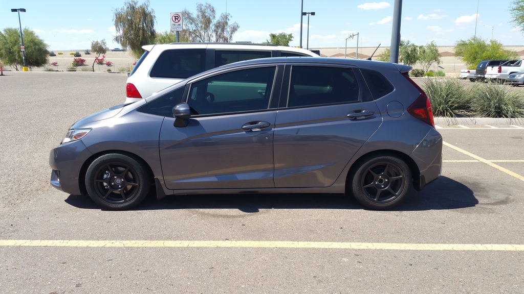

I'm running 15x7 +38 kosei k1s with 205/50/15s, the fronts stick out a bit but my suspension isn't low enough to where it would be rubbing. I wish they were to fit as good as they did on my GD3, but different car different fitment.
