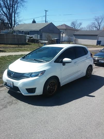

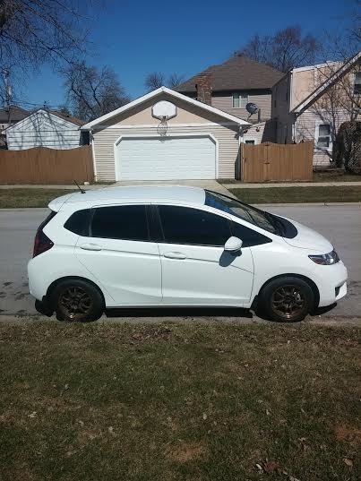

Old Mar 28, 2015 | 01:26 PM
Adam_Melton's Avatar
Joined: Feb 2015
Posts: 8
From: Chicago
No one had them in stock, I got lucky and found a set 40 miles from me reaaaaaally cheap with some like new 205/50/15 Dunlop Direzza Z1 tires already mounted and balanced.
No rubbing, but I'm also not lowered. +45 offset.
