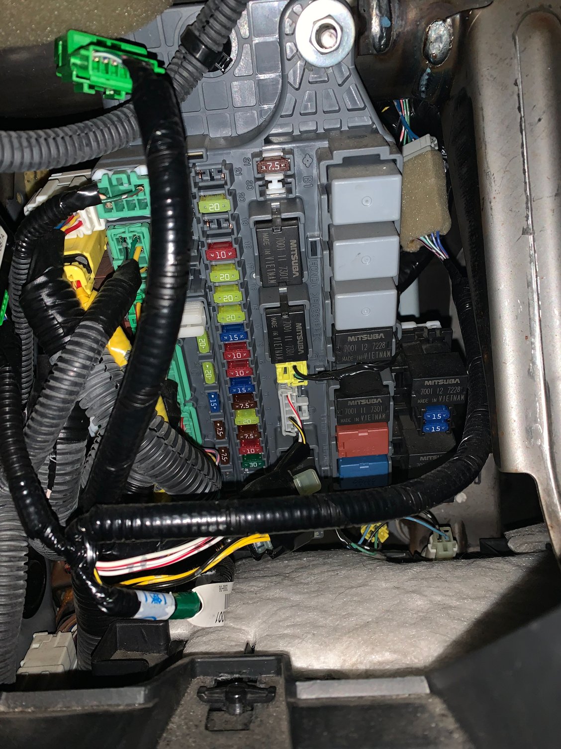

We've had the lock shaft on the driver side door rebuilt a couple times now and once again we can't use the key to get in. I'm tired of having to unlock from the passenger side and reach across, and I don't really want to pay to have a whole new lock shaft put in and then have to carry around two keys.
So I bought a universal keyless entry system. I understand the wiring on the unit, and what wires they need to tap into. What I can't figure out is where those wires are!
Does anyone know which, if any, of these wiring groups control the door locks? The colors don't align with any wiring diagrams I've seen. I'm not seeing any others located under the dash, like in other instructions.
Thanks for any knowledge you can share!

Oh, it's a 2008 base model Fit!

https://www.fitfreak.net/forums/1st-...ess-entry.html
The instructions use to be posted on college hills honda in a PDF. I noticed the PDF is now removed. It use to be posted here: http://www.collegehillshonda.com/ins...it/keyless.pdf
Hope those links put you in the right direction. When I did mine, I used the college hills honda install guide.
http://www.commandocaralarms.com/wiring/2007-2008/Honda/Fit/962.html Wiring diagaram.
