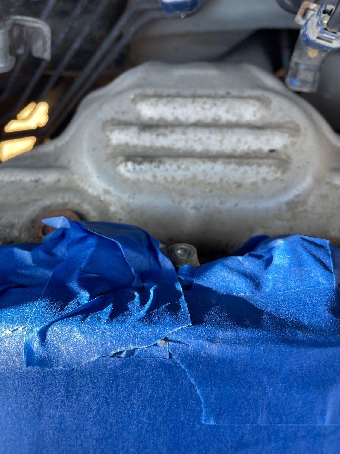

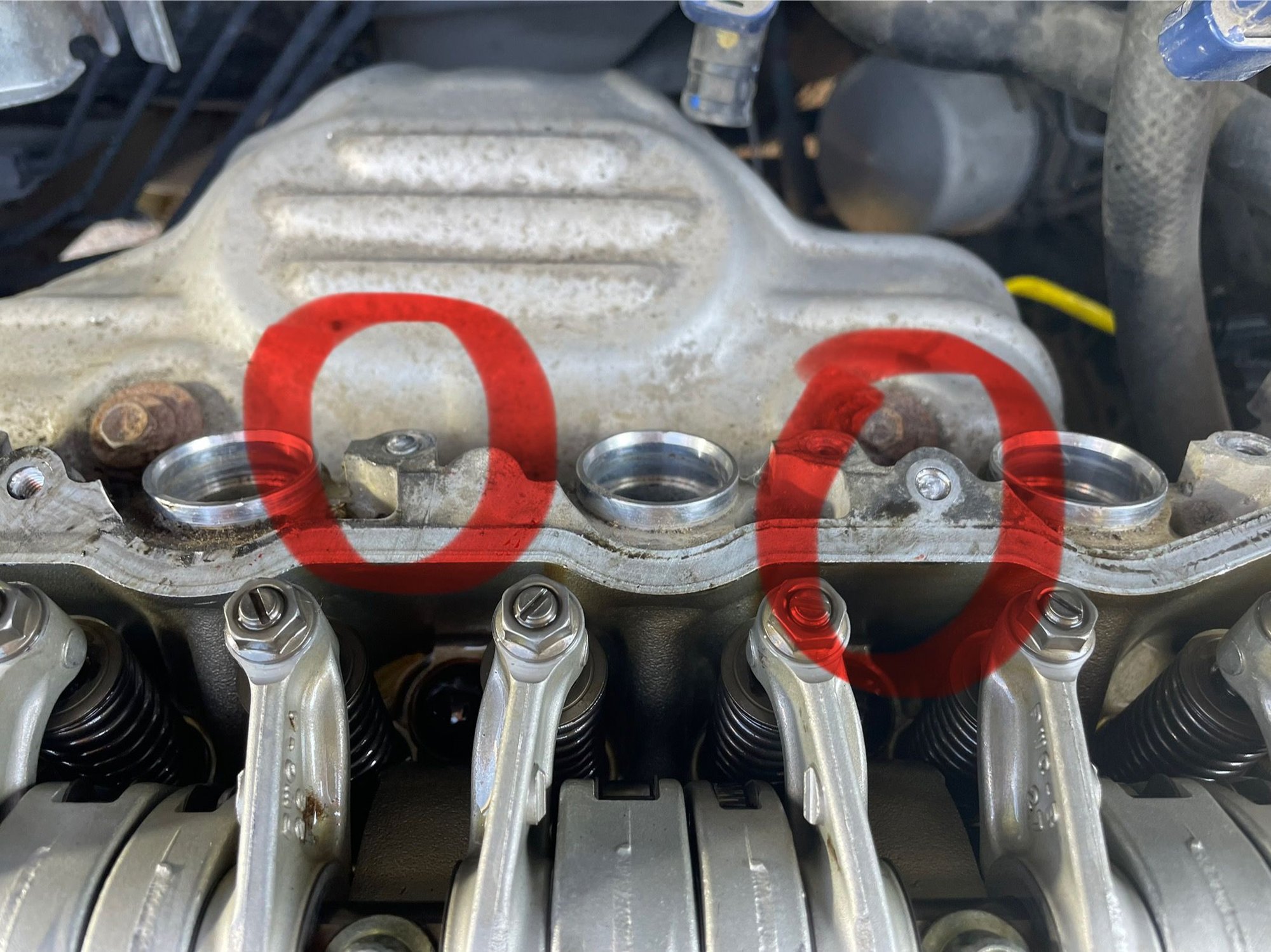

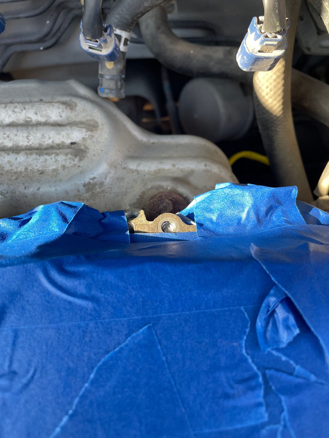

Either way when I was getting off the coil/ I sheered off one of the bolts. I’m not surprised by this because of the history of salt water. However I became more panicked when one of the valve cover bolts sheered off shortly after.
I was hoping to get some advice on what would be the best way to handle these. I have nearly 0 experience with bolt extracting and haven’t been too successful in the past when trying.
I do have an extractor kit but am still worried about using it. I also have a cheap harbor freight flux welder. But am still nervous about the process. I currently have everything taped off to prevent any debris from getting in while the car sits.
I have attached photos for reference.

I guess I would start by soaking them in thread penetrator. Then grab that extractor kit. I've had luck drilling a pilot hole, getting the extractor + a tap handle, and slowly backing the bolt out. You really want the tool to get a good "bite."
