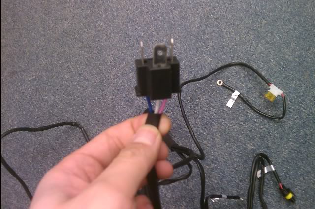

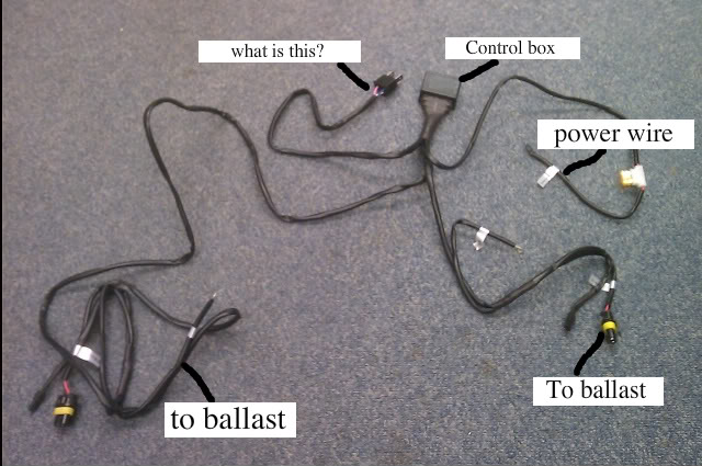

not sure if this is the best place to ask this question, but i didn't want to start another thread. I also know that this is the DIY for xenith xenons but maybe someone could help me anyways.
I just got my HID projector kit. I plan on doing my own retrofit. The actual headlight retrofitting isn't what scares me, its the wiring. I took a look at the wiring harness and from reading this tutorial, I still don't know where one plug goes.
(it may be a super stupid question that I will figure out once i start the process but I like to know and research things ahead of time so I don't go into things blind)
I have all the other ones labelled, but can anyone tell me where the 3 prong plug goes?
Looks like this up close:
The kit that I got is a bi-xenon projector with angel eyes around the projector if it makes a difference.
thanks in advance guys!

Didn't your kit come with a wiring diagram?
What type of projector are you using? The bi-zenon uses a relay and an actuator to flip the cut-off shield out of the way to engage the high beam setting. Do you have all these pieces? It requires that you have all these peices that match and work together properly and don't overload the factory wiring. Are you wiring this directly to the battery? You should. The wiring for the Fit is designed for a halogen bulb, and a bi-zenon set-up pulls more amperage than the stock system. You MIGHT not have any issues, but why risk it.

Plug it in to ur head light harness
