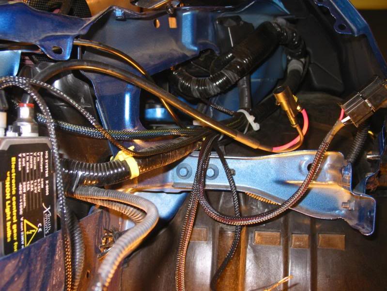

ok this may be a dumb qestion, but in the DIY i dont think there is any mention as to where the 3 prong plug is to be plugged into? then in this image:
on the right side of the image there it is..its plugged into something, but what?
Im having problems finding where to plug this in..any help would be great! i need to get this done before the afternoon hits.
Thanks in advance
Old Feb 20, 2009 | 10:48 AM
  #137
pwnstar's Avatar
Posts: 873
From: uniontown PA
Thanks in advance
the plug, plugs into the passanger side wireing harness for the headlights (is that what you ment?)

Posts: 5,405
if you are installing bi-xenon the 3 prong plug into the OEM 3 prong on the driver side only....
