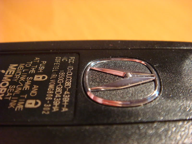

Can somebody post a pic of the underside of the key? Maybe a badge transplant?
+1 on that! i asked a bunch of posts back but no one answered me =(
that is the main reason i dont want to do this mod. i dont want my key to say acura when i really drive a honda. i dunno
Won't work as the Acura emblem is a different shape to the Honda emblem:

From: Af-BAN-istan
do you think a dremel and painting the key would do the trick?

From: Vancouver, BC
Not sure, but you'd probably need more than paint as the emblem is recessed, so you'd need some sort of filler to go around the 'H' emblem..

Found this ebay auction for the key at $47 shipped. The dealers around me are charging $2-$10 to cut...
eBay Motors: 2007 Acura RDX "Switchblade" Main Key OEM (item 310024599464 end time Apr-18-08 15:36:45 PDT)
I was also able to pry the H off my key, so it should go on the new key with no problem.
The RDX key will NOT work with the Fit as the remote transmitter works on a different frequency.
