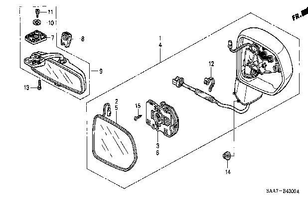

Old Apr 3, 2008 | 02:30 PM
isitafox's Avatar
Posts: 173
From: Derbyshire, UK
Here's the pic from the epc
Not sure what bits you need so I'll give you the exact description given for stuff!
1. 76200-SAA-E41ZG Mirror assembly r/h heated storm silver
2. 76203-SAA-E41 Mirror sub assembly r/h heated
3. 76210-SAA-J11 Actuator sub assembly r/h
4. 76250-SAA-E41ZG Mirror assembly l/h heated storm silver
5. 76253-SAA-G41 Mirror sub assembly l/h heated
6. 76260-SAA-J11 Actuator sub assembly l/h
12. 91540-SV4-003 Clip
14. 94071-06080 Nut-washer 6mm
15. 90145-SCK-J01 Screw tapping 4x18
The switch assembly with the mirror control is 35190-SAA-G01ZA
If ya need anymore let me know!!
