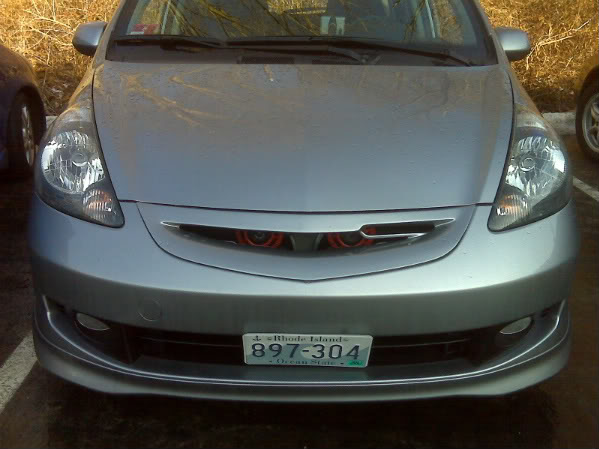

  #68
SHG_Mike's Avatar
Posts: 646
From: Rhode Island
Originally Posted by redrumm
which ones did you get?

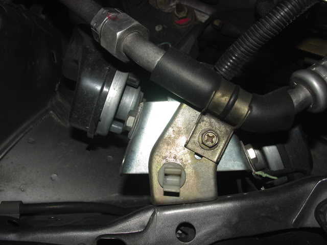

I've used a couple of horns so far:
Stebel TM80 Magnums and Bosch Windtones.
The Stebels were great. Not too loud, but they had a full tone. Unfortunately the stock horn mounting points (behind the bumper) are too low. The Magnums got destroyed when I had no choice but to run through a huge, deep puddle of standing floodwater.
The Bosch Windtones I replaced them with are a little harsher sounding but are otherwise a good replacement. The great thing about Bosch horns is that they come with a custom mounting bracket you can mount anywhere in the car. Learning from the low-mounted Stebels, I had them mounted higher up the car. They now dangle from the brace of the A/C refrigerant piping, where the hood support rod clips to when folded.
By the way, Stebel's website has sample sound clips of just about every horn they make.
