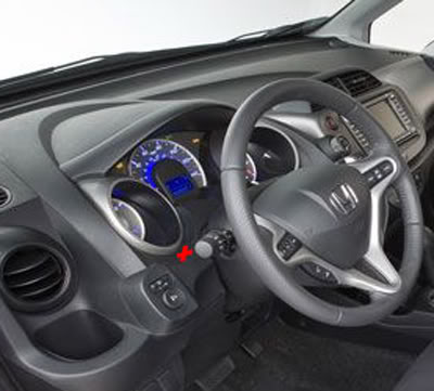

I’ve got aesthetic damage on my 2010 Honda Fit (see image below – red x indicates damage location). Its on the lip of the dash, just under the left portion of the instrument panel. I’m looking to fix it. This is the only thing I could find (figure 1 in the diagram):

Do I really need to get that WHOLE piece? Or is there something else that I’m missing?
Also, depending on the above answer, are there any instructions on how to remove the part in question and replace it? I’m unfamiliar with handling interior mods, and really don’t want to wing it.

It is one large piece and has to be replaced in whole

The gap C is the edge right down where your damage is. Just gently pry all the way around while pulling gently and it will come off.
THere are a lot of clips D and E so if you mess one or two up you chould still be OK.
What did you do to it to damage it?

Thanks! So, there are no screws or anything I need to worry about? Its all just prying along the edges? Any chance you could point me to where that pdf could be found?
Yeah...its a nasty cigarette burn. I was driving home after playing at a bar last friday night and dropped it. Thought it landed on my rubber floor mat, so I did the spastic foot stomp to put it out but didn't fret about it, when if truth, it landed on that lip, and the steering wheel shielded it from view. I intended to double check when I got home (10 minute drive), but I forgot. So stupid. I went out to the car the next morning and saw it. I've had that car for almost a year, and that's the first damage it's gotten. My ass hurts from kicking myself all weekend. Could be worse, but its still a pain.

Nope no screws. As you have it messed up go ahead and try it. Just take your time. When prying all of a sudden they let go. I have had many of the other panels off and no problems.
