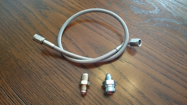

Got my parts in! Will be tackling this DIY on the weekend. Can't wait to feel the difference. Thank you for this write-up!
Attached Thumbnails DIY: GD3 clutch hard line (to remove the in-line CDV)-dsc_0021-201.jpg
