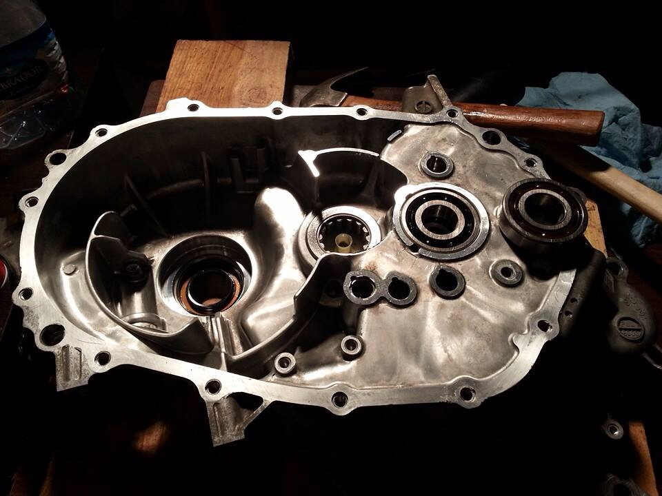

No, the mainshaft bearing is inside the actual transmission not in the clutch case. Here is a view of the bottom half of the GD3 transmission case. You can see the mainshaft (aka input shaft) bearing as well as the bum bearing I replaced right besides it. The mainshaft fits right in there. The other end of the mainshaft actually sticks out slightly of the transmission case and it's what you have to plug into the clutch plate when you install the transmission.
Do a google search for Honda mainshaft bearing and you'll see that it's a bearing that is known to fail in Hondas. It sucks because it's basically always spinning, except when you press the clutch pedal. Cost me about 30$ In OEM parts to replace but I had to rent a bearing puller for 10$ to extract the old bearing.
was that preventative maintenance or did it start to leek?
Old Oct 24, 2014 | 11:50 AM
MTLian's Avatar
Joined: Sep 2012
Posts: 1,374
I actually had a bad rattle as demonstrated in this video. It was clearly audible inside the cabin. Some people drive on the bad bearing for 1 or 2 years and deal with the noise. The only problem is that if the bearing were to fail and break, it will send broken pieces all in your transmission and could probably wreck it.
Since my mechanic was pulling the tranny anyway, he did a clutch job. I bought the exedy OEM kit which looked really nice, but I find it a bit soft. I hope it'll stiffen up once I get past 1k kilometers on it (600 miles). The stage 1 is about 350+ $ compares to the exedy OEM that cost me about 150$. I heard that the unboosted/turboed Fit engine was too weak to justify a racing clutch so I just went for a stock like replacement. However, I find my car slightly lost some zip.
