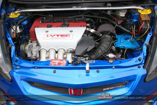

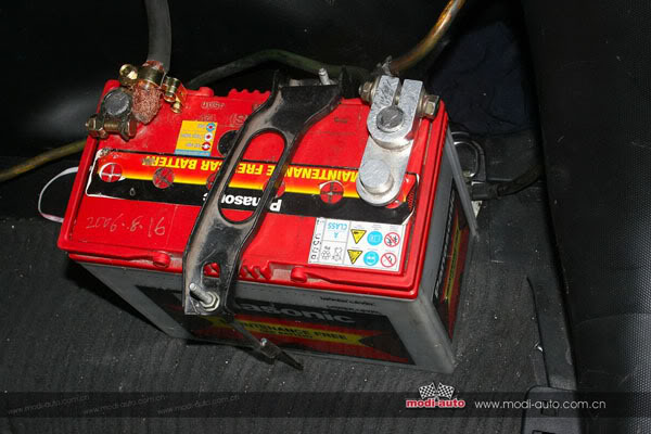

Ok guys, I know a few of you have done this due to a number of reasons. the fit has a bad balance from the beginning, it's head heavy body light. also it's cramped engine compartment makes it difficult for many modifications..
if you have done the relocation plz chime in.
here are pictures of 2 k20a Fits i found on the internet
they both have the battery relocated to the trunk area.
enjoy

You can re-locate the battery to wherever you want. Depends where you want to lose space. If sing a wet cell battery you need a sealed battery box and you must vent the box to outside the car. an AGM battery (like an optima, kinetik etc.) doesn't need to be vented outside the car. If you don't use your folding seats, putting the battery under the 40 split section would work well. You'll need to use at last 4 guage wiring for this. Real 4 guage wire, not the bidget 4 guage amp kits that are actually 6 guage with thicker insulation layer. 2 guage is always reccomended.
