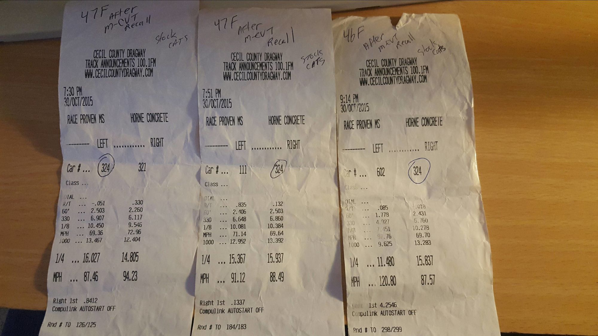

I honestly can't remember exactly but it was so ridiculously cheap, I couldn't pass it up. Somewhere between $100-$200 a cam or something absurd. I purchased brand new cams though and sent them out to Deltacam to be reground, so my down time would be minimal.
Also, I'd have to apologize on the 1/4 mile information. Going through my timeslips, I can not say the installation of the cams brought my 1/4 mile times down from 15.6 to 16.1.
In between the cam install and my old 15.6 1/4 mile time, I had my CVT ECU reflashed before installing the cams. I tested the car after the CVT reflash and my 1/4 mile times where between 15.8-16.0. I lost lowend, midrange as well as top end. Temps were not a factor as it was cool. ( CVT Reflash) I just forgot to state this but never did, figuring most people couldn't care less either way.
